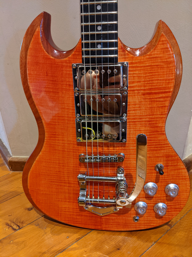

    Similar story for me. I was going for something like that colour and ended up with this disappointment:

    Not red, but as disappointments go, that's still pretty cool looking. Love the grain on it! Mine have tended to go pink on me...

    Did it fade to this colour or changed after the clear coat?

    No, it actually darkened a little with the clears as I used Tru Oil. I was hoping it would darken a lot more than it did. My issue was that I went with the Dingotone stains which I'd never used before. Plus, it's a mahogany body and the colour just didn't work on it. The original kit I ordered was not mahogany but they'd actually sold the last one of what I wanted and it wasn't updated on the site. So, I got "upgraded" to this kit as the wait on the one what I wanted was unknown, but I stuck with the original stains I'd ordered in the blind hope it was going to work anyway.
    To be honest, I don't think the colour would have worked as I wanted on any wood. The other issue I had with going with the Dingotone was the colour choice was limited and it wasn't overly obvious from the small amount of pictures provided what the colour was going to look like. Then I had the dreaded issue that others have reported of it taking absolutely forever to dry properly - I'm talking weeks. By the time I realised how it was going to look, I'd invested too much time and money and going back was not really an option - I don't think there's a very good success rate in stripping back those veneers as they are so thin. Since it wasn't really the kit I was after in the first place, I just didn't care enough to put any more time or money into it so I just kept going. Not fussed on the Bigsby or the three humbuckers. It still gets played, just doesn't get displayed.
    So, long story short, the red on Omuine's build looks perfect and I'm jealous.

    On that we can agree. I was going after that beautiful old Gibson burgundy/red clear finish that SG and ES guitars sometimes have (as well as my old Epi Newport, my first bass). Failing that, I tried red...like the old Gibson solid reds. Failing that I tried again with two different stains, two different clears and a fair amount of sanding back and re-doing. I got close this time, but don't think I could replicate it.
    I can say that your failed attempt definitely looks better than any of my failed attempts ;-) ...but I get that it's not the juicy red that Omuine has!

    I just mix 1/4 jar of white and a few drops of walnut stain till you get the right shade and use vinyl fine-line tape to keep the edge sharp, and use a touch-up gun so you don't put it on too thick, you can pick up touch up gun pretty cheap on eBay, Max didn't check the kit before he started it, im not going to do anything on his kits, he's done a beautiful looking strat I'm a bit impressed. He's moved on to doing a red/black burst on the ES its coming out not to bad

    I'm not sure which red he used it looks like he has used Rit dye either racing red or scarlet ill let him know you wanted to know the red it looks like racing red as scarlet is a bit more on the cherry red side we didn't get back from holidays till the weekend so haven't talked to him about what he's going with, what you got the orange looks pretty nice but if it was me doing an SG ID use scarlet its more like what Gibson use but that orange look pretty good to me
