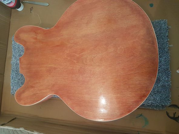

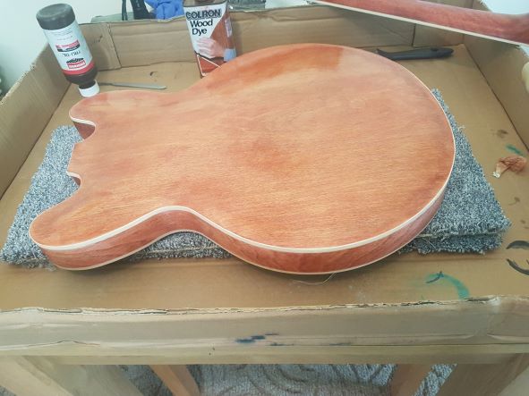

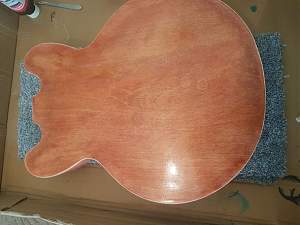

    Changed my mind. Used one coat of Colron red mahogany on the sides back, and neck, so far three coats of Tru-oil, 24 hours between coats. I shall do the top in Champagne gold, and several clear coats on top.Click image for larger version.

  6. #16
    Apr 2017
    237
    Now that looks really good.
    Look forward to seeing the gold top.
  7. #17
    1,839
    Yep, +1 for looking good.

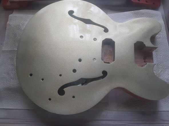

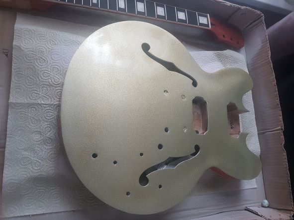

    Sanded again, laid a white basecoat, sprayed rattle can champagne gold, then first coat of clear enfused with gold flake, and finally 10 coats of clear lacquer. Must wait for it to cure before polishing, so the effect is not yet best shown in the pics. Champagne gold, with sparkly gold flecks, I am finally satisfied.Click image for larger version.

  9. #19
    Apr 2017
    237
    Looking great!
  10. #20
    Lovely... Looks great. All the spray paint was done from Rattle can?
