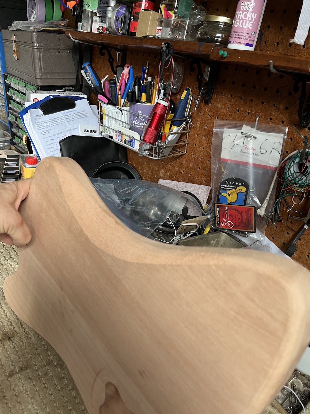

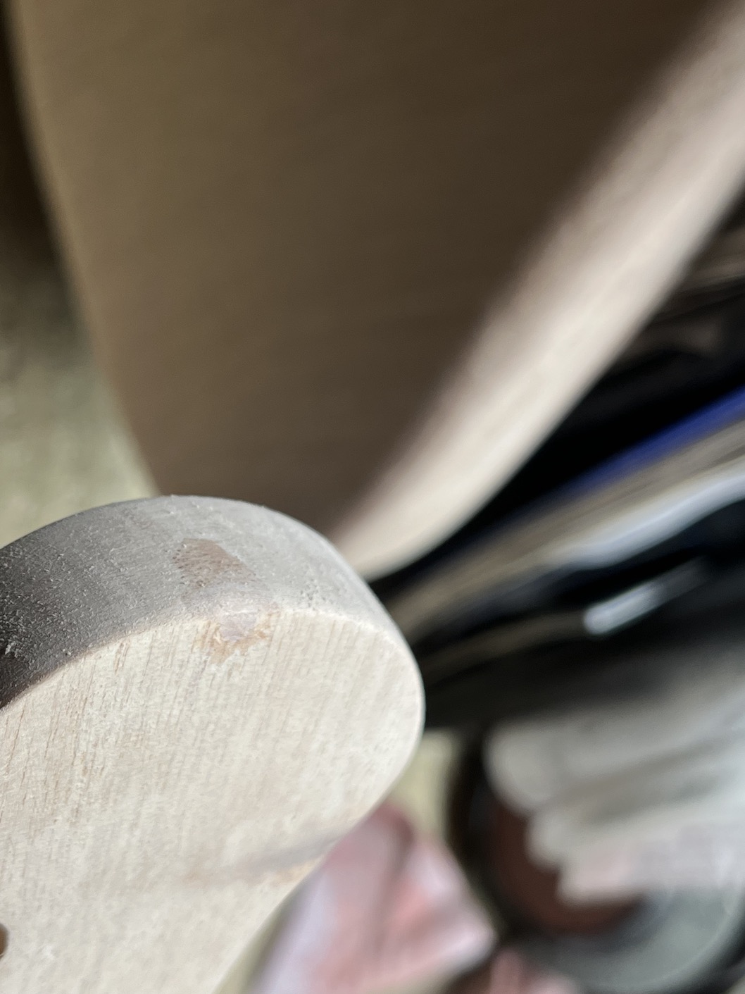

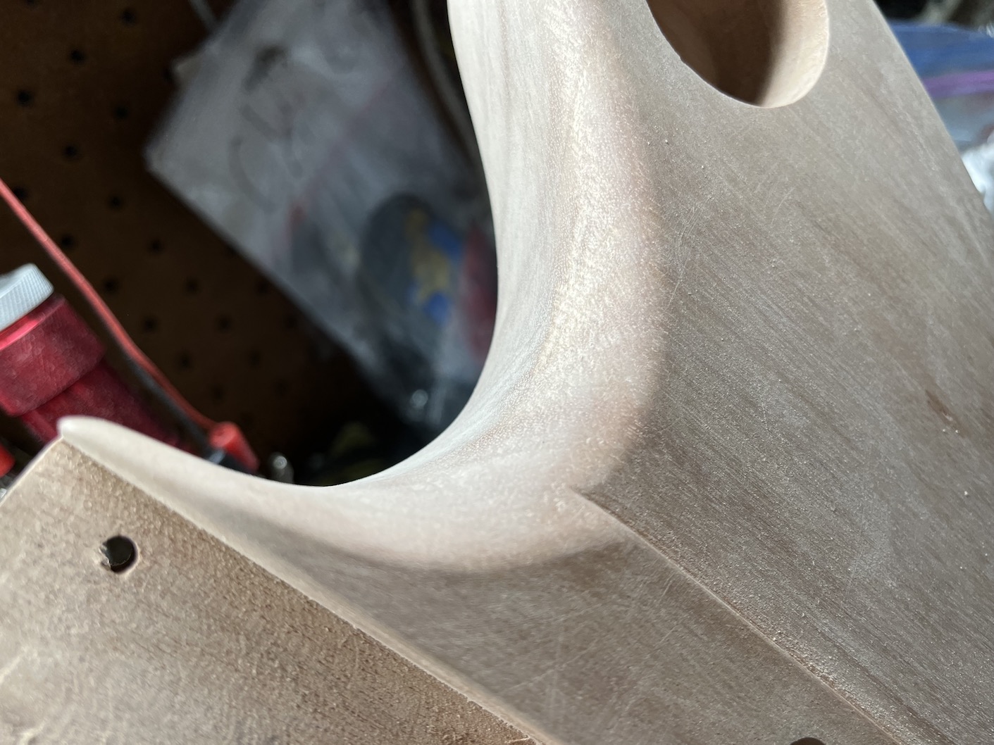

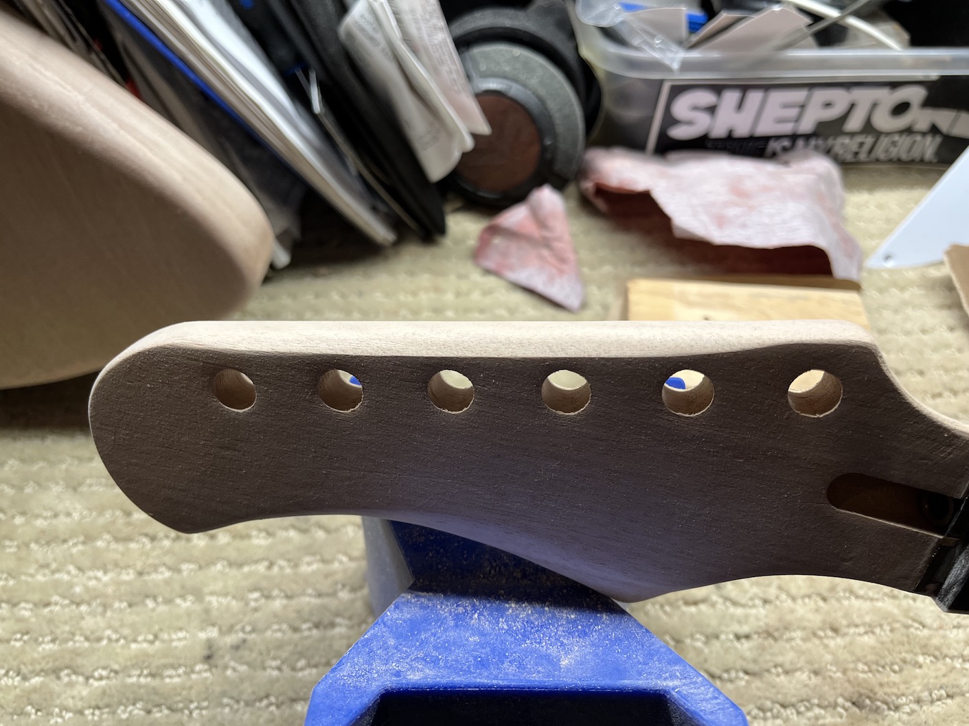

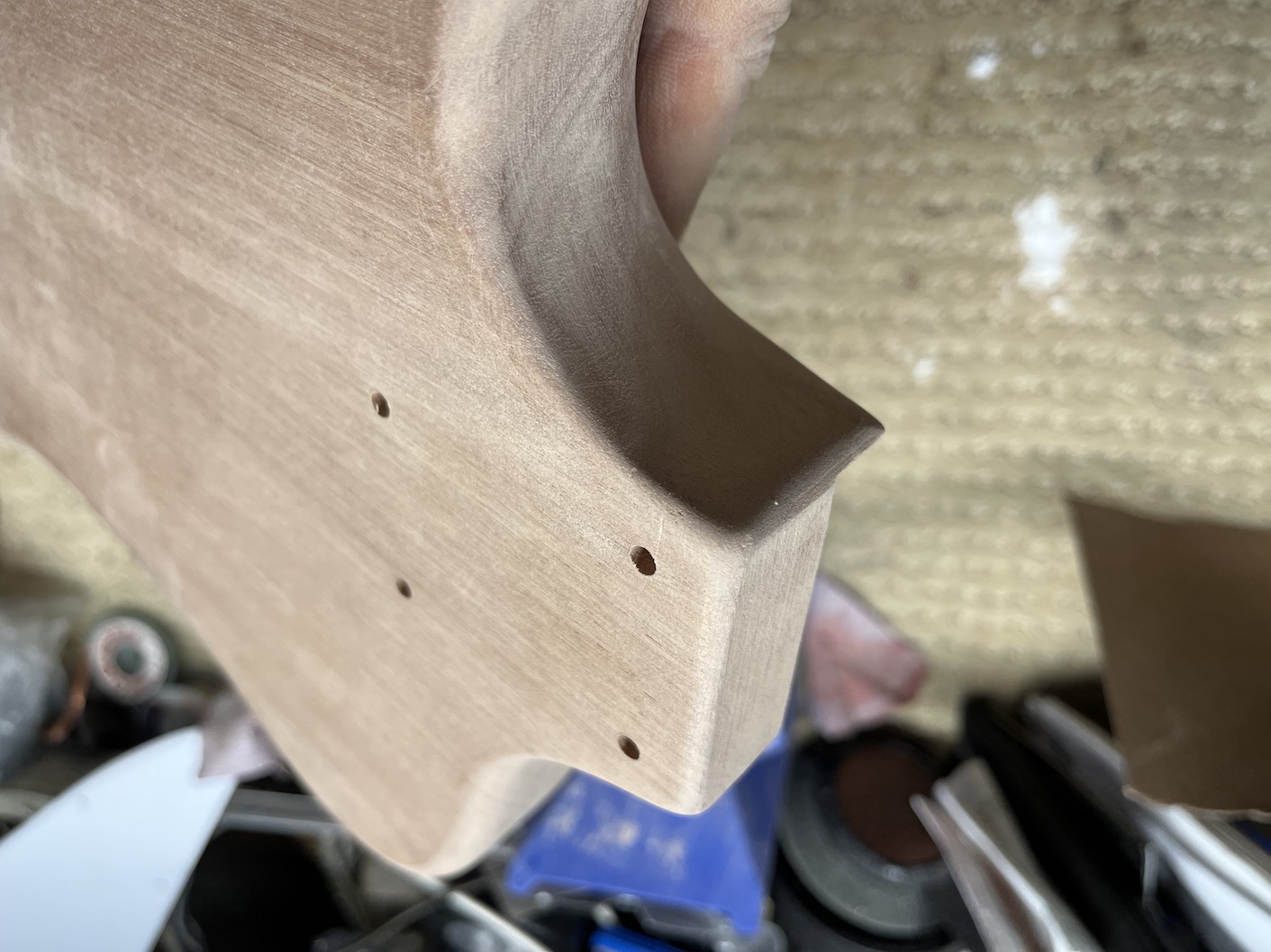

    Sanding day. In the process, took some edge off the neck pocket heel, and lower cutaway. General refinements. Not a ton of meat on the headstock, which is fine, the guitar seems better balanced in that respect than my modded Epiphone couterpart. I tried to add some texture to the head, and debating on whether or not to paint the back of the neck. I want to do the outer trim of the head in black... tie it in with the knobs and rings - we'll see. The satin clear coat has a vintage amber to it, so I might just want to see the wood. Still going for a vintage white on the body. Did a damp wipedown, possibly more refining before paint. Basically off for the holidays now, so the project is in full go mode.
    Sanding is a chore at best, but I was quite rewarded with getting familiar with the refinements I'd created - letting the fingers and nerve endings let me know when the sanding was done. When I cut the headstock I left a chip (no scroll saw), so I filled it with my krazy glue and baking soda trick. I decided I wasn't able to recover enough wood dust to use that. It dried fast and hard, and was able to sand it out.
    Next I'll probably do a more serious test fit, work on the neck bolts and neck position, and prep for paint.

    Quote Originally Posted by stewartm View Post
    Okay... the ball is rolling. Project codename: Fire-Emu. ;-)
    Did some rough shaping on the backside of the body
    Attachment 43838
    When I have done belly cut and forearm shaping I have used a fine flap disk in a 100mm angry grinder, obviously have to be careful not to let it bite but I found it to be easier to control the shape and depth of the work than carving, also gave me a relatively smooth and clean starting point for manual sanding

    Sooke, B.C. Canada
    32
    For the record, great recommendation. I used a rasp for most of the contour. I think I'm done the hack job, and without using the 'big guns' there's less likelyhood I'll slip up in a big way. I decided to leave it quite subtle and work on my own gut.
