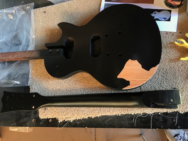

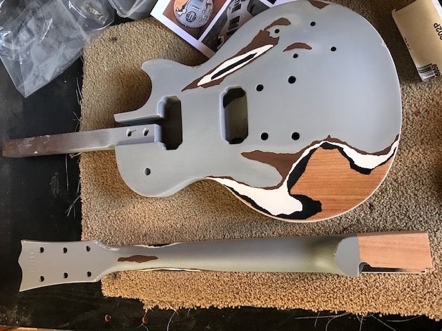

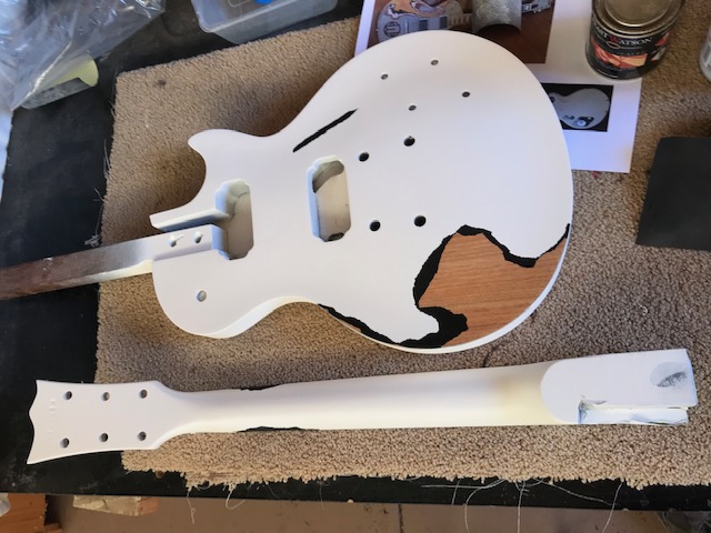

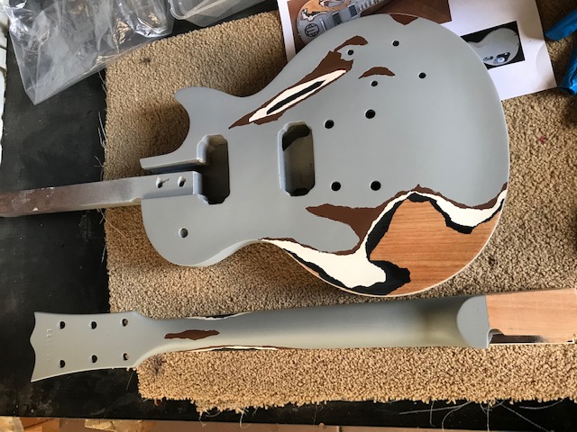

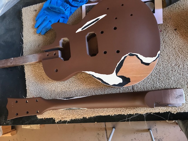

    I was not sure about how to relic the paint job of this guitar, either:
    1. spray the 4 layers of paint and then sand back to reveal the different layers, or
    2. mask where I do not want the paint and then paint, re-mask for the next layer etc.
    I decided with the second method, for the main parts, as I thought that would produce a rougher edge between the paint layers rather than a smoother edge. And a bit of method 1 for the smaller parts.
    I have sprayed 4 layers of MTN-94 paint from rattle cans - black, white, coffee brown, and pearl grey.

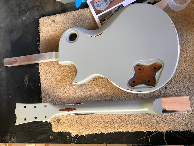

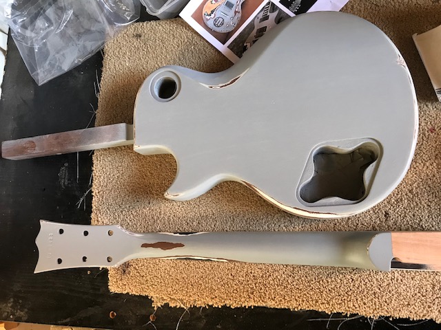

  6. #15
    2,000
    FWIW, a nice thing about a reliced guitar is that there was no stress about getting a perfect finish, and no stress about handling the guitar to prevent any dings and scratches.
    Final relic job.

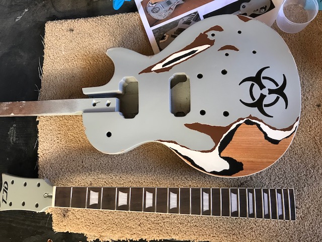

    I added a Cricut cut logo to the headstock and a sticker to the body. (It must have been a bad omen as I have since contracted Covid
    I have also added a few layers of clear over the top. Sanded smooth only upto 1200 g. I'm not going to do any polishing.
