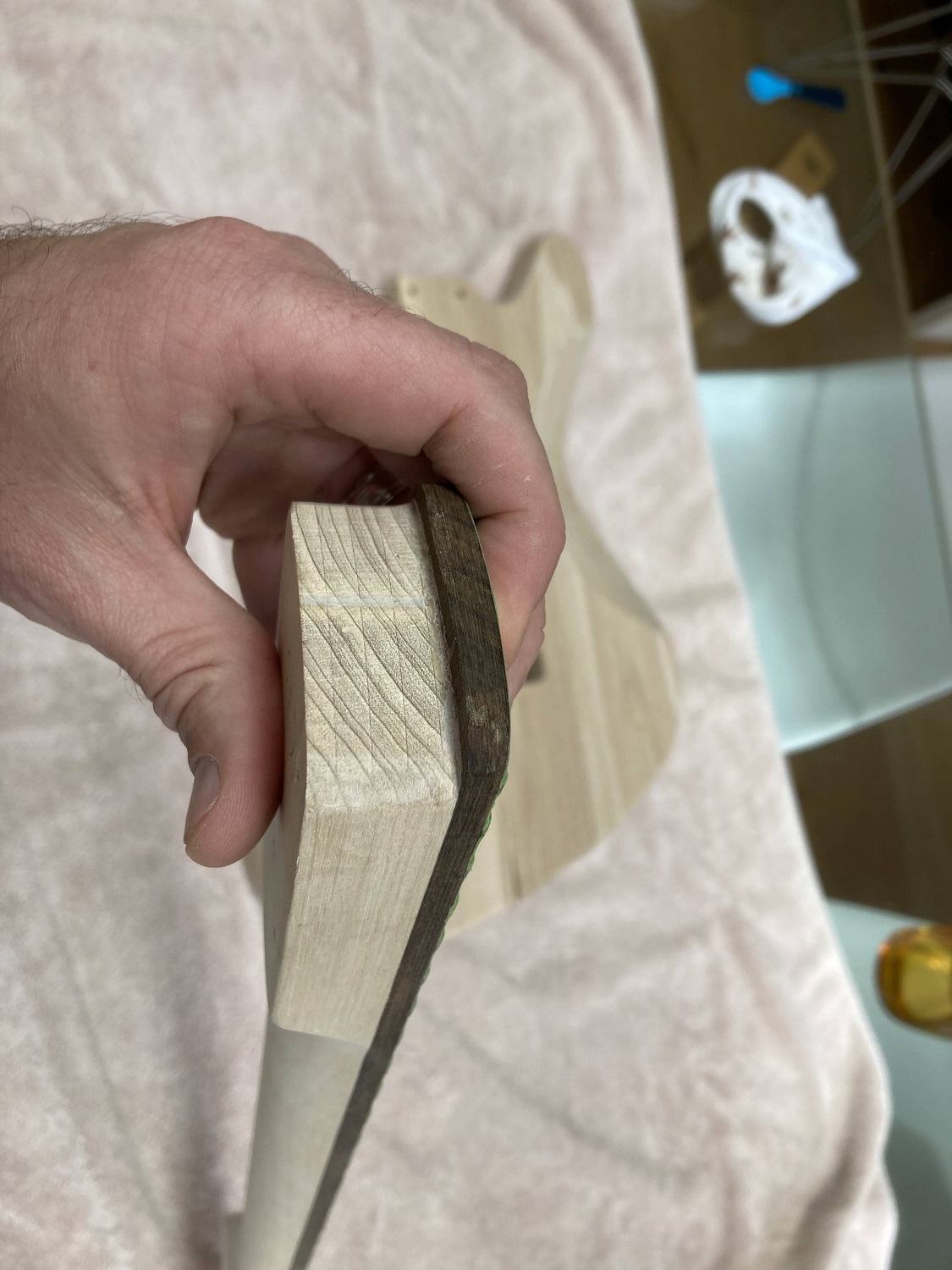

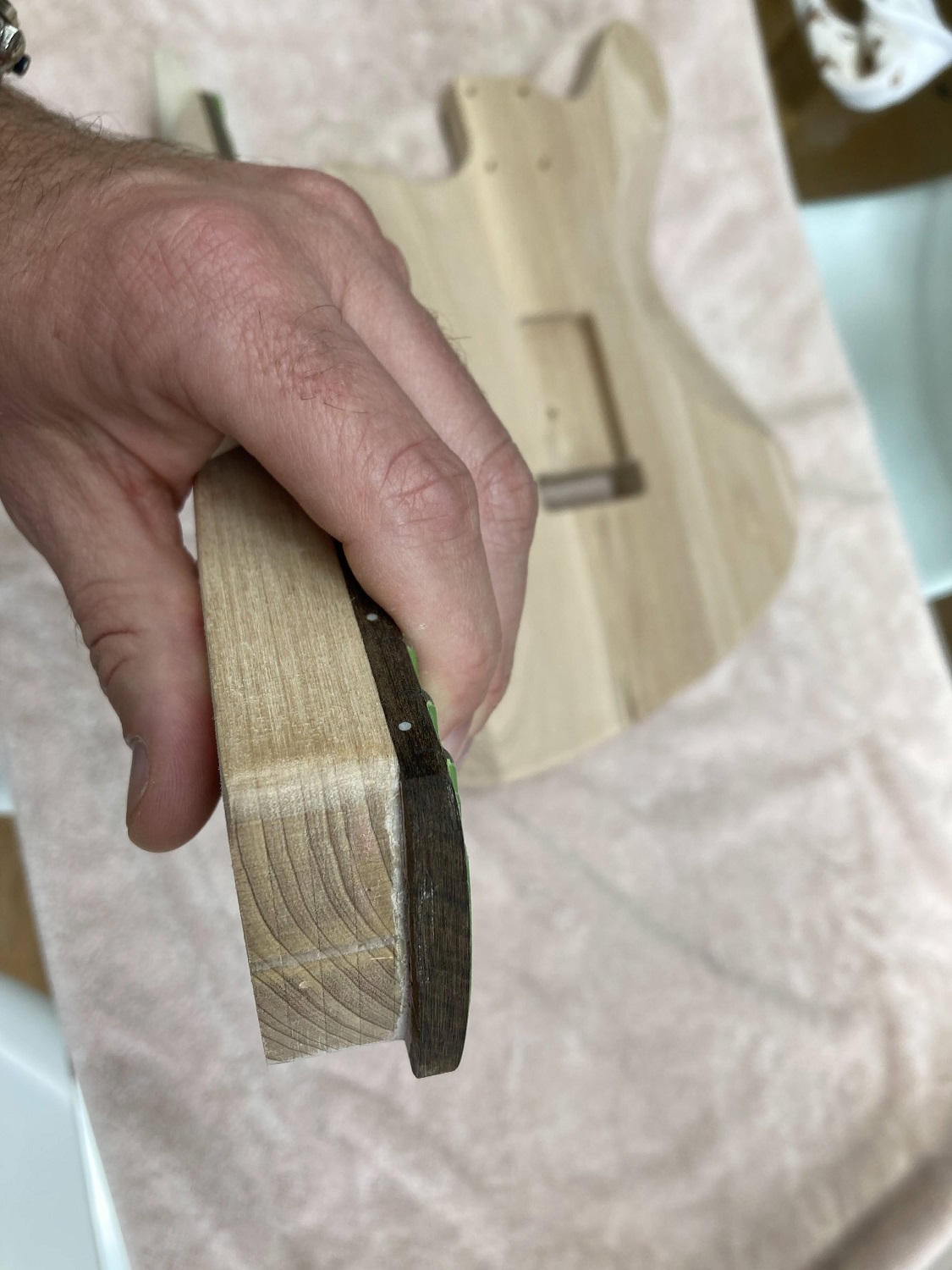

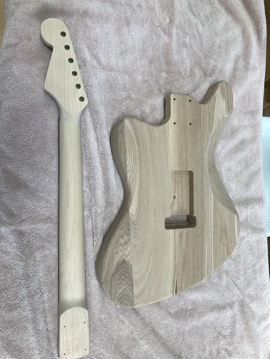

    So just a couple of photos for an update, more for myself than anything else.
    The neck corners were rounded slightly, leaving the flat surfaces alone as far as possible. I'd swear the radius hadn't been changed, but obviously enough to get the neck pretty much flush with the neck pocket.

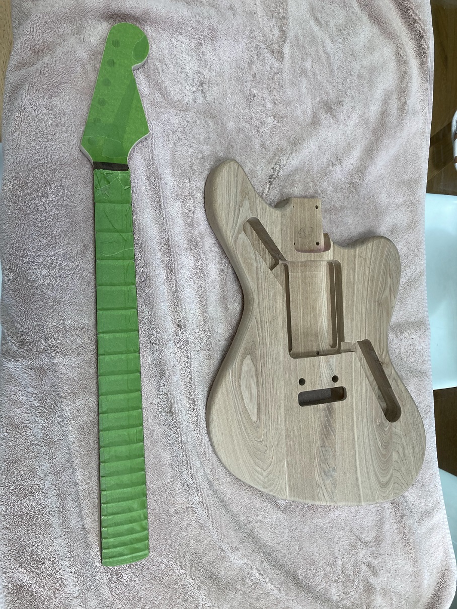

    The body and neck have been sanded to 240 grit.
    The body is ready (I think) for grain filling.
    The neck has been masked and ready for the poly to go on the exposed areas. Once I have built that up a bit, not really sure how many coats to apply.. i will let it cure for a few weeks before masking the back and painting the head stock.

    I don't know, the more I look at it, the more I like the grain pattern, but the boss wants it to look like Kurt's guitar.. So thats what it ill end up as.. I hope..

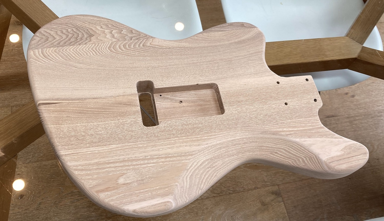

    Again more for my records, the body has had grain filler applied, then sanded back to 240grit - Felt amazing and smooth, but when I wsa cleaning the dust off I found the front face had a fair bit of raised grain - So will have a second attempt at filling the front.
    The back and sides were great though, so they will only have one grain fill.
