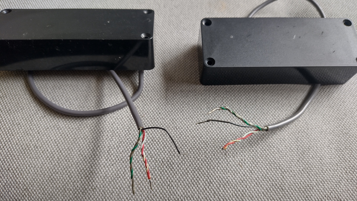

    Another question I have is about the wires coming out of the pick up. One black, a pair twisted together white and red, and another pair twisted together white and green. What are these wires? Which one is ground and which one is hot?

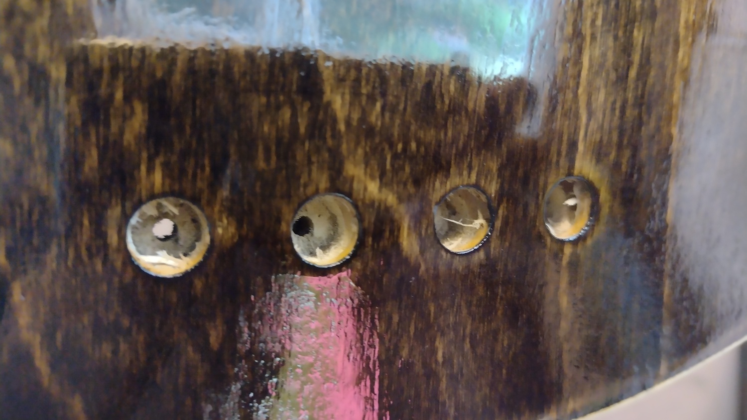

    On a different note: for this kit the bridge is made of timber and I was a bit worried about not having a ground connection going from the electronics to the bridge, and therefore to the strings.
    After a closer inspection, I noticed there's a predrilled hole between the electronics cavity and the ferrules for the string through body. This is good news, it looks like I will have to feed a wire through each ferrule predrilled hole, making sure that it touches the ferrules. Still not 100% sure on how make sure that this wire will touch each ferrule but will come up with something. At this point I am thinking or soldering a bare wire to the ferrules.
    Will take some better photos when I'll get there with the build.
    I've check with a multimeter and the ferrules are conductive.

    Hi FaustoB,
    I can help with the pickup wires.
    The black is hot,
    the white and red (soldered together) wires join the 2 coils in the humbuckers - they do not go anywhere (unless you are coil splitting) just put some insulation tape around the ends so they cannot touch any conductors in the control cavity.
    The green (with bare shielding wire) are the ground.
