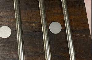

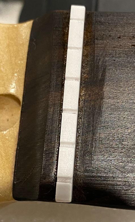

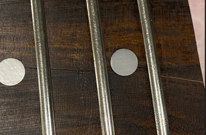

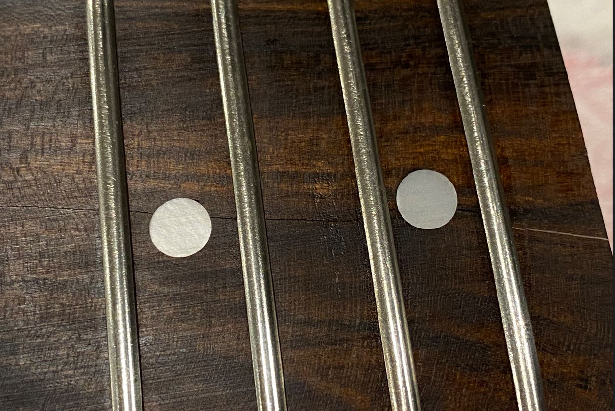

    The neck has been sitting for a bit over a week curing so I gave it an oil. On close inspection the rosewood has a couple of issues. I will change the nut anyway so I hope a light sand will sort the scratches out there. The crack in the fretboard at the other end I am not sure about. Is there anything I should do to stop it getting worse? Honestly I will never get there the way I play but it is a good lesson to have a really good look at the kit when it arrives (or any guitar bits). I did a practice fret level, crown and polish on an old beat up neck I had. It was a great learning experience and gives me more confidence going forwards with this neck (and others I have from 2nd hand guitars that need work).
    I used a cheap fret crowning file. I think in the future I would get a better quality one or use some of the wood and sandpaper designs I have seen online. Also getting a fingernail buffing block was a great. It worked really well at the end stages to polish the frets.
    I am really enjoying the learning experience.
Name:	neck crack 1.JPG
ID:	43418Click image for larger version.
Name:	Neck crack 2.JPG

Name:	Nut scratches.JPG

    Hi Juz,
    with the crack in the neck it may be worth adding a touch of thin CA glue. It should hopefully flow into the gap and stop the split from getting worse, and level the gap. Any excess on the top of the fretboard could be cleaned with a scraper, scalpel or one sided razor blade. Hopefully it will not show with the oil used on the fretboard.

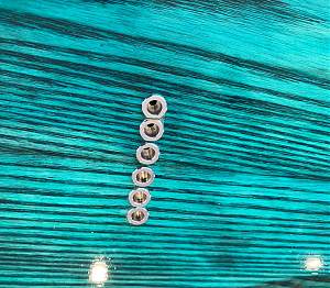

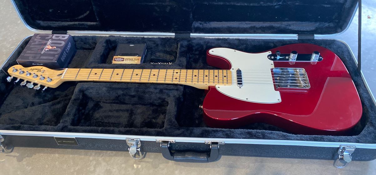

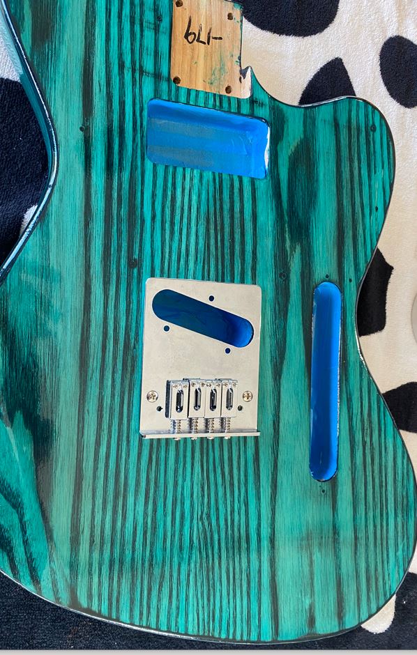

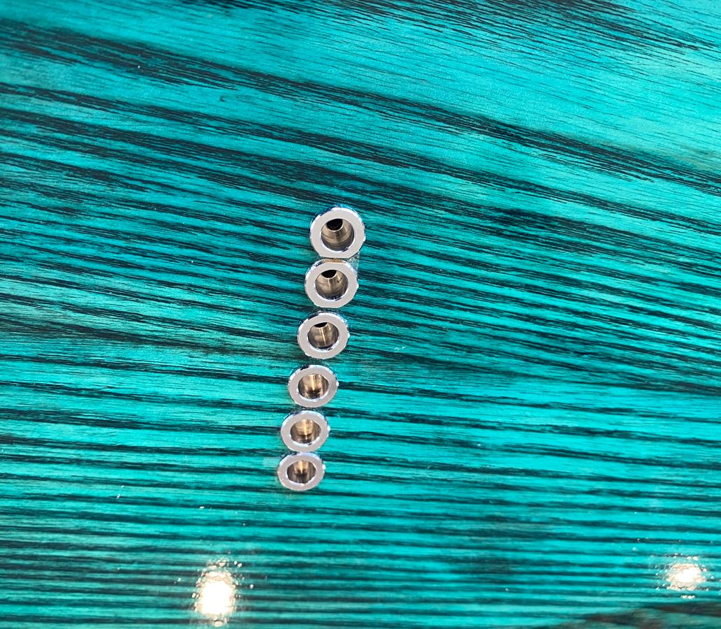

    Finally had a chance to get back to some building. The good news is that some of the delay may have been caused by the Candy Apple Tele that was too good a deal to ignore.
    The bad news is that it is safe to say that if nobody ever mentions the offline drilling through the body or the broken screw fitting the bridge then that will be fine. All good learning experiences. Some patient work with a dremel means working solutions to both problems. Sadly not perfect solutions.
ID:	43488Click image for larger version.
ID:	43489Click image for larger version.

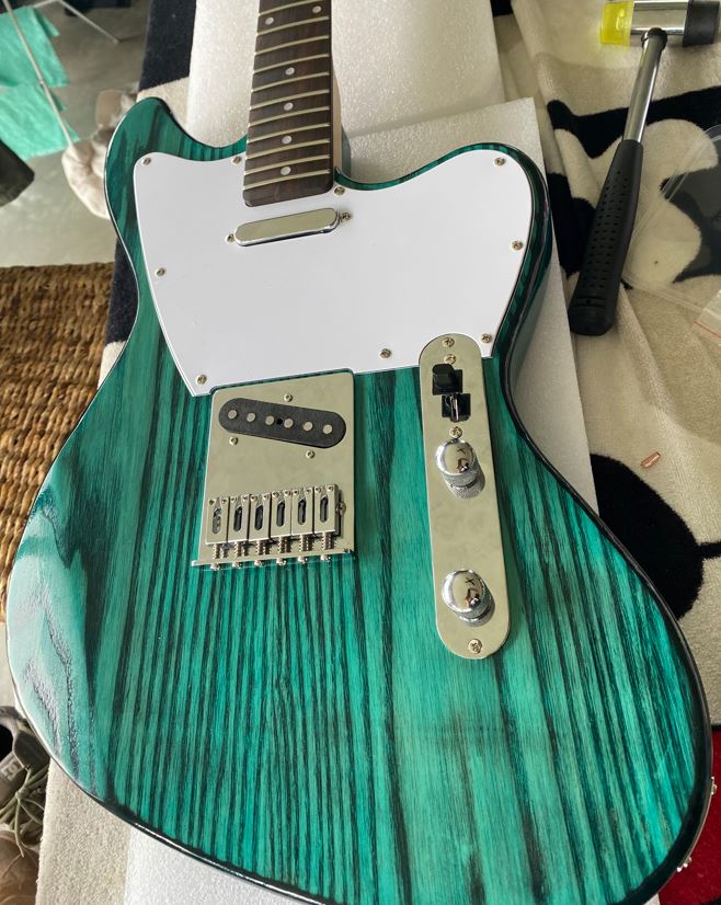

    Since I have sanded the body and neck with P2000. Started to do it wet but had mixed results. Tried again dry and got better results. I don't want to get a flat finish but I am not sure how the end result will look.
    Next step is I got some polishing sponges and buffers that attach to the drill. Will try with some car polish/wax. Have heard different advice on this so will see what happens.
    I have some Carnauba polish that a furniture maker friend is trying to talk me into using. He thinks it will go over the car polish in any case. Will take some pics when I try.

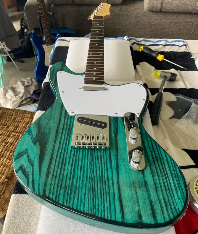

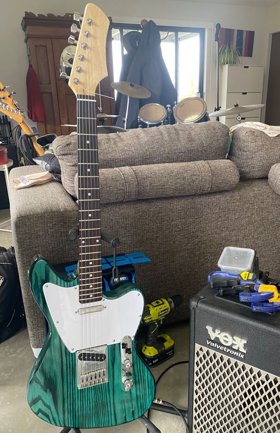

    So I got some time to get back building this week. I managed to get to the playable stage and I could not be happier. So many problems and issues with the build and finishes but I could not get the grin off my face when I got to play it.
    I put the Fender Yosemite Pups that I had in. I had all the gear to change all of the electrics but decided to use the Pit Bull control plate for now and change over in the future. This proved wise as I realise my soldering skills could use a lot of improvement. Doing the pups and jack was plenty for now. I have just done a rough fit and set up with the plastic nut loose as I am waiting on a set of nut files from Japan. I can't remember the forum member that suggested Plaza Japan for files but thankyou I took the advice. I then need to fit string trees and strap buttons but it plays great.
    I have a set of tonerider vintage pups but I think after today I an happy with the Yosemite.
Name:	Full Guitar.JPG
ID:	43513Click image for larger version.
Name:	Front close.JPG
ID:	43514Click image for larger version.
Name:	front no strings.JPG
