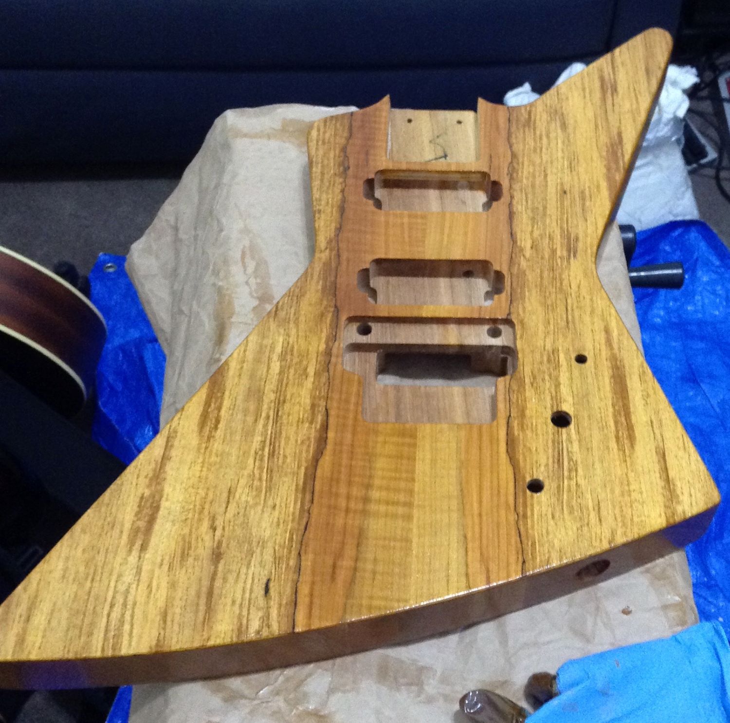

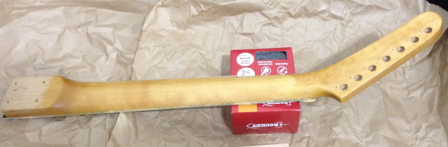

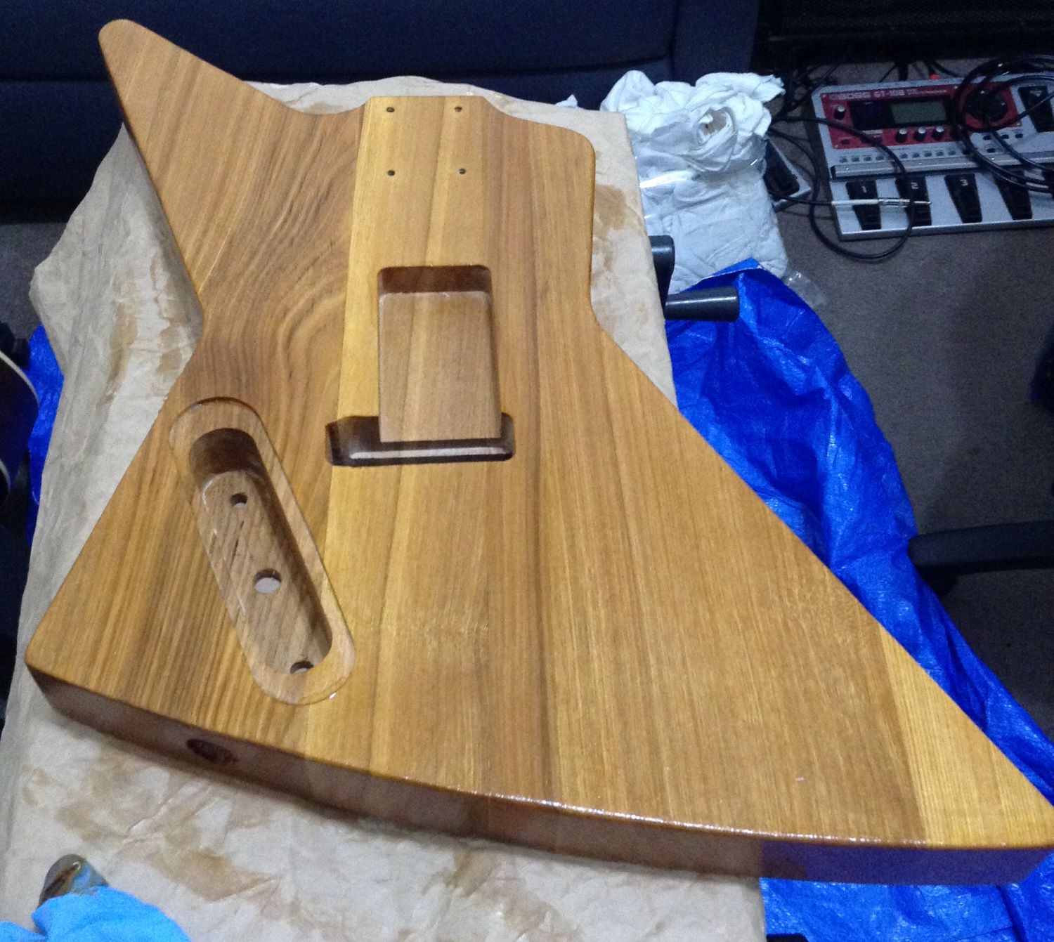

    I started coating it with Shellac (the flakes from Bunnings, which are as orange as the label says). I didn't expect this colour, which are more yellow/orange than in the photos, but here we are! Not complaining much.The back has 9 coats and the front 6. The neck has 5 and it's darker than in this photo. I'm thinking of being brave and try a French polish on the top.

  6. #15
    No reason not to. What are you doing in the trem rout regarding a finish? Doesn’t look like there’s any on there at the moment. It’s best to have something on the wood to seal the surface to stop it being affected by humidity changes.

    I attempted French Polishing and it was going well, then I got too excited and failed horribly halfway through. I forgot that shellac and especially french polish need little amounts of product, and on the second day of polishing, I started dipping the rubber into the jar, thus leaving very annoying marks on the finish.
    Good thing is that shellac is easy to fix with a bit of sanding and alcohol. The imperfections are hard to notice at first and I think I'm comfortable with them. It's looking very shiny and I like it, but I'm not sure if I should buff it with steel wool and add wax - some people talk about it, but I'm not sure I need that. Here's some photos with different levels of shellac'ing
