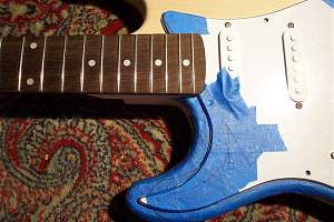

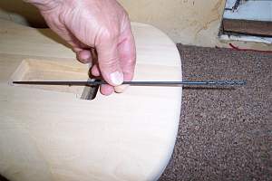

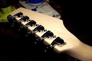

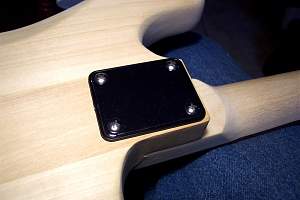

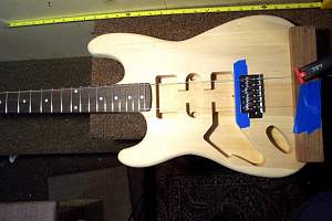

    Ok, finally had a little time to play with this. So I drilled the neck and mounted it, also mounted my tuners and then took a little time to play around with how it's gonna look as far as the bridge and all that. Tomorrow I'll grab a laser thing that I have used in the past for this same thing and establish a centerline and make some legit markings. I'll need to clean up my drill press as it is in my metal shop and is quite dirty/oily. And I will make my best stab at a nice straight accurate line of 6 holes haha. I'm not new at this kinda thing so I'll just be diligent and try to do a nice job of it. Once I have it strung up and "sort of playable" as I have done no fret work or anything, I will adjust the pickguard (scratchplate? hehe) and put it where I like it because I'm going to make a pencil line of the pickguards perimeter so I that when I tear it down for shaping/sanding I will have a visual reference. After that It will be time to have my way with it and finish it in its initial form. (initial form being the hardware and stuff that came with the kit and my woodworking, later you could always replace that stuff or re-frett it to suit). Grabbed a 12 inch drill bit locally for under 8 bucks for the spring claw screws. So here are a few pics. Click image for larger version.

    It really is best to use thin string or cotton on the two E strings to centre the bridge, rather than try and work out a centreline with a laser etc. You definitely know then that the strings run parallel with the sides of the neck. That’s what you want to achieve, so you might as well use the method that tells you that.
    Make sure the saddles are wound almost as far forwards as they’ll go when measuring the scale length, none of this ‘halfway’ business that’s in the guide.
    I found that the spring claw screws Pitbull supply are really not up to the task. It may be that they're copies of Fender screws that are OK for the wood that Fender use, but I didn't feel they really gripped convincingly in the wood that Pitbull use.
    I had a pack of assorted stainless steel wood screws, some with a much bigger diameter and coarser thread. I had to considerably reduce the head diameter with a bench grinder to make them fit in the space available, but they are really solid. Considering the strain that the spring assembly is constantly under, this might be worth looking at.

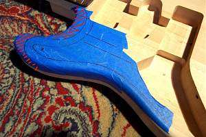

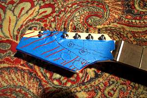

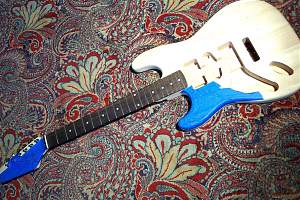

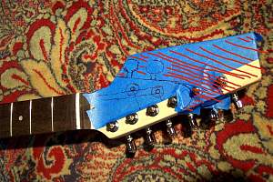

    Ok, took a few hours today to brainstorm a bit. Use up some masking tape (few times) and figure out some things. Most likely if I do the headstock as a 4/2 like that, I am going to just buy some locking tuners in the configuration that I want, (mix of left/right handers and heights), and I am considering maybe just buying a better bridge. As I fool with this I start to think well, I can't play left handed at all, while it is in this form I might as well make life easier on myself. (Still resisting refretting the neck in 6100 stainless like I did my old strat (which I call my wife)). Click image for larger version.

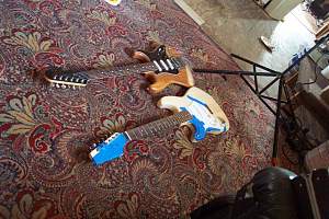

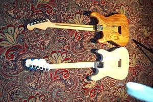

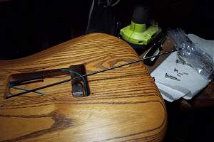

    73 strat I bought in like 87 I think for 400 bucks. Old Charvel neck no numbers no boogie parts or anything, and the wonderbar. Seymour duncan hotstack strats (when they were 3 models bridge/mid/neck). It has been Many iterations 3 switchs that would do phase or just series/parr/singletap. Right now it is a 7 tone. It was originally natural finish, it is swamp ash and my mix of linseed oil/turpentine/clear spar urethane. Took months to finish that and finally polish it with steel wool, and waxed with carnuba. Then what will become the lefty. hahah See if I can do it. It's a long road but well worth travelling as nothing good comes from "easy". So It should be fun. Click image for larger version.
