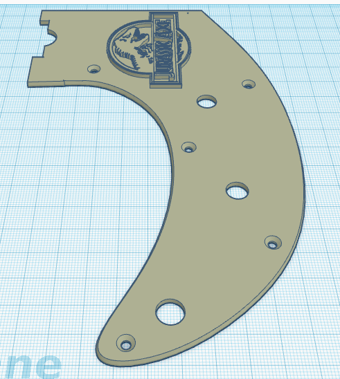

    Playing around with prototype minimalist pick guards:
Name:	Screenshot at 2021-10-24 15-21-47.png
    This was a 2 part P-Bass design that I've put together then carved up. It's not 100% but I'm curious to see how I can tidy it up. It does need more screw holes, and I was having some trouble adding more, but for the sake of seeing what I can come up with at the highest possible quality settings, this will do for now. I'm not even sure if PBG have used a standard P-Bass guard to know if these will even be close.
    I suspect that my printer will struggle with the logo being so small.
    I should have the first attempt printed later tonight. It's looking to be about a 12 hour print given the quality level I've sliced at.
    I'm not entirely convinced that I'll want to have the finished product 3D printed - I may wind up wanting to get some pickguard material and use this as a template to carve one out. Will see once it's printed I guess.

    Love it! It might be easier to cut from a blank, but I do like this 3d idea.
