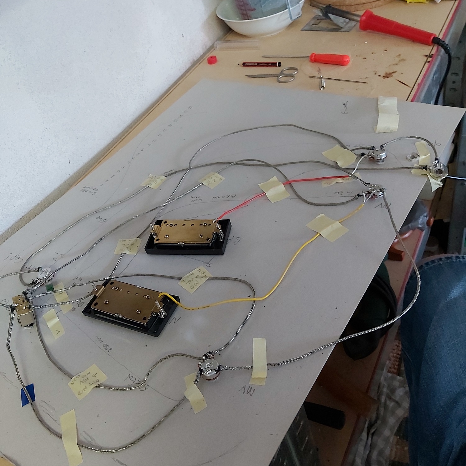

    Did a bit of soldering yesterday and most of the connections completed with just a few grounds remaining to be done. Should be interesting connecting the ground to bridge post! Managed to burn my left forefinger - twice - which proves my iron is hot even though it takes me eons to actually get the damn solder to melt! Looks so simple on Youtube and even though I replaced my 25W with a 40W some kits ago, it still doesn't flow. My old man usedd to use flux - maybe that's the answer! Onwards and upwards.

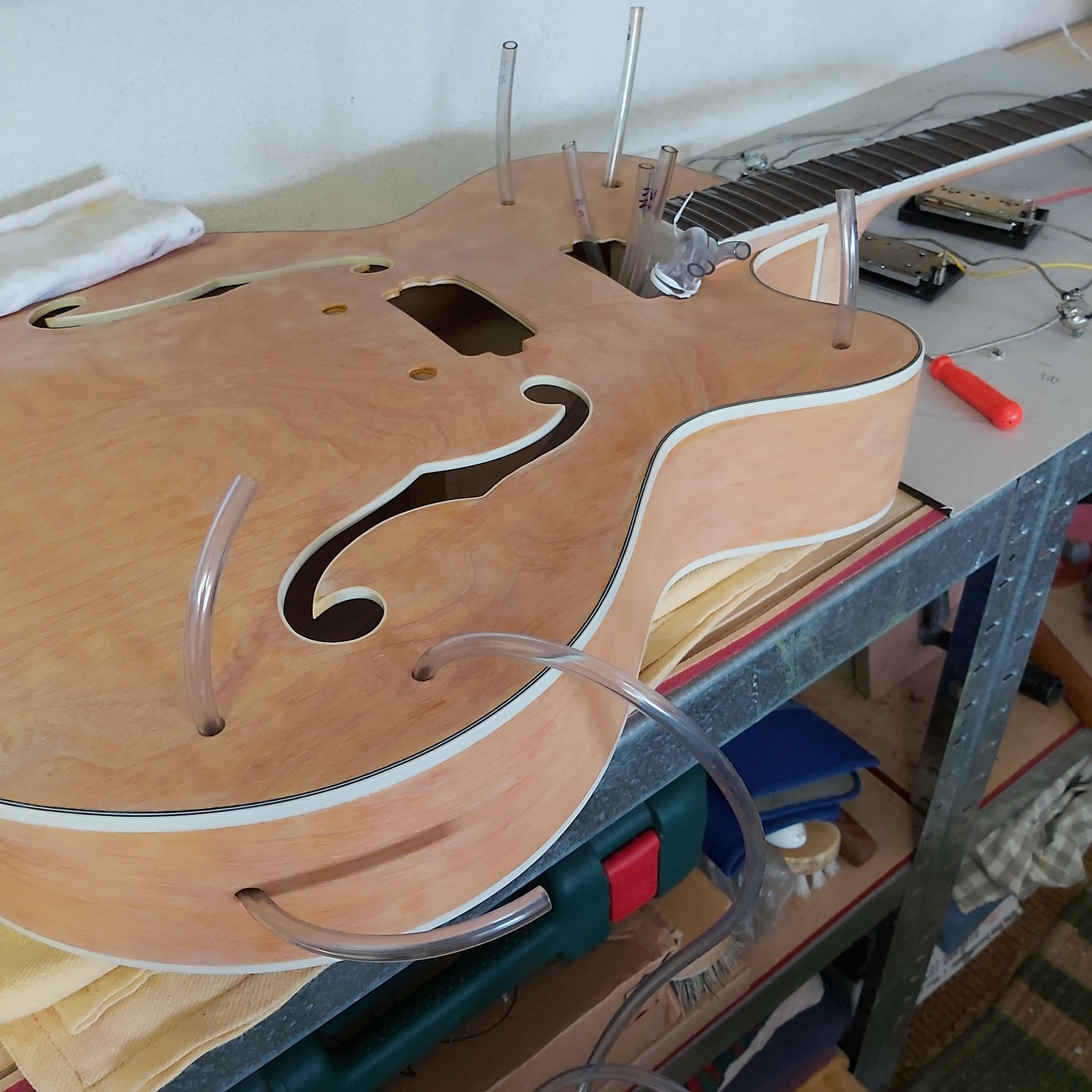

    Completed soldering today - much better after cleaning the iron tip (using lead-free flux core solder). Did my 'tube insertions' then realised the 3-way sw and the jack wouldn't fit the tubing, so reverted to the old 'string with washer tied' ready to position the jack. Will see how I go with the 3-way (bit trickier). Still hoping to be able to insert the bridge volume to bridge post ground wire post-tube insertions.Click image for larger version.

    Another productive day managing to get all the wiring inserted and pots screwed in place. Old trick with the jack and string/washer did the job and yes I did have a problem getting the 3-way sw inserted (had to remove the inner nut to allow enough thread to poke thru the top) and a few more cuts and scrapes to the hands. Then the miracle of the ground to bridge post sight unseen (absolute fluke I think). So it's all wired up and just hoping it all works eventually! Will let it lie for a day or two whilst I get a few more bits of myself removed courtesy of carcinomas - speaking of which where is the bloody sun? We're drowning!
