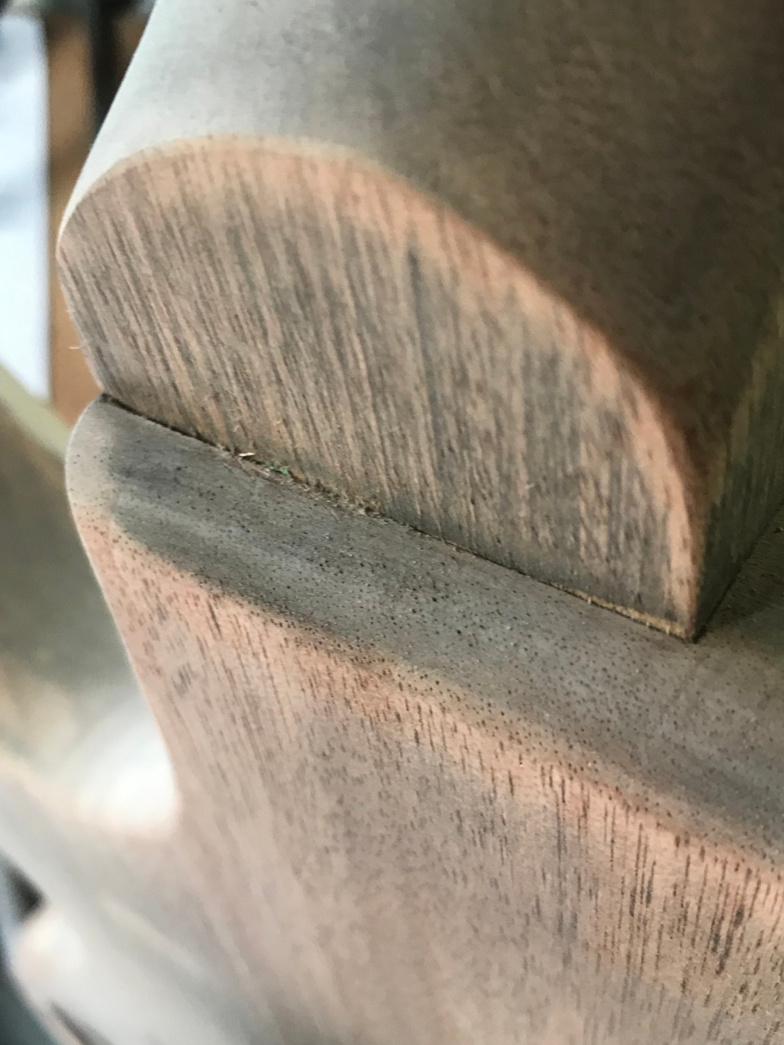

    This project has been on the back burner for a while, but I've recently had a chance to pore fill with timbermate, and set the neck. It's a much better fit now.

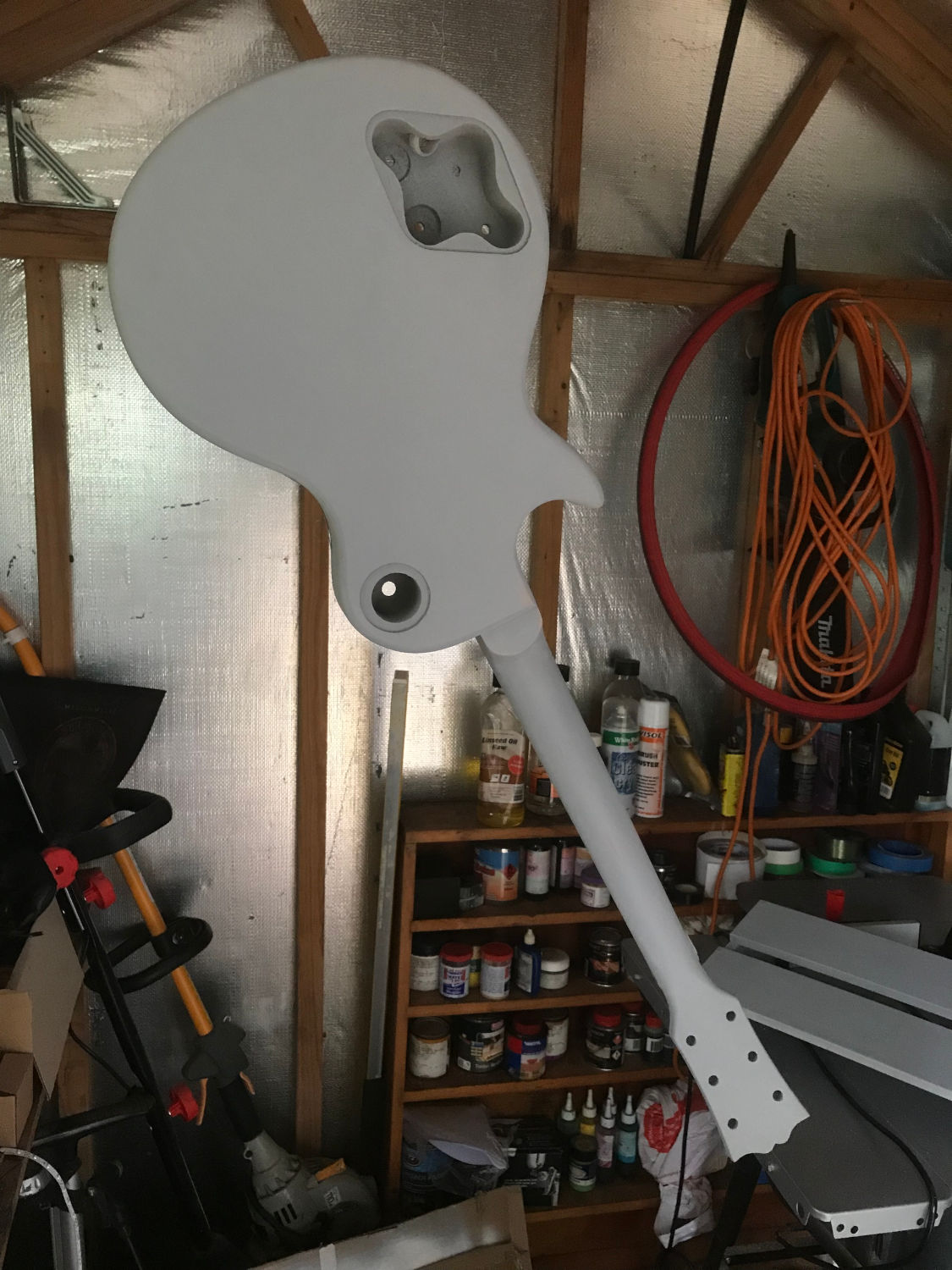

    I've been slowly making progress on this build, but it has been a great opportunity to learn from mistakes. It was on the back burner for a while as I learnt how to spray paint on some loudspeakers (they actually came out OK, at least from a distance.)
    I filled the pores with timbermate slurry, and sanded back to get the body nice and flat. Then I sprayed a coat of primer/filler, and sanded that back. At this point I realised that I hadn't got the timbermate as flat as I thought, but hey, it was nice and flat after the primer. I sprayed another coat of primer just to make sure, and sanded that back, at which point I realised that the first coat of primer wasn't as flat as I thought. Anyway, having sanded the second coat back it was nice and flat, so I sprayed a coat of black (actually a few coats - I'm using phrozin's method.) At this point, I realised that the second coat of primer wasn't as flat as I thought. I also found I had quite a few "inclusions" in the black, so I need to up my cleaning game, and make sure I filter the paint into the gun.
    Anyway, I have sanded the black back now, and it's pretty good, though not perfect. I'm going to shoot another coat of black before I start with the clear.

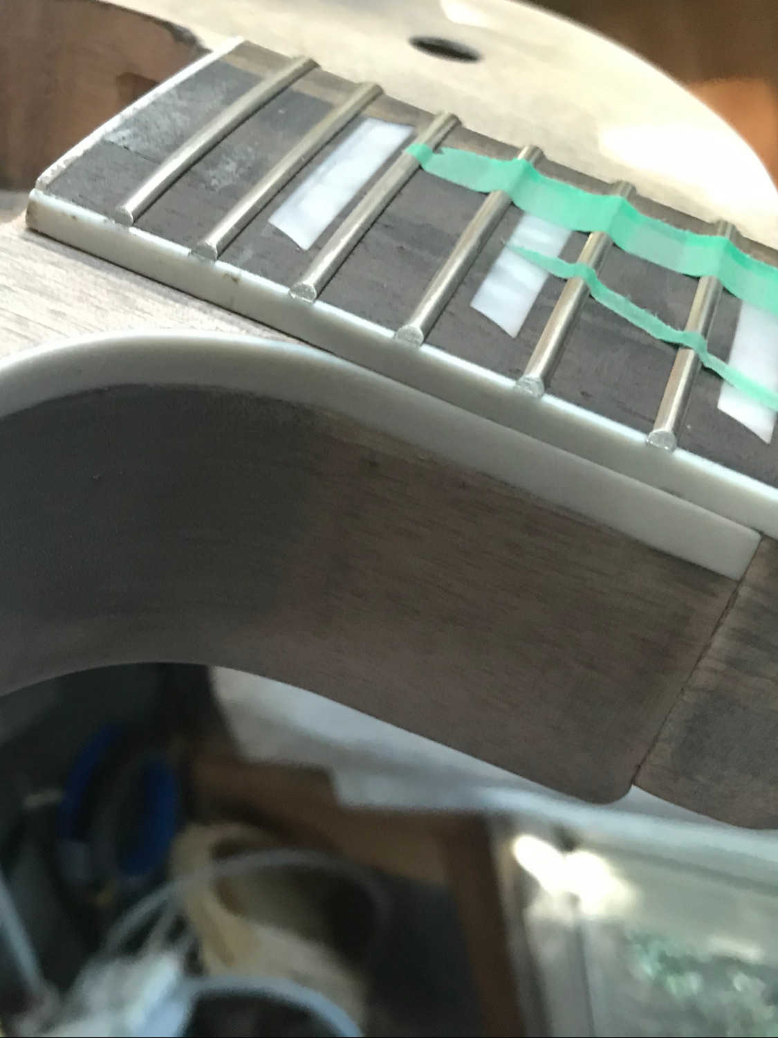

    In the meantime, I watched the Stew Mac binding scraping video, and armed with my newfound skill, took a blade to the binding. That's another reason why I need to shoot another coat of black. I have also made a binding scraper and bought some pin striping tape - it seems that regular (blue) masking tape shrinks when it gets lacquer on it, which is OK on the bouts, but not so much on the waist and cutaway.

    ...I have also made a binding scraper...
    Did you do the split wooden dowel & bolt trick???
    I did, having read a few threads on here about peoples' struggles with binding. It's funny how the Stew Mac video makes it look so trivially easy. The first time I tried it (without tool) I got a nice clean line, but completely overshot the binding and had a couple of mm of clean wood showing. I am finding that it's very difficult to get the binding clean - sanding it seems to make it "smeary".
