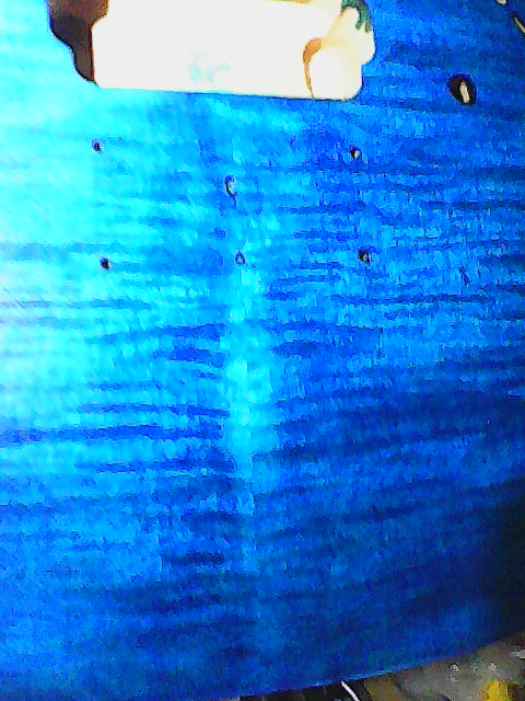

    Just curious, how'd you go with removing the glue? Did you get it sorted?
  6. #16
    I just gave it ANOTHER go, and it is still the same
    I am going to try very lightly sanding next, as I am now at the point that I don't care if I damage it. I have kind of written it off in my mind, hence I can't exactly ruin it, as I doubt it is really fixable.
    I think the lesson might be to avoid buying veneered bodies.
    I am going to buy a replacement body from Guitar Fetish, if it all goes wrong, as I know their product is of a reasonable standard for the price.
    I have to say that I am pretty annoyed about all of this, and someone on here might be getting a good deal on my unopened explorer kit...
  7. #17
    Ok, back on track!
    I can tell you that acetone with a toothbrush did not work, but acetone with 0 grade steel wool did. On the body, anyway.
    I tried this combo on the join down the centre, but it had minimal effect at best. What worked on that part was 240 grade sandpaper. I was firm, but careful, and it sorted it out!
  8. #18
  9. #19
    Good result. Sometimes persistence pays off!
  10. #20
    I've got a bit of a finish issue, if anyone can help. A light patch after my first base coat of wudtone.
    Has anyone experienced this? I thought the area would blend in with the first base coat, but it hasn't...
    I am referring to the centre line that I had to sand. I hope this isn't related to the acetone making the wood less porous...
