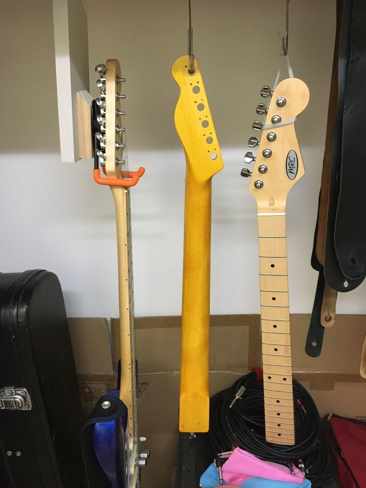

    In the meantime, here's an in progress pic of the neck for now:
Name:	2019 T Neck 2.jpg
    The Tele neck is a rosewood board and still masked up, so just showing the back for now. Pretty happy with the colour.
    Speaking of spare parts, the ST neck on the right is next on the list. That will get a re-radius and re-fret. Then I need a body to put it on!

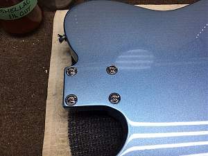

    One more "enhancement"...
    I had a couple sets of neck screw ferrules, so I decided to risk drilling the countersunk holes and piss off the neck plate.
    A nice sharp 14mm 4-fluted Forstner bit did it perfectly.
    There is a small indented line in the finish at the top from the neck plate, but this exercise was more about extra comfort than aesthetics. It decreases the thickness at the join by 2mm, which actually makes a noticeable difference in the feel at those higher frets.
Name:	Neck ferrules.jpg

    Yes, the colour is one reason I opted against the re-finishing idea. I could probably match it, but why bother?
    One thing I was reminded about when I drilled the recesses for the ferrules, is just how thick the factory polyester (polyurethane) finishes are! The combined sealer and finish layers on this is approximately 1.2mm thick!
    Edit: Fun fact - that's 5.5% of the body thickness!
    I could never match that just doing a single-pack lacquer.
