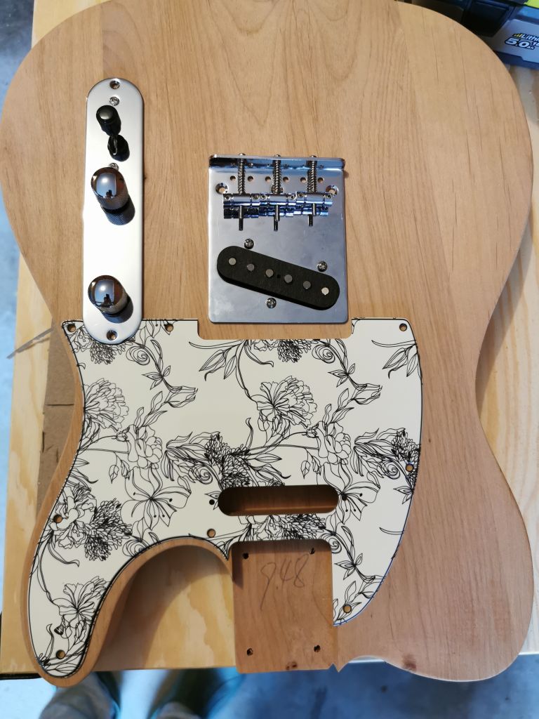

    Hi Mr Eddy,
    would the scale length be better if the neck moved all the way to the end? I think I would file the neck corners out a bit - and I had to do that on my FBM-1 build.
    Also, and it may be the picture, but the high E sting looks a bit closer to the neck edge than the low E string.
    Hi Trevor,
    That's my plan at the moment. That should get me an extra 1 or 2mm. So I'll do that, re-measure and see where things stand.
    From the photo I think you're right with the strings, but that part was a bit rushed anyway. I'll have to repeat that and check a bit more carefully.
    Bridge position is fine. You want 648mm from inside of the nut to the break point of the treble E saddle. (where the string "leaves" the saddle)
    You have heaps of adjustment there in either direction, and if you round off the heel corners as mentioned previously, you'll lose 1-2 mm and still be within range.
    Awesome. Thanks very much.

    The other development is that the pickguard I ordered arrived. Quite happy with the way it looks, although I'll have to do a bit of filing to make it fit the neck properly. Opening is a bit too narrow.

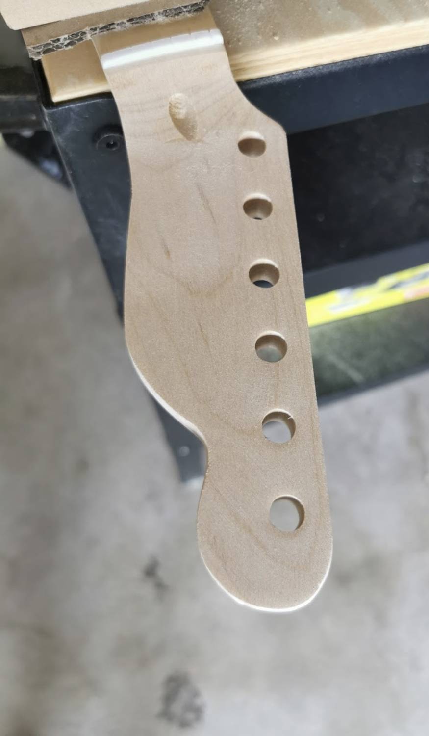

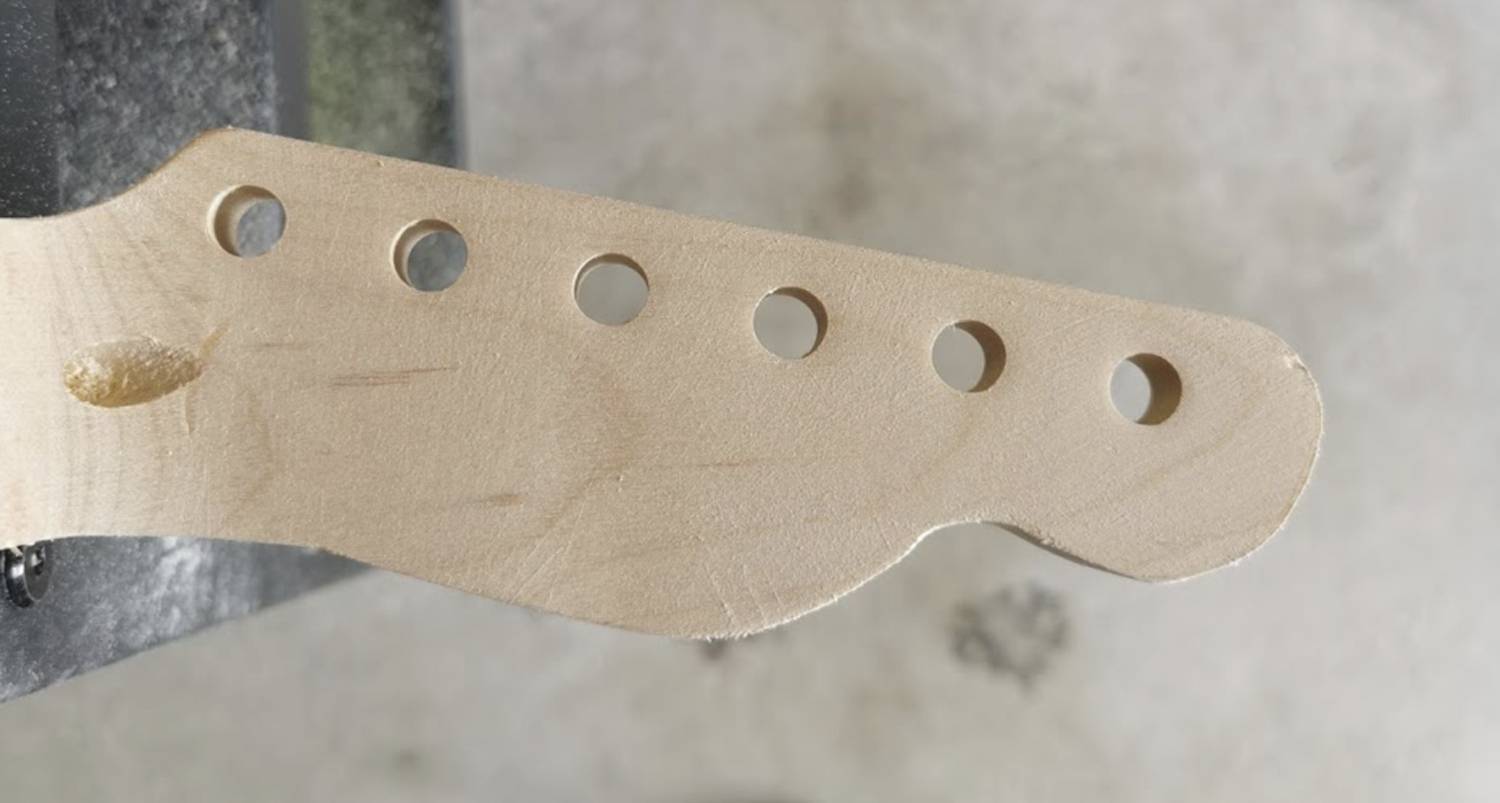

  9. #19
    A bit of progress. Getting close to done on the headstock. It's not perfect, but to be perfectly honest it's better than I was expecting. With a bit more finishing it should look ok.
    Also started on sanding the body. Prepping and staining coming up shortly. Really looking forward to that.

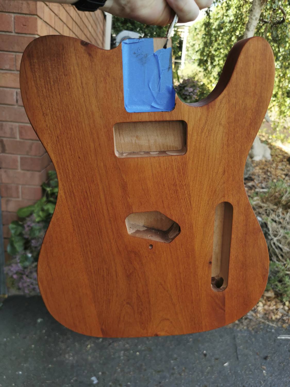

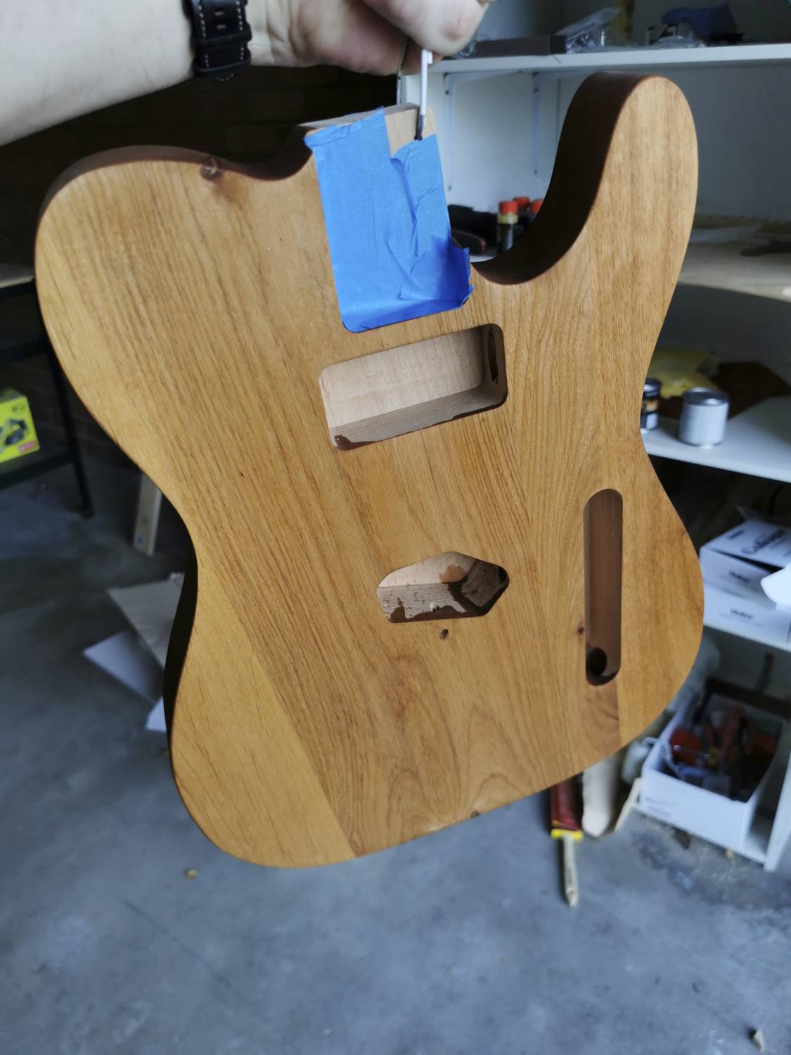

  10. #20
    So a bit more progress.
    Before anyone comments, yes, I realise that given it's a screw in neck I didn't need to mask anything. Ah well. Not like it makes any difference.
    That aside I applied timber primer followed by a few coats of FW Prooftint (Maple) and I'm pretty happy with how it's looking. Obviously it's just been applied so I'll see how it looks tomorrow afternoon but for the moment I'm quite pleased with the result.
    It'll be clear coat time next, depending on how this looks tomorrow.
