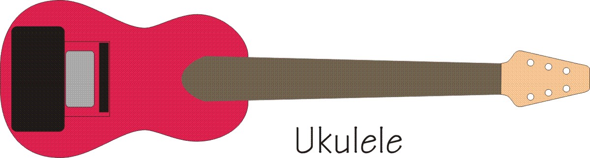

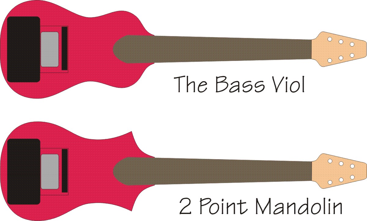

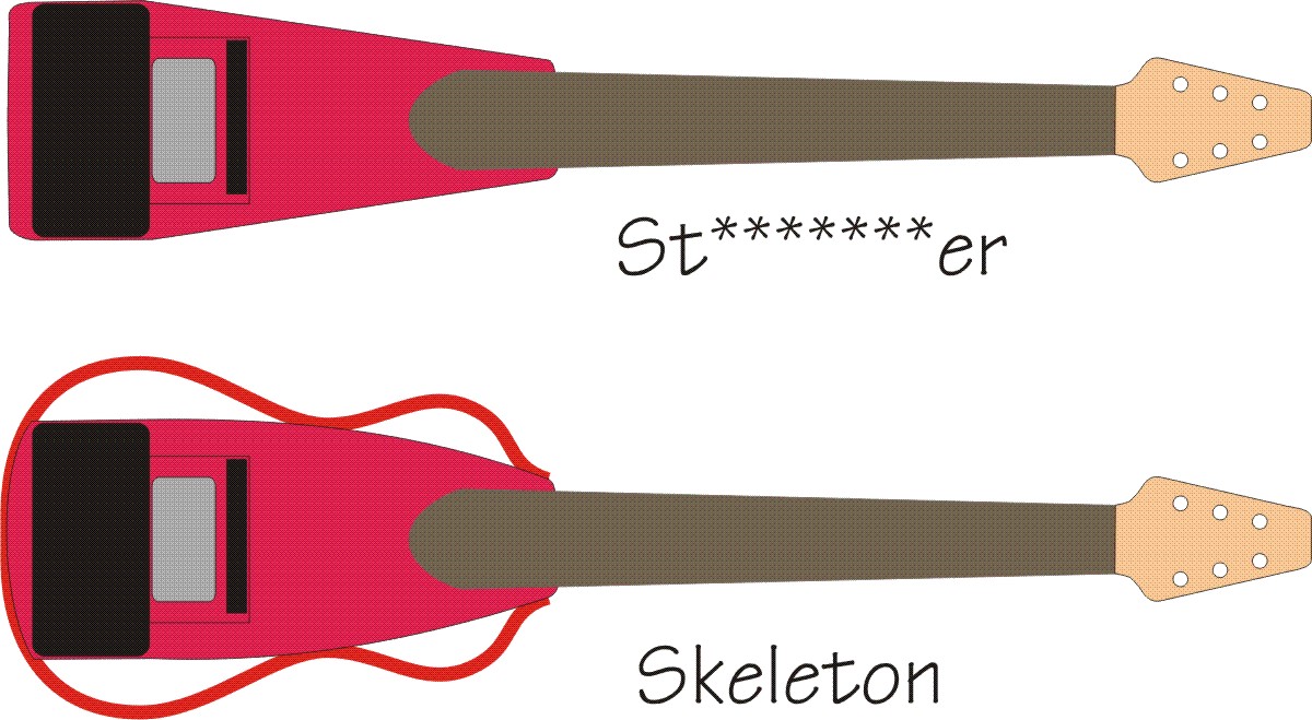

    Ok folks, which body shape would you pick. The big black lump is the control box for the midi pickup, which has a major impact on the options...
    I've decided I want a symmetrical body and not real cutaways. My current favourites are the first two. To review the rest it's a radically short scale instrument with a very short body. It's getting a through neck, and it's job in life will be playing bass parts and high fret access is not important.

    Number 2 gets my vote
    Guns, Guitars, Bikes and Cars and the love of a good woman who allows me to indulge
  6. #16
    3,097
    I like 1 and 5.
