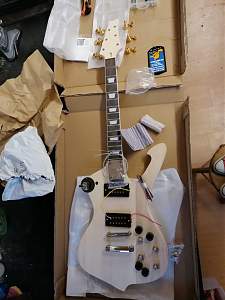

    I´ve measured the bridge and tailpiece, ordered some Chinese gold hardware from AZ, with the same dimensions. It has also the same dimension as from an old Epiphone SG I used to own.
    Why Chinese: there are 2 different options. Chinese for about 20€ or Tonepros, Gotoh etc. for about 150-200 €  so let’s try the Chinese ones. When the fit of the studs is right, I think there should be no tuning issues.
    Tonerider Generator PU are also on the way and will arrive this week, I will also order Push/Pull (or maybe Push/Push) Potis, because why not =)
    Greetings from wintry Austria
    Dominik
  6. #16
    Greetings !
    Update Body:
    First, I did another mock build with the new bridge and checked the string alignment
    –>everything is fine!

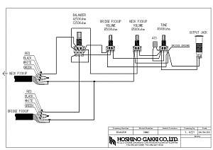

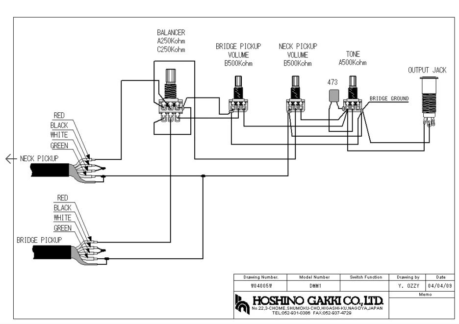

    Then I wanted to check which treble/bass shield on the toggle switch Daron uses on his guitar and WHAT!
    At a closer look, he has no toggle switch. He uses one tone pot as blender. Good thing - the Japanese luthiers has the same tidiness as the Germans =)

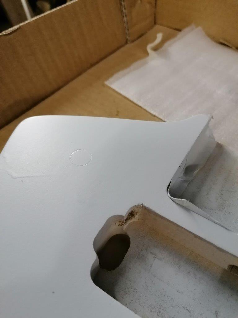

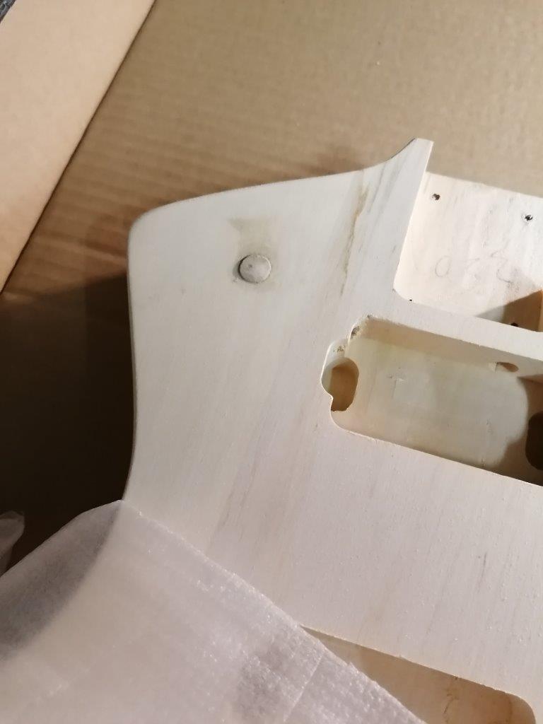

    I´ve ordered one blender pot and has filled up the hole.

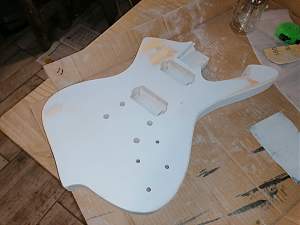

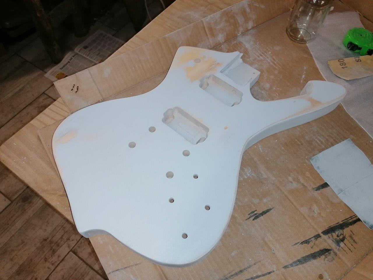

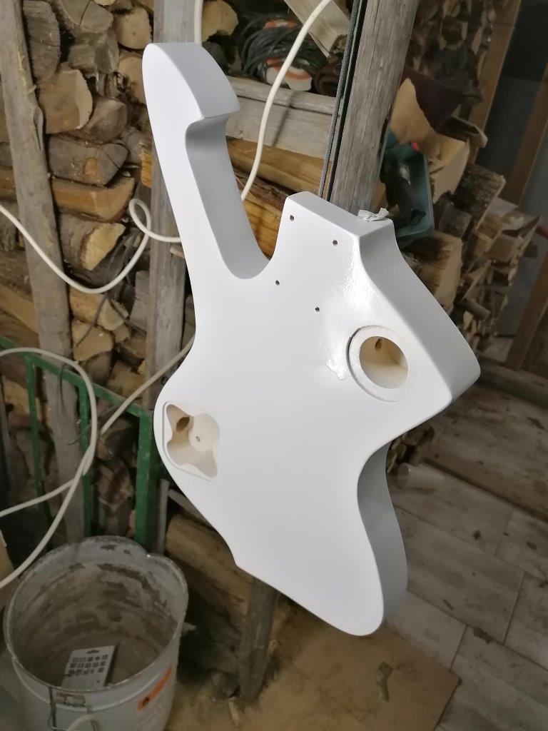

    After that a thick coat of filler and first coat of primer.

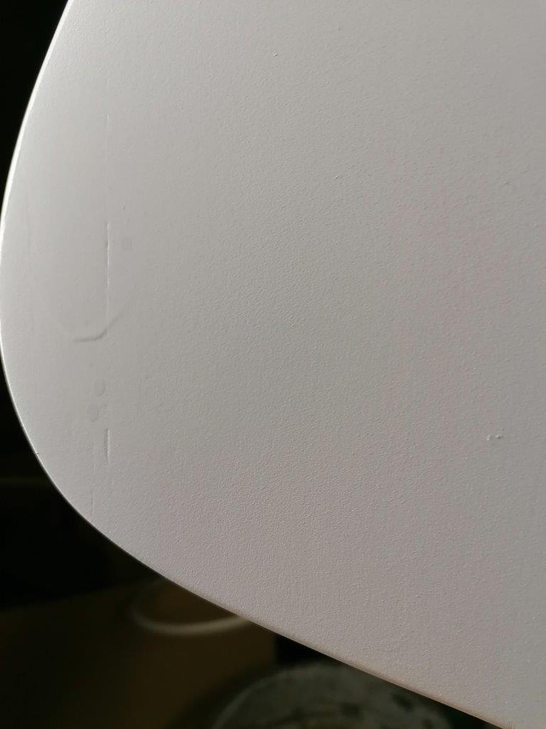

    At a closer look there were some gaps – no need to worry I have sanding paper for ages =)
    Sanded down to the gaps filled it and after drying for another day, and a few minutes of sanding looks quite well. Even with the fingernail I can’t feel any gap.

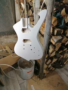

  7. #17
    Today second try with primer!

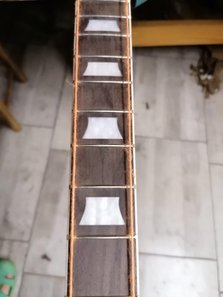

    Neck:
    I´ve changed my mind and will stain the neck black. Feeling > Look =)
    After the first treatment looks quite well. Today sand with 400 grit and maybe a second round with the stain or I will start with oiling.
    Neckplate will be painted like the body. Here everything looks good.

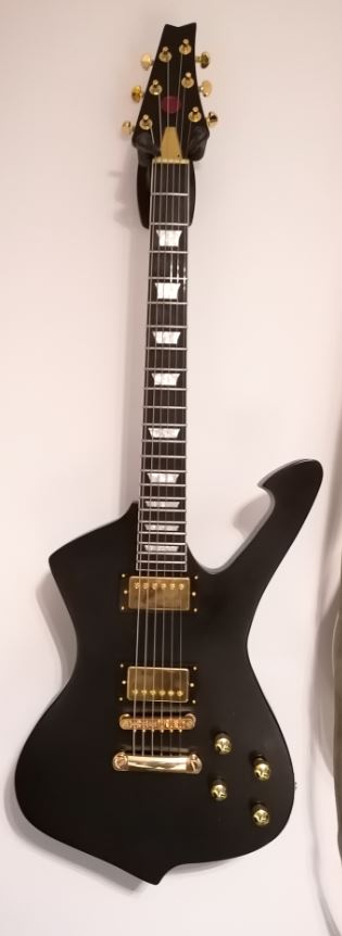

    Yesterday I finished my Kit.
    Had to pause the build until the weather gets better in Austria. I tried to paint the guitar with the gun in my workshop – bad idea – to much dust etc. As the temperatures gets above 15°C, I started painting outdoors with a much smoother result. (We have the coldest spring in Austria since 30 Years :P )
    Many up and down especially with the clear coat finish. I started with high gloss and after 2-3 tries I changes my mind to satin gloss. And this black satin looks killer. It looks like the guitar is sucking the light like a black hole – AWESOME.
    Soldering went pretty smooth, except for the blender poti. I soldered the wires like in the diagram, but each slider is different.
    Instead both pickups make noise in the middle position the tone was completely off, so I had to mirror the soldering on the blender poti.
    I haven´t played the guitar over my full stack, but via the Red Box it sounds pretty good (tuned down to drop C)
    Was an amazing experience ! This forum is treasure chest for guitar building information!
