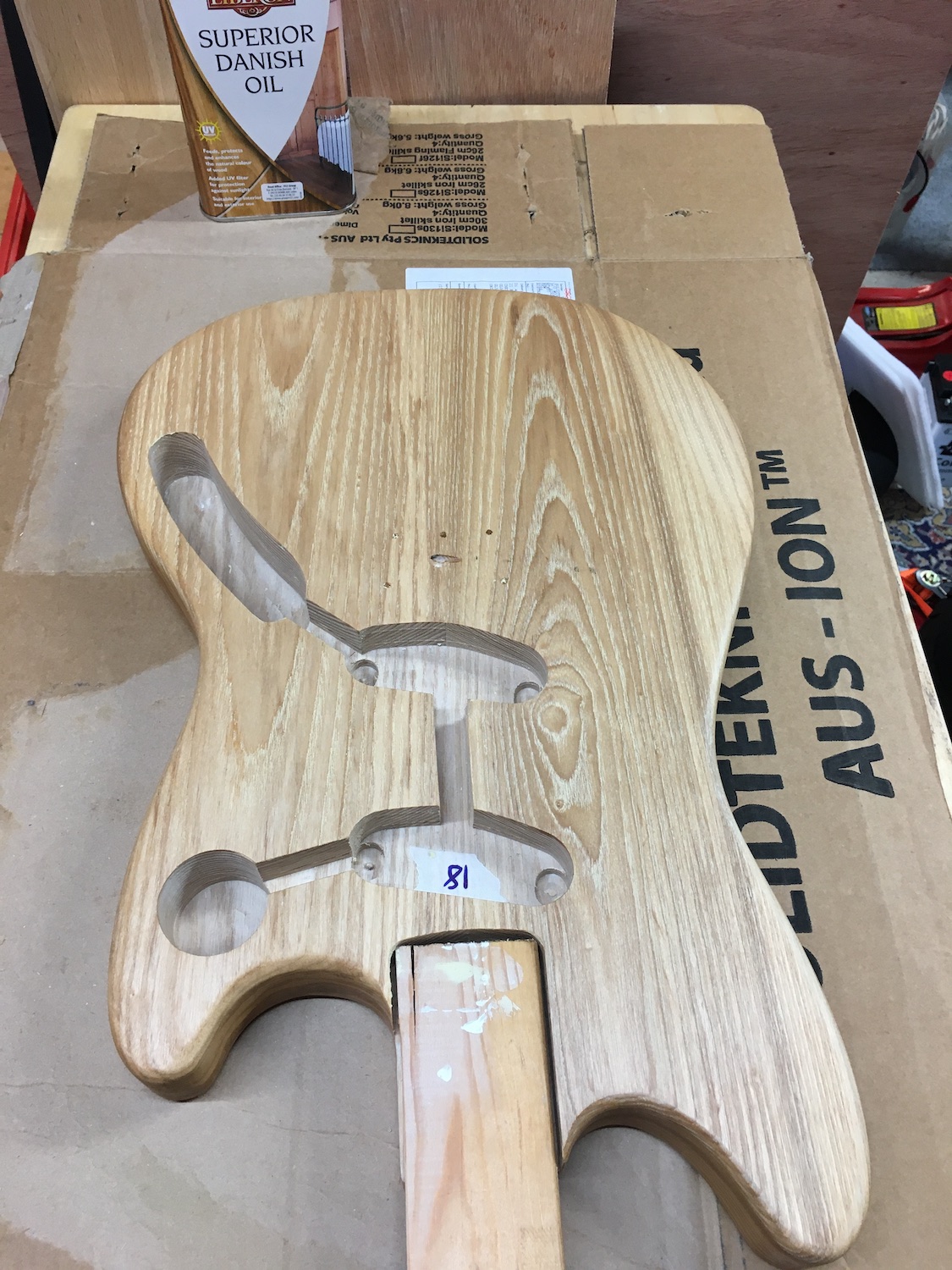

    Body grain-filled three times then sanded to 240 grit with a machine, then hand-sanded to 360. First coat of Danish oil applied, only (insert large number here) more coats to go...but it does feel very smooth already.

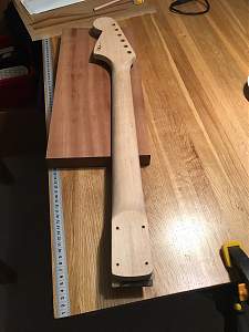

    Soooo...after waiting nearly three months, it turns out that the factory can't supply Pit Bull with replacement necks for DMS-1 kits (24" scale length). That's a bit of a blow and something of a hole in the whole selling and servicing of kits chain, in my view. Anyway, Ben agreed to refund some of the cost, which will go some way towards buying a new neck myself - which I've done. Without going to bespoke companies or top-end suppliers of licensed neck, I found a 24" scale neck from a seller on eBay, in the UK. Undoubtedly made in China at the price, but supplied from the UK in only a few days. The fretboard isn't maple, as I'd wanted, but it's the only one I could find, so it'll have to do.
    It is fractionally small than the Pit Bull neck, so I've moved up to veneer to pack out the neck pocket, then sanded it down slightly for a snug fit.
    Here's the neck, embellished with my proposed logo. It's an épée, a fencing sword, a big thing in my past.

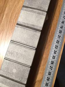

    Next up, neck out and fret levelling. Made the neck flat with a notched edge, then loads of masking tape on the fretboard, sharpie marking on the frets, and 360 grit on a long piece of known flat hardwood. Once they were all level, repeat very gently with 600 grit. As you can see in the photo, there was quite a difference between the highest frets and the lowest. Hopefully fret crowning will still be OK, given that some frets are only just flat on the top and some are very flat...we'll see when the newly ordered fret-crowning file arrives!

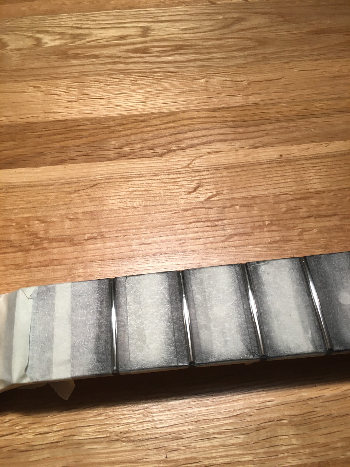

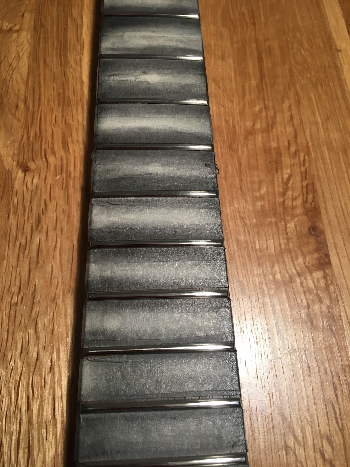

    Fret crowning file arrived so, rather nervously, started the filing. I don't know if I've done it properly, or enough, and I guess I won't know until I get it strung up and try to play it. I decided that i'd rather file the frets too little at this stage, rather than too much...
