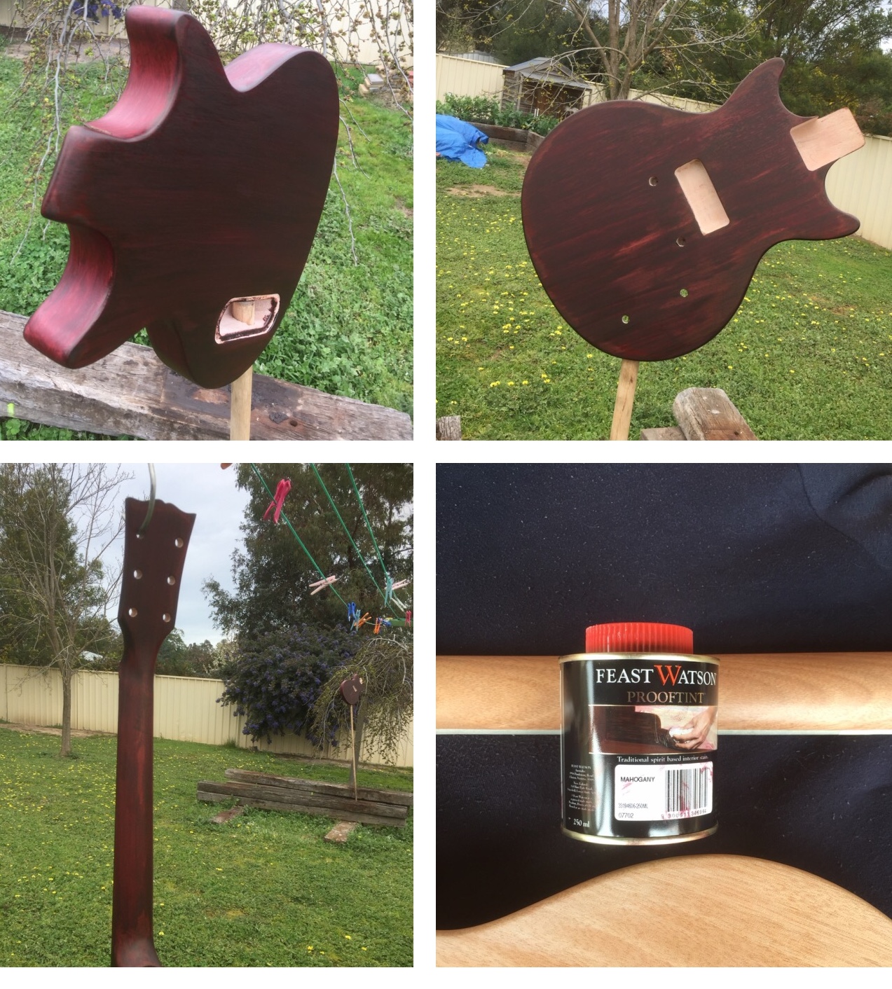

    Quote Originally Posted by Muzzajon View Post
    Attachment 37400
    Is meant to be “cherry red”, but looks more like poop.
    Every woodworker has had that problem. Sometimes more than once.
    What type of timber are your test pieces? If it's pine, the stain is going to react differently than on mahogany as it is a naturally darker timber.
    I would suggest thinning the stain so you have more control over the shading. It's easier to go darker by adding coats than it is to lighter by sanding back.

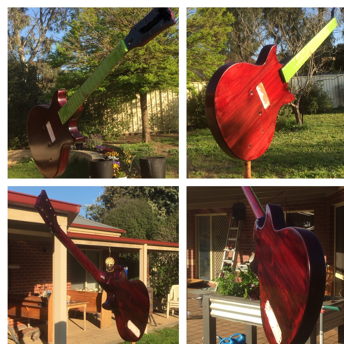

    I had all sorts of trouble getting the colour I wanted. Stained then sanded the top 4 times.... On the 4 th attempt I ended up with a top I can live with, but not exactly what I envisiaged. This stain dries really fast,so if you muck about too long, the result is terrible.Click image for larger version.

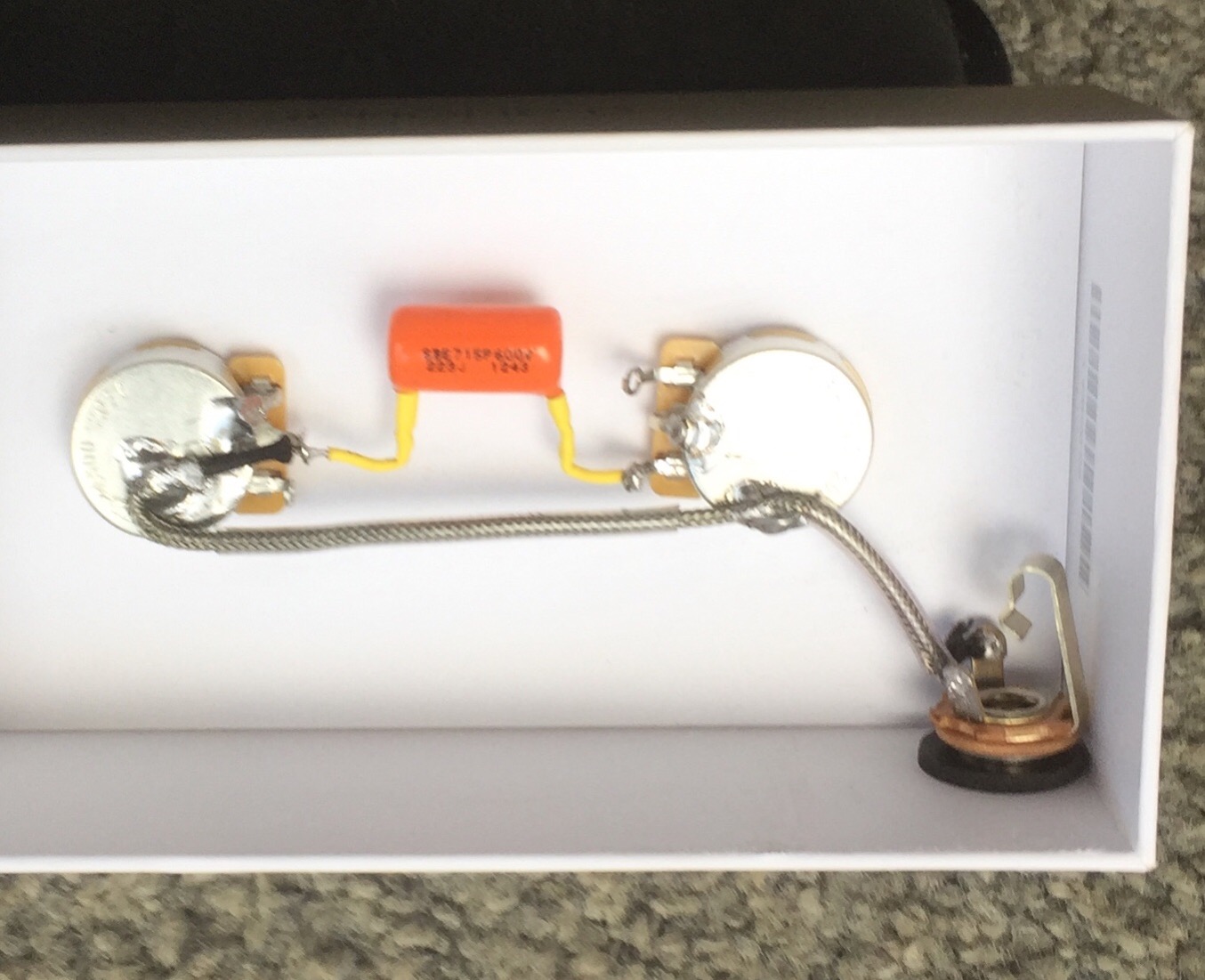

    Wired up the harness last night.Click image for larger version.
    I like the colour. It will look nicer once you've got some clear over the top, levelled it and polished it up. It's similar to my GSJ-1, which went quite dark (I did apply more stain and then some vintage cherry lacquer to help cover up glue lines and marks in the wood), whilst my GSM-1 has stayed a brighter cherry red. I like both of the colours I've ended up with.
    Nice neat wiring harness.
  6. #16
    ...I ended up with a top I can live with, but not exactly what I envisaged.
    Yeah, more often than not that's what happens, but it can also lead to pleasantly unexpected results.
    +1 on the tidy wiring too!

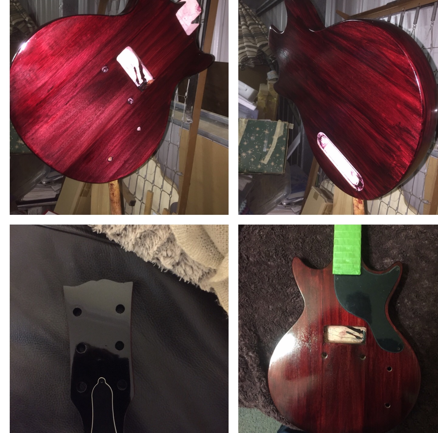

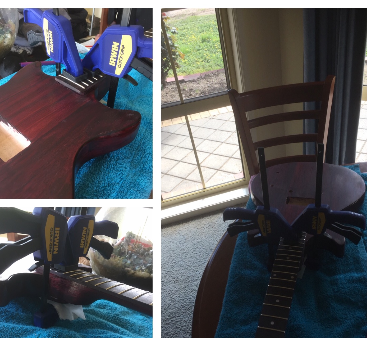

    I glued the neck on last night and gave it a coat of clear this afternoon. Also counter sunk studs for the bridge as I couldn’t get the action low enough. The weather has turned cold and rainy, so might have to wait a couple of days before giving it a light sand and second coat of clear lacquer. I’m learning to be patient...Click image for larger version.

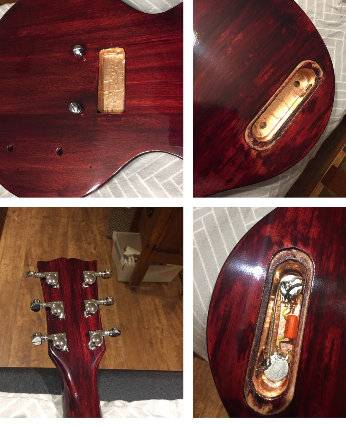

    Finished guitar yesterday. Shielded cavities for pickup and controls. Fitted Grover mini locking tuners.Click image for larger version.
