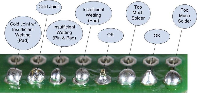

    The thing I forgot to mention re: soldering is you are not sticking things together with hot solder. That won't work. You are heating both bits so the solder flows onto them - as it solidifies, it brazes the surfaces together.
    When trying to solder something like a wire to the back of a pot casing, scrape a small section of the rim of the back of the pot to get the plating off - it's much easier to heat than the flat bit on the back. Tin it and the wire with solder, then heat it with the tip until the solder remelts. Then apply the tinned wire, and a dab more solder on top. You will be amazed at how well it solders, and you won't melt the insulation on even the scuzziest wire. Heat the big bit first. If it looks like volcanic elephant snot, clean it off with your solder sucker or braided wick and go again. Too much solder risks bridging to adjacent components. if you
    in this pic, what they refer to as 'wetting' is what I call tinning - getting a layer of solder on the join point. Soldering to PCBs is a mofo - have to be careful and use low watrage because if you cook the traces, they lift from the board.

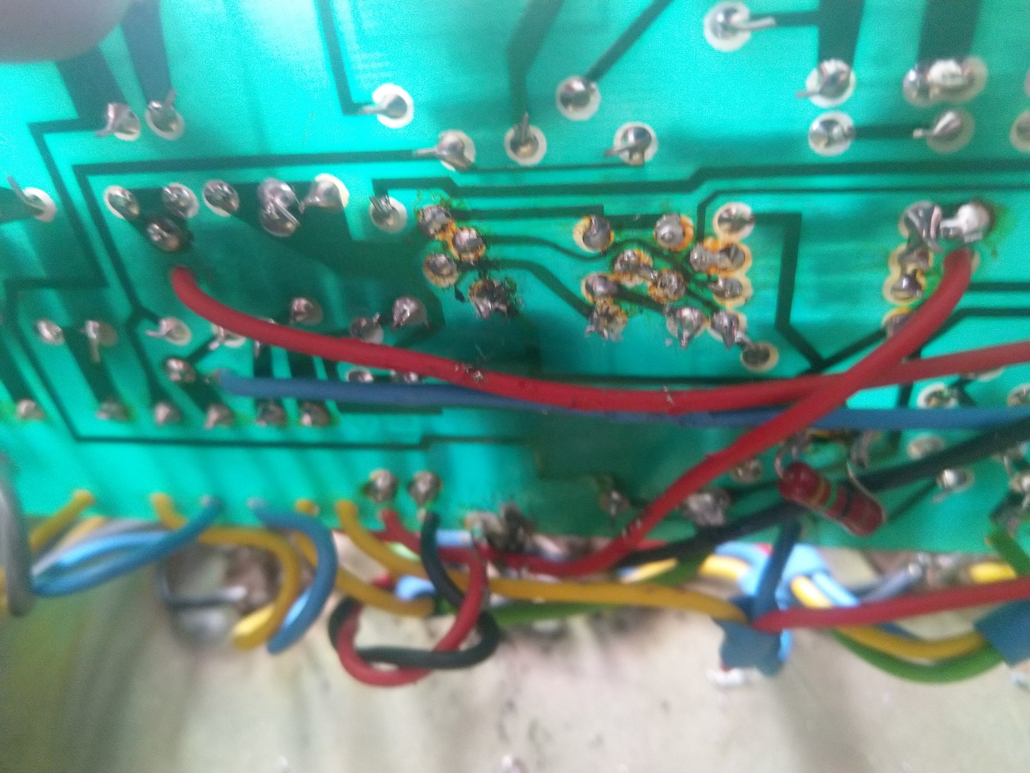

    I love my Marshall, hate the PCB! Changed all the 35 yo caps and some of the switching diodes on this board - the traces are buried so deep it's hard to cleanly solder them. Not a job for the feint hearted.

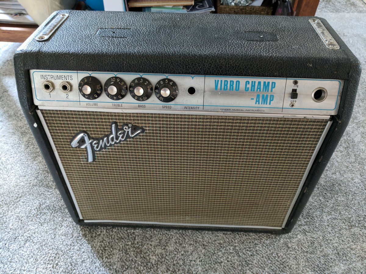

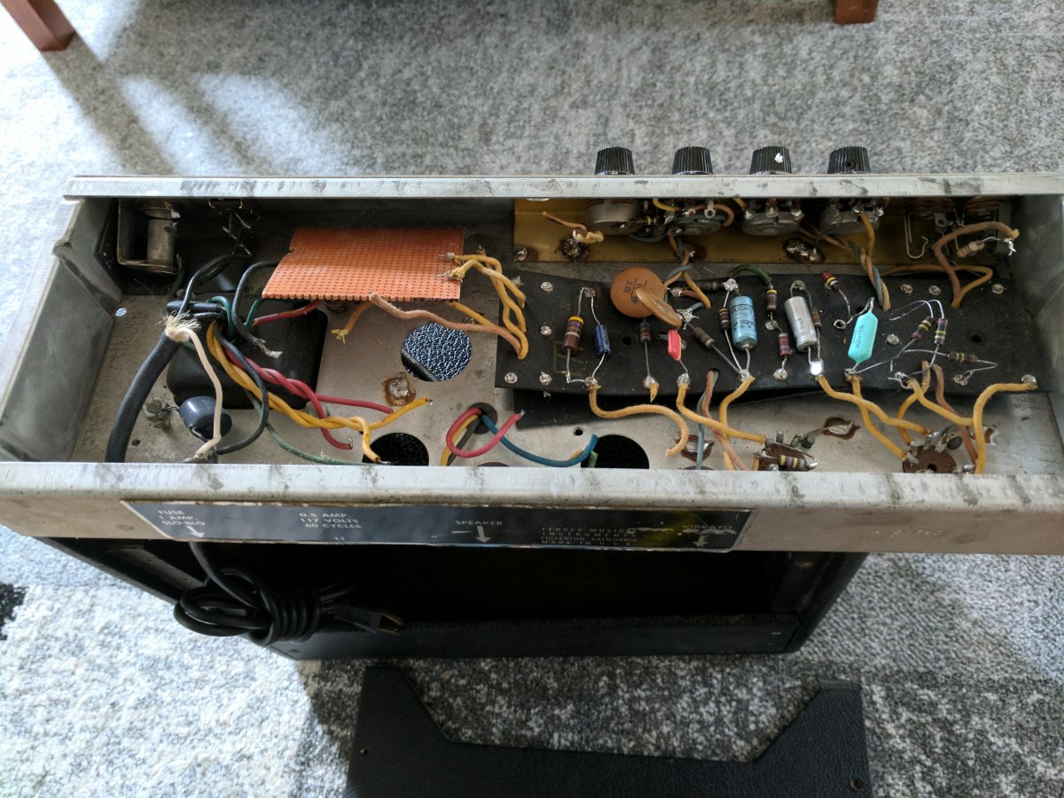

    I started out as a guy who thought smoke ran around in wires and I still hate reading schematics as much as I hated algebra in high school, but I have got to the stage where I can bias amps, diagnose faults and have built two Tweed Deluxes and resurrected a 68 Fender Vibrochamp husk - cabinet, speaker and transformers, no tube sockets and half the components gone off the tagboard. So there's hope for anyone.

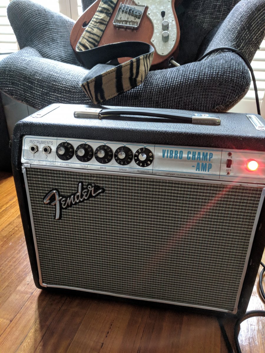

    Here 'tis cleaned up and working.

    That’s a good picture of different errors in soldering. A good way to practice is to buy a bag of cheap resistors and some perfboard (for pcb) and terminal strips (for point to point) and go for it.
    Question on the Marshall pcb’s. Are they not thru-hole plated?

    Depends on the generation. The 83 generation of PCB is a double layer board has the glass board in two layers around the copper trace. It's actually very durable, hanging off the pots is a weak point, it's wise to touch up the mounting tabs whenever it's apart.
    But it was never designed with maintenance in mind. There's tons of these around still because the tube sockets are not mounted to the board and the separate heater wires which carry significant current as traces in the later stuff are a weak point.
    Newer boards like in DSLs are single layer and through-plated. They're more flexible and the traces may crack easily.
    Fender Hotrod and Blues Deluxes are pretty dodgy for this.

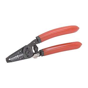

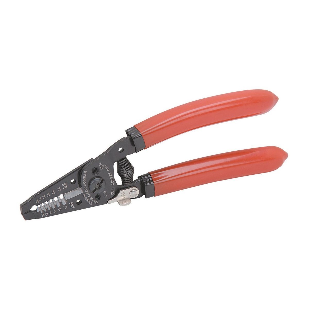

    ...a wire stripping tool. You can do pretty much any soldering a guitar requires with these few items.
