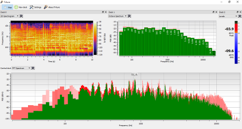

    Doh! That's a good reminder. I already have Friture which can capture audio from my THR amp via USB. It has very little latency. I always forget I have it though, and only used it once to see what the tone control on my Direct Drive clone is doing (not much as it turns out, just cuts a bit of high freq noise - could try changing the cap but I like the sound and don't want to mess with it). As well as a scope it also has various frequency domain displays.
    It's open source and supports Linux, Mac, and PC. Worth a look.

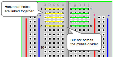

    Thanks DC, this is straight on Vero, as I dont have breadboard yet. I see how breadboard will be a good investment though. Does it act like Vero in long rows? Or do you have to create the circuit as such?

    I am not sure that the 10u cap would cause that sort of problem. The impedance of a cap varies with frequency not voltage level, although I am not sure how a fault would affect that.

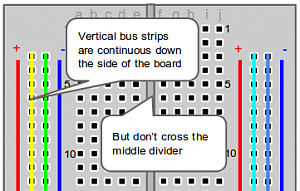

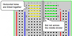

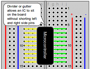

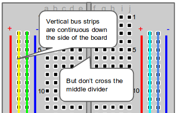

    Breadboards are not connected the same as veroboard. They are like this:
    All images taken from this intro to breadboarding. It's a short read and a very well written intro to using a breadboard. For myself, I find it easier to breadboard a circuit direct from a schematic, but it can also be done by systematically working through a vero layout. I just find it a little harder since the layout is arranged for compactness not readability.
    A lot of the Tagboard Effects layouts are modified from available schematics though, so it can be worth working directly from the layout you plan to build.

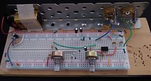

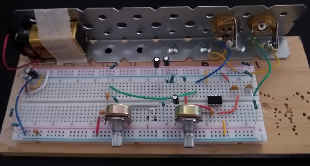

    You can pickup a decent breadboard from Jaycar for not too much money. Here's how I have mine setup for pedals:
    Other holes on the angle bracket are drilled to accept switches as required. No power switch, I just add/remove the ground lead from the battery. That circuit is 3/4 of a Rat (no tone control or output buffer at that stage).
