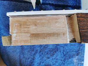

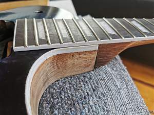

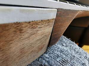

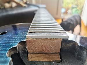

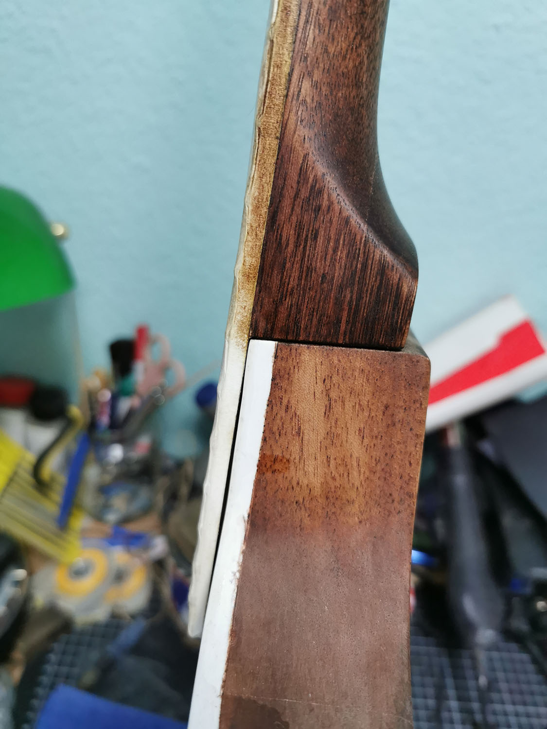

I have trouble properly seating the neck. It's snug with no wiggle room, which is good, but it somehow looks uneven.
There is a 1-2mm gap between the fretboard and the side of the binding, which is not right. On my other Les Paul style kit, and also all the other good builds I've seen so far, there is no gap, binding on binding so to say.

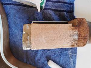

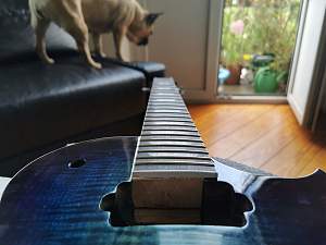

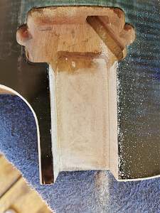

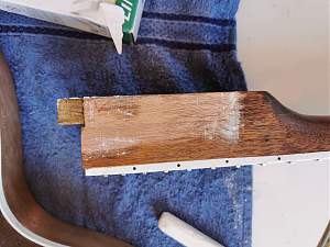

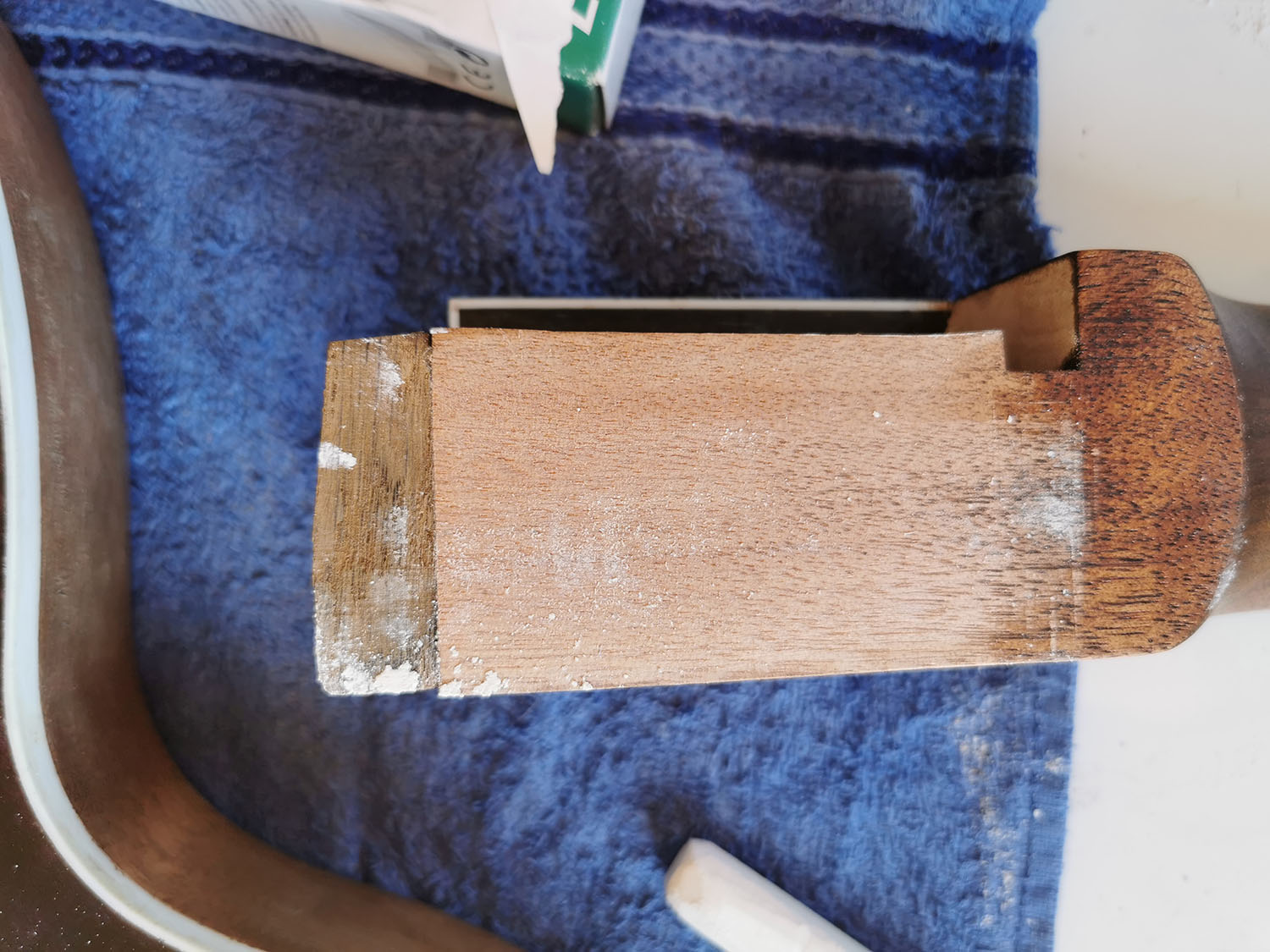

The thing is, I can't really figure out where the problem is. I measured the routed cavity with the depth stop of my caliper and it has the same depth left and right. Also, the neck has the same height left and right. But it doesn't sit in it evenly.
The heel of the neck is also around 1mm overlapping the edge. it APPEARS the cavity is tilted, but my caliper says it's not.
I'm not quite sure what would be the best way to go:
- Sand the neck cavity on the left side down, so this side sits deeper, the space disappears and the heel sits flush? How can I make sure this will work with the strings other than installing the bridge posts now to see how it looks? If it requires installing the bridge posts, I'd have to do all the finishing first I guess.
- Or just glue it in and sand the side of the heel flush and live with the space under the fretboard?
If I would do the first option, would this change the neck angle? How do I even find out how the neck angle is and must be?
