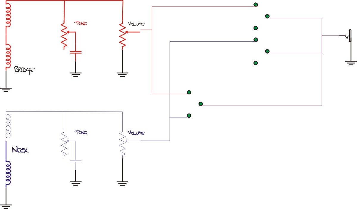

    You have definitely given me lots to think about. While using rotary switch or similar would perphaps look bit better than toggle I would like to stay in four knob configuration. Last couple of days I have tried to sketch up and understand the Simon's proposal and for the life of me I can't figure it out. If anybody has wiring diagram for that lying around please save me and share
  8. #18

    Quote Originally Posted by OutOfYourDepth View Post
    Something like this @Simon?
    Lower switch always connects one pickup or the other, upper switch connects both or none.
    Build #4, pre-owned PB ESB-4
    Build #5, Lockdown Mandolin
    Build #7, Mini Midi Bass
  9. #19
    Yes. The top switch is probably better described as bringing in both pickups or having no effect (rather than no pickups) leaving the bottom switch to do the neck/bridge pickup selection.
    OOYD, can you convert Jim's switch diagram to the contacts on a push/pull switch?

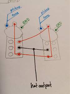

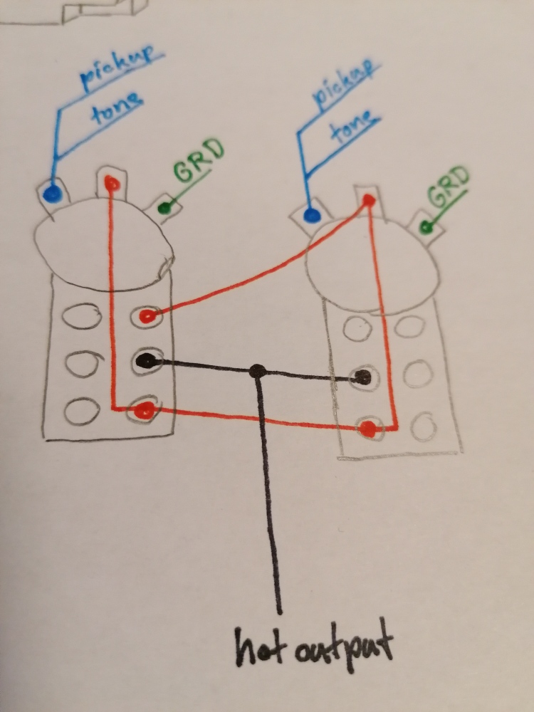

  10. #20
    Thanks for the diagram. I understand the symbols other than that im not entirely sure.. or even nearly sure.
    Something like this?
