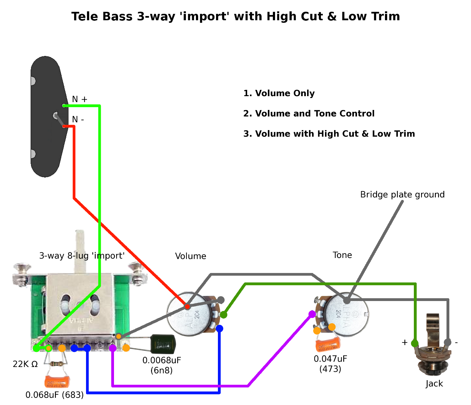

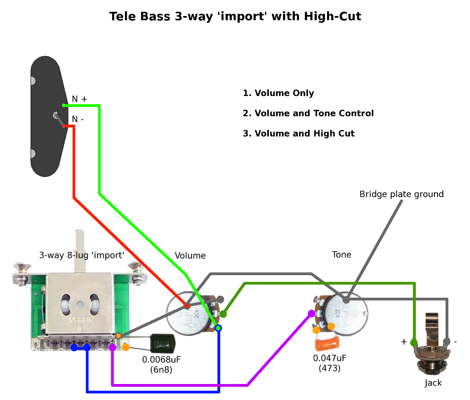

    Here are a couple of options to look at to use the switch to change the tone.
    Cliff
