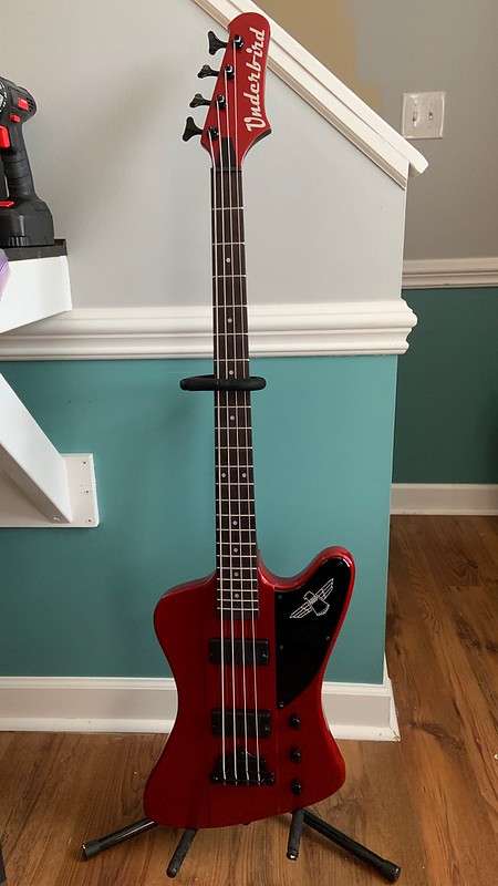

    Well I got the issues worked out and I am calling this one done. Will post some glamour pics in the gallery also. Thanks for the help everyone.

    Yes it sounds good with the strings that come with it. Im sure better pickups would help it but Im happy with how it sounds.
  8. #18
    A decent set of strings should certainly improve it. The kit strings are pretty agricultural and only really any use during basic set-up.
