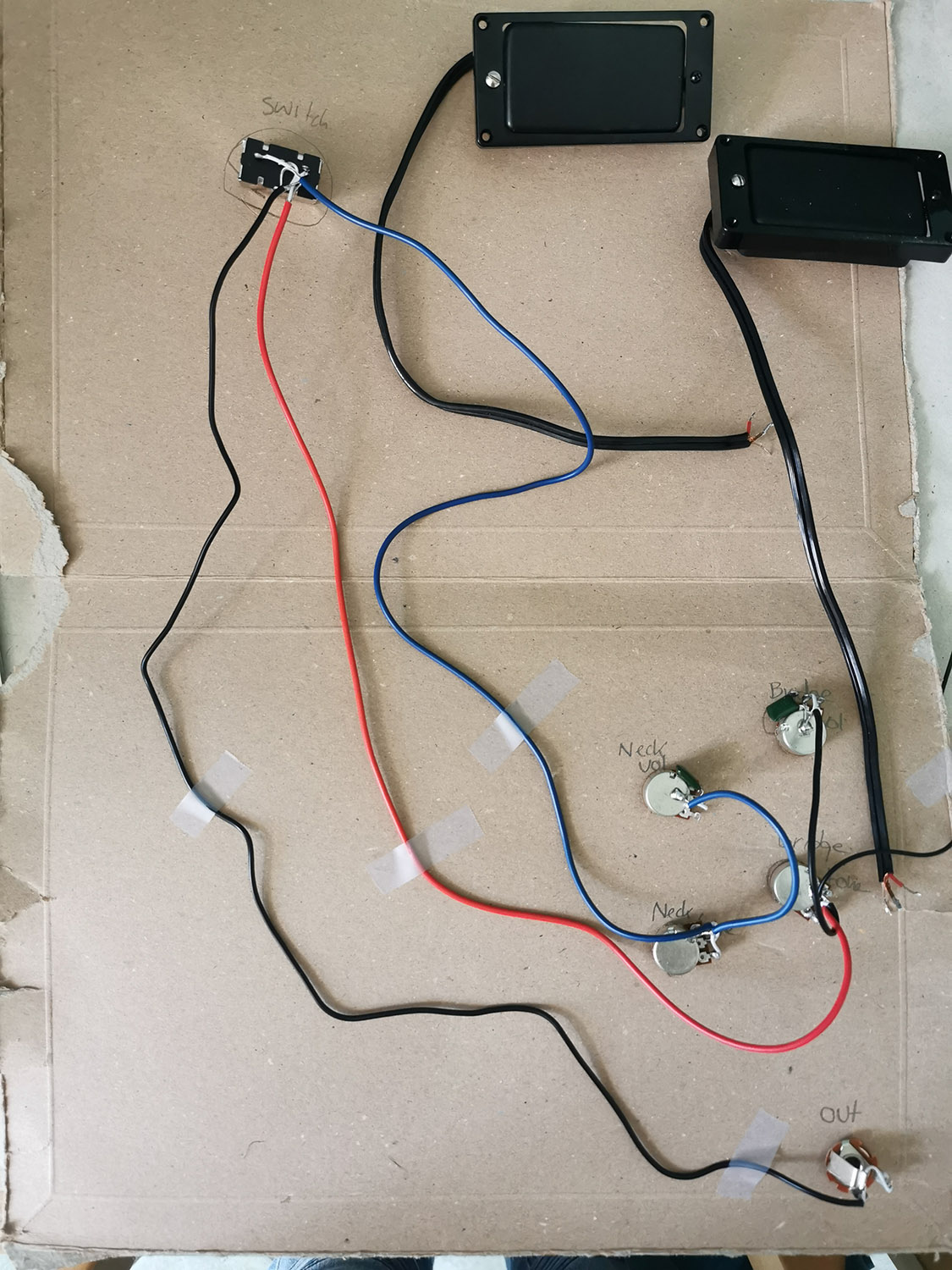

    So I decided to get a pair of vintage Humbuckers for this build (Les Paul style single cut kit). I don't know much about them, but they have more cables than the wiring diagram...
    I'm trying to stick to this diagram:
    https://www.pitbullguitars.com/wp-co...m4Pot%20v5.pdf
    And so far, it looks like this:

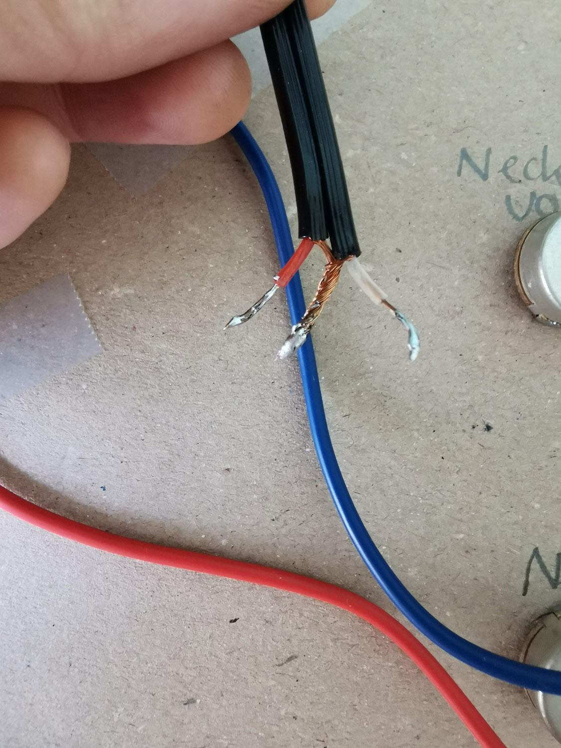

    But what am I supposed to do here? I guess red is hot and I can follow the diagram. But is the white cable ground or the drilled copper cables? What should I do with the one that is neither hot nor ground?

    Sorry for my dumb questions but I rather ask instead of accidentally build a bomb or something ;-)

    Have you got a multimeter? Measure the resistance between the braid wire and the red and the braid wire and the white and the red and the white wires. That will help us otherwise it's all guessing.

    OK, here is what the multimeter says:
    Neck pickup:
    Red - White: 0.621 kΩ
    Red - Copper: 1.001 MΩ
    White - Copper: 1.131 MΩ
    Bridge Pickup:
    Red - White: 0.627 kΩ
    Red - Copper: 1.141 MΩ
    White - Copper: 1.5 MΩ
    What would I have to do if these were active pickups?
    They certainly aren't passive pickups with those readings, so I'll say thet they are active. Are there any makers markings on the underside at all?
    You'd need to add a 9v battery, a TRS jack socket to switch the battery, and swap the pots out for 25k ohm ones. But without knowing whose pickups they were, I'd have to guess at how they are wired.
