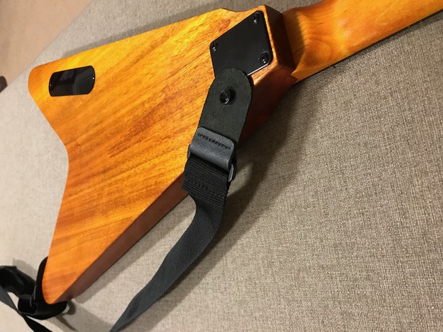

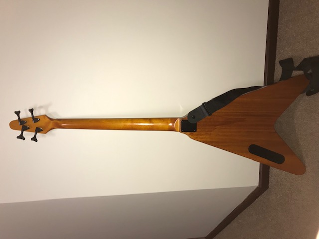

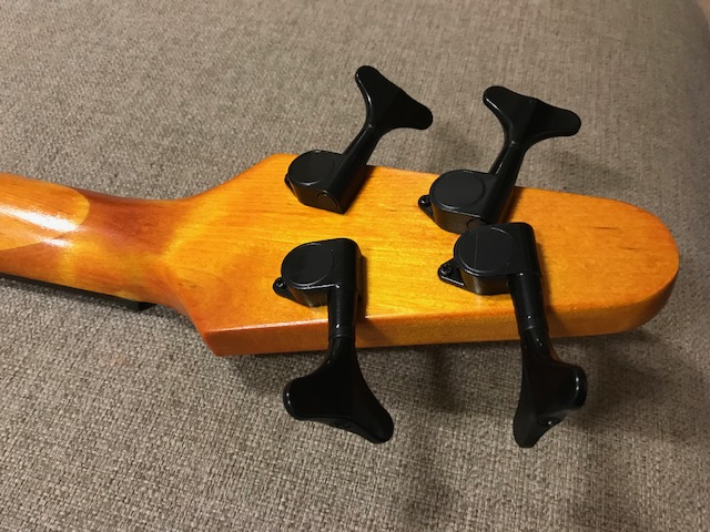

    Photos of the back.
ID:	36472   Click image for larger version.
ID:	36473   Click image for larger version.

    Hi, with regards to the Neck mounting plate there is a plastic plate and the metal plate. Is the plastic plate also meant to be used - or is it optional?
  8. #18
    Optional, but you'll probably find using just the metal plate will bruise the wood/finish a bit, that's the main reason for the black plastic.
  9. #19
    I'd say optional. I never use them. Fender don't. I'm not sure why they exist TBH.
    And the bass is looking good. Nice.
