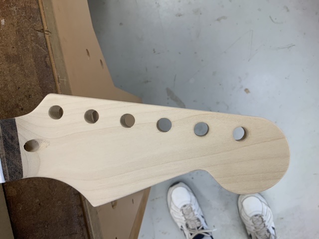

    1) I hit the headstock with 180 grit and 240 grit, and finally got some of the notches removed left over from some shoddy coping saw work when initially shaping the neck. End result looks good, but more sanding to come over the weekend.

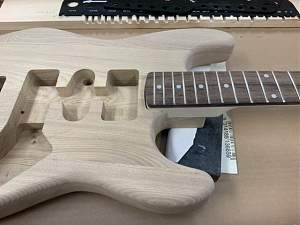

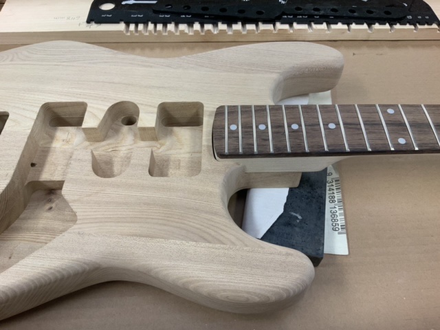

    2) The heel of the guitar neck did not fit the cavity of the body upon arrival. Forcing it would cause damage to the side of the cavity wall. I needed to sand. I took some 240 or 280 grit sandpaper, and with a sanding block I sanded away both sides of the cavity. I didn’t sand the bottom of the cavity. I also didn’t touch the heel of the neck with the sandpaper. I lightly sanded one side a few times, then the other side of the cavity...then i would try and fit the neck, and repeat the process until it fit. That way i ensured that i didn’t take too much material off one side of the cavity in relation to the other. End result, the neck fit with a very snug fit. Now onto continuing a dry fit and figuring out what on earth i need to do about where to set the neck in relation to the nut and the bridge. More research needed there.

    Weekend’s plan is to Dry Assemble, mark out that set out with some light pencil work, and hit the ST-1 guitar body with 140 grit and 280 grit using a bigger sanding block to try and not create waves in the timber.

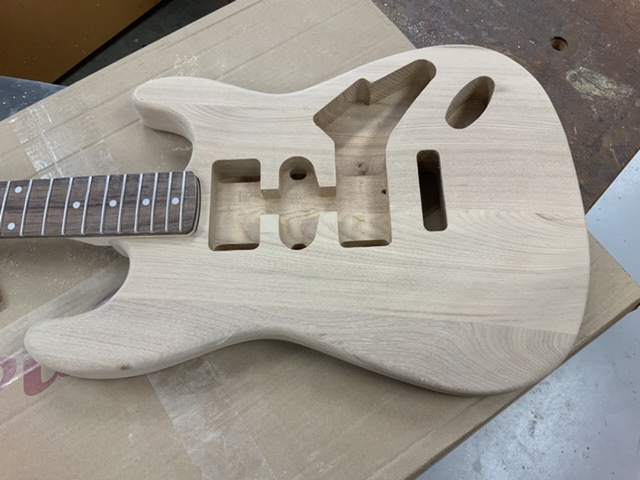

    I’ve sanded the entire body of the guitar down (minus the cavities) with P280 grit sandpaper, both with the grain, against the grain and in a cross section direction. I’ve also sanded the back of the guitar neck and the headstock to ensure that it has the same feel as the body.

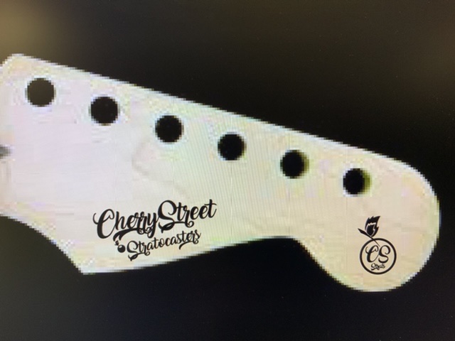

    I’ve also been playing with branding the guitar, and have tried various logos and fonts...would love some feedback on what you like, what you don’t like and what you see....often times I can get too close to the work and cannot see what others see.

    Still not 100% sold on the name and concept, but it was still far better than other options i had created and the name holds sentimental value.
    Just wanted to post this to show the various stages of my process and concurrent happenings both on the guitar and away from it.

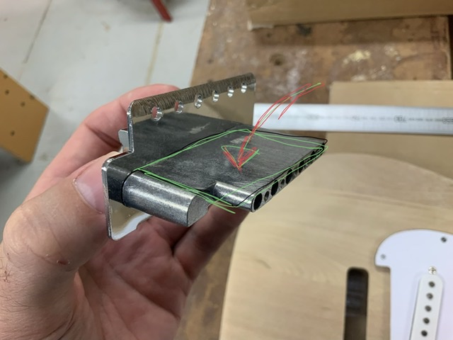

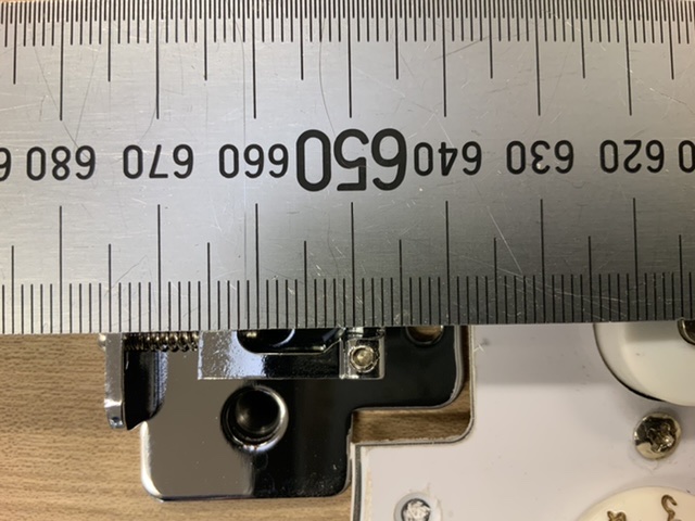

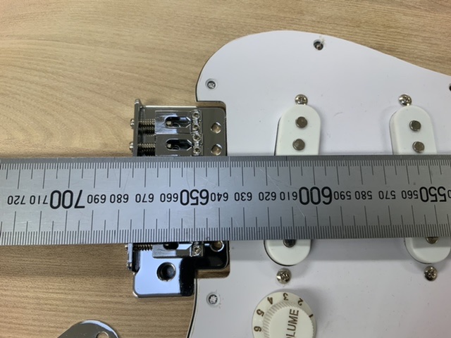

    1) I’ve set my ruler to run from the face of the nut all the way through my bridge, and I am looking at a 647mm distance. Do I need to have the bridge pushed up against the top of the cavity or do you sometimes screw the bridge on with clearance on all sides of the bridge not touching any part of the walls of the cavity? The parts of the bridge I refer to are the parts that will reside internally. Should the face showing be touching any part of the wall cavity?
    If I have it touch the wall cavity, then do i retract the springs on the high E string to get it to 648mm?
    I’ve taken a series of photos, one with the bridge floating in the cavity at 647mm, another with the bridge pushed forward touching the wall cavity and the measurement being less, and another with the bridge pushed back...

    2) How do i make sure my placement of the bridge is correct before drilling the holes and screwing it into the body? Should i move the high E bridge pin completely forward, move the bridge so its 648mm, and then drill and screw it in the there? Or should i be making the bridge sit flush with the pick guard cover and rearranging the high E pin backwards to meet 648mm?
    My assumption is that i should attach the pick guard, then attach the bridge so that it has a cohesive look in relation to the pick guard, then adjust the pins...but i want to ensure i am setting up the bridge correctly to avoid unwanted vibrations etc if i make a mistake in this setup.
    Thanks!
