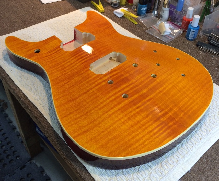

    FWIW, I used Angelus Leather Dyes on my PRS-1TS kit and was happy with the result as well as the process.
    I'm sure you're already aware, but I'll mention it anyway, Tru Oil is notorious for turning blues to green over time.
    It's well documented here and other forums. Hopefully you won't be surprised or disappointed if this happens with yours.
    This is an in-progress photo of my build from 2018. Analine dye and about 8 coats of Tru Oil (IIRC):
Name:	Prelim finish crop.jpg
