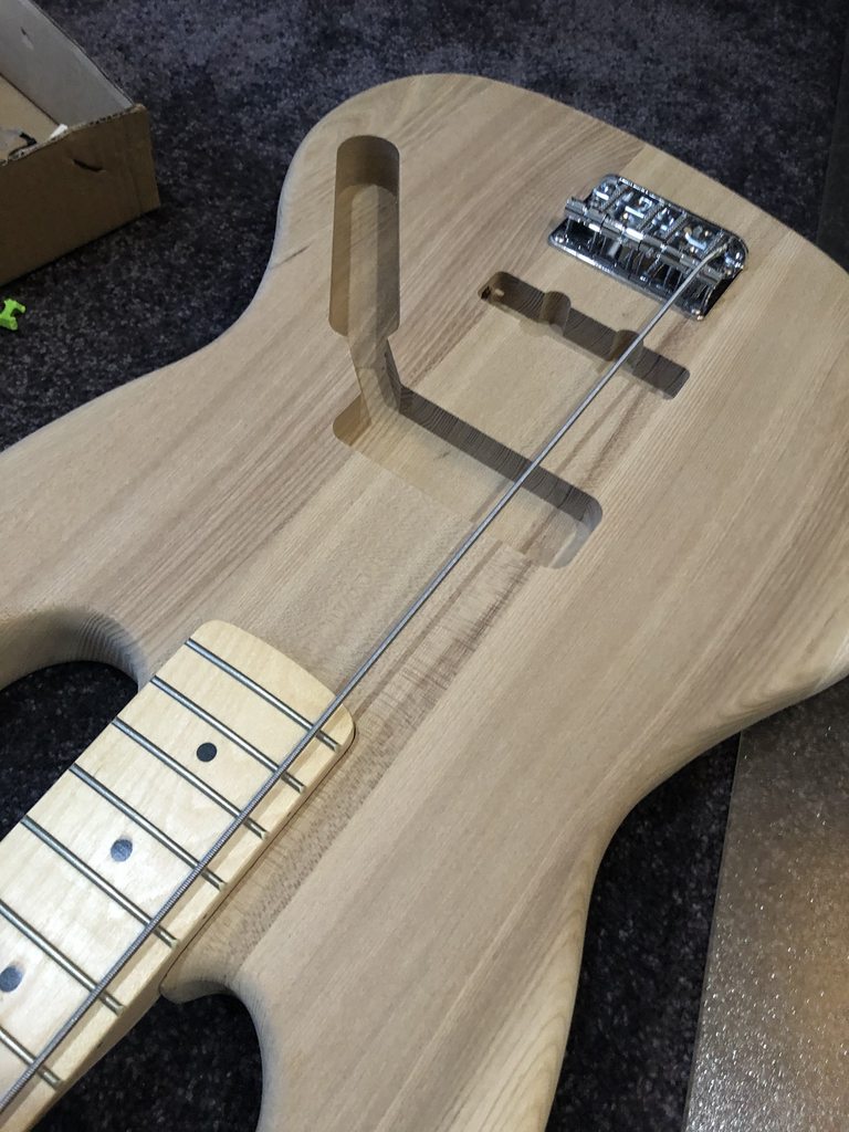

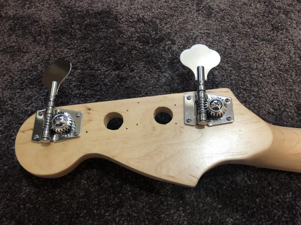

    I decided after doing this that i should have done more of a build with the bridge, machine heads etc in place as per the instructions so I stopped with the neck varnish and put the bridge on. The process was fairly simple though nerve-wracking. I didn't want to stuff it up and have unnecessary holes in the body!
    After the bridge and heads were in place i put the top and bottom strings on to see how I went. I have to say I'm pretty pleased with the results. Perfect? Nah. But very happy with it for my first build!

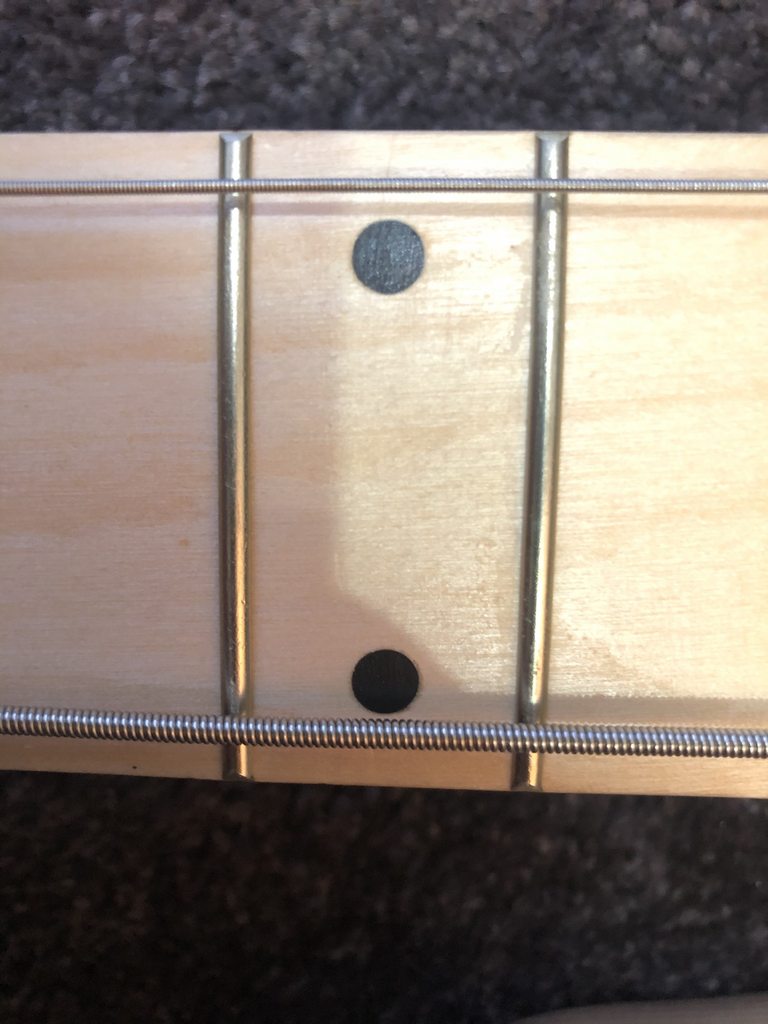

    Can see below here how the E string is a little further in than the G string (assuming the fret markers are in the right spots!) but not by much.

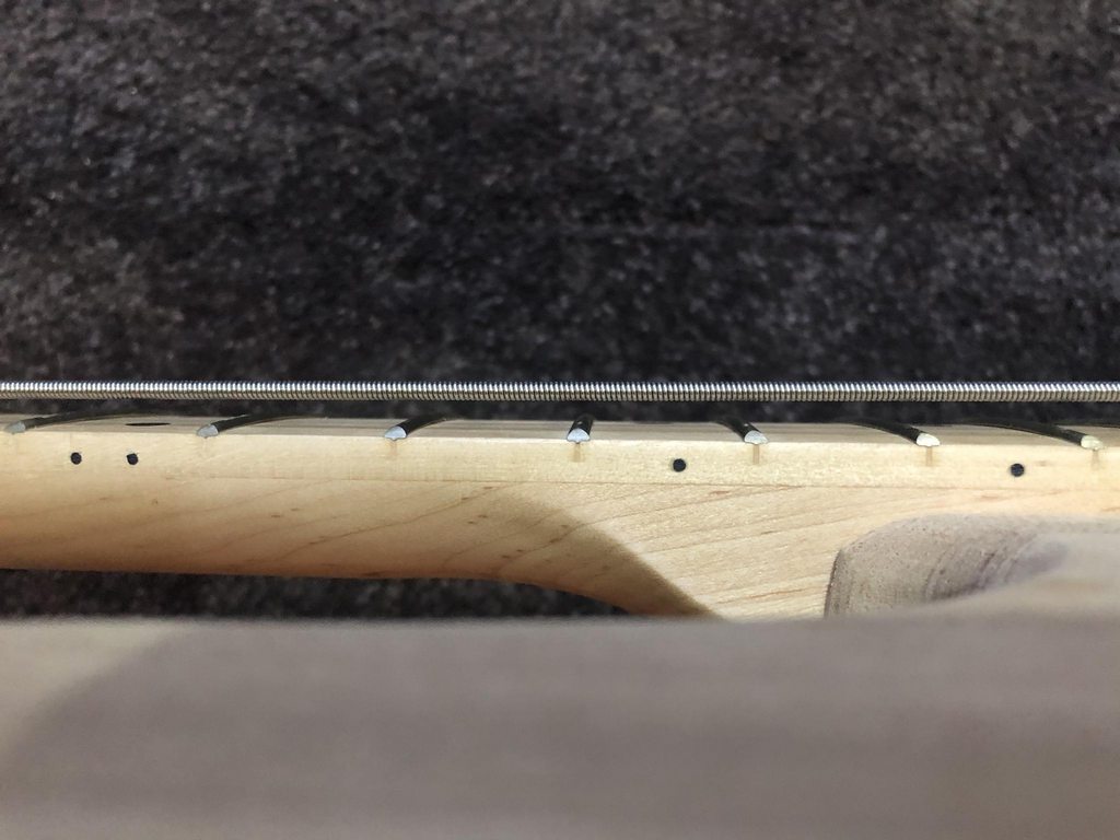

    And the action is not too bad at the 12th/15th fret - though adjustments can come later:

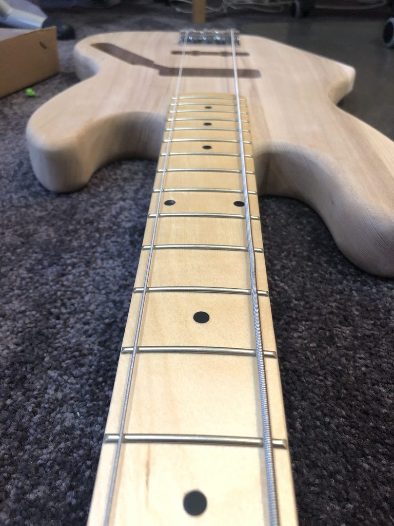

    After putting it together like this I could see a lot better how nice I think the neck is turning out compared to the raw body, so i took a couple of extra photos of that

    Don't forget the string thickness and that the E is a lot thicker than the G. Distance from each string to the edge of the board looks fairly equal. So the spacing looks fine to me.
    I'd probably stop at 5-6 coats of the satin varnish, especially if you've been sanding a bit after each coat.
    Looks good to me as well
