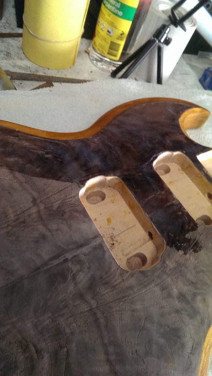

    The veneer had a few ripples in it so my bro in law said to use a damp cloth over the top and use a steam iron to flatten them out, he said i can do that because i used a water based glue.
    It worked a treat. because i didnt have many clamps i screwed some timbers to the roof of the shed, cut timbers and after putting a piece of melamine over the top, used the timber as braces.
    Attachment 14665
    After all was dry i checked the surface, some small cracks had appeared and the middle join was slightly opened. I used superglue and some walnut dust to fill the middle join.
Name:	IMAG2818 (Copy).jpg

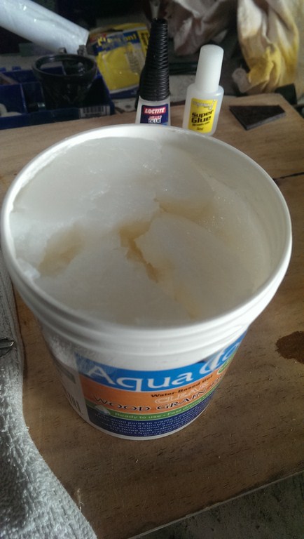

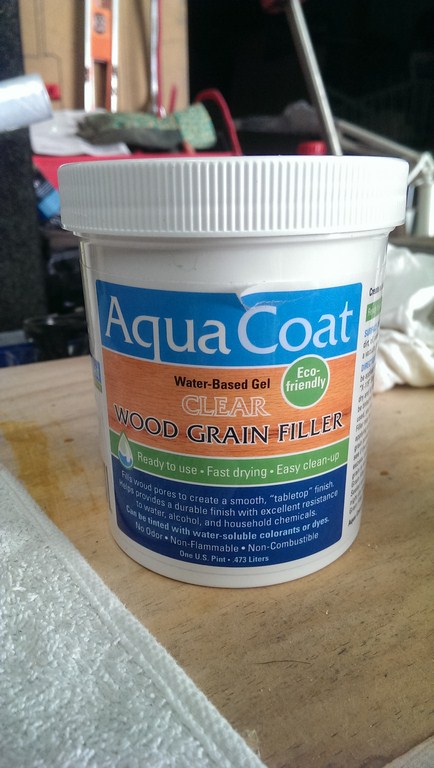

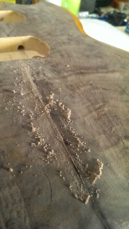

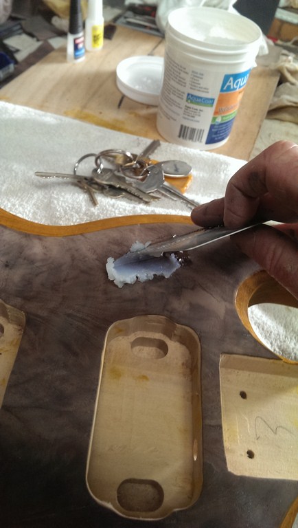

    With this guitar i want it to retain all the grain features, cracks, dents and undulations but at the same time look flat and smooth. To do this i looked round for a clear grain filler and found one from America but i got it from an Australian supplier.
Name:	IMAG2815 (Copy).jpg
ID:	14668 Click image for larger version.
Name:	IMAG2819 (Copy).jpg
ID:	14669 Click image for larger version.
Name:	IMAG2820 (Copy).jpg
    Its crystal clear, non toxic, water based and can be sanded in a few hours after application. You can then put any product over the top. Water based clears, Thinners based, nitro, 1k or 2K, poly or turps based.

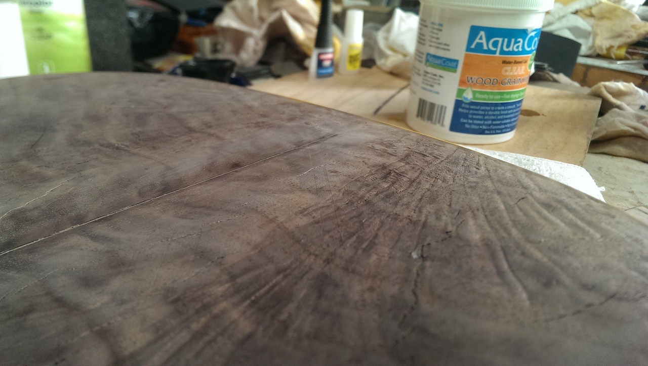

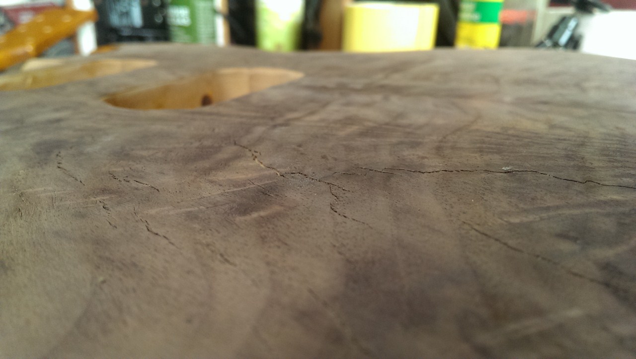

    Top of veneer showing cracks
Name:	IMAG2816 (Copy).jpg
ID:	14671 Click image for larger version.
Name:	IMAG2817 (Copy).jpg

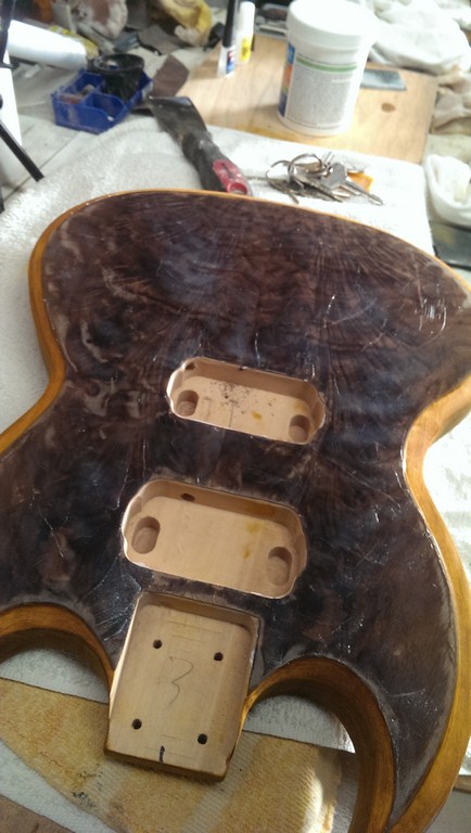

    1st coat applied with a credit card, a little goes a long way.
Name:	IMAG2821 (Copy).jpg
ID:	14673 Click image for larger version.
Name:	IMAG2822 (Copy).jpg
ID:	14674 Click image for larger version.
Name:	IMAG2823 (Copy).jpg

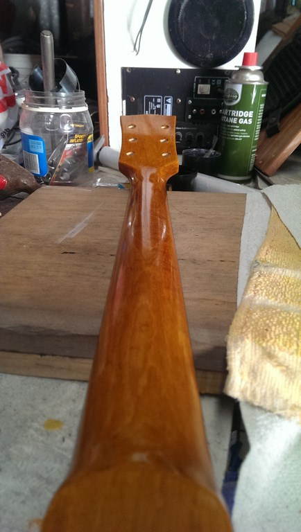

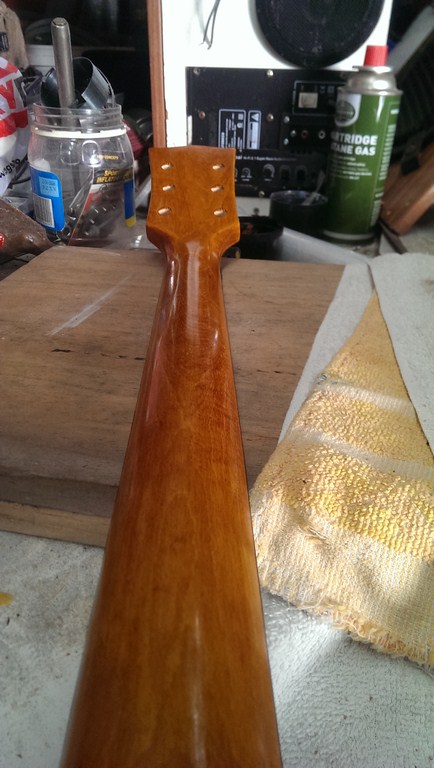

    4th coat of wipe on poly to the neck
Name:	IMAG2824 (Copy).jpg
ID:	14676 Click image for larger version.
Name:	IMAG2825 (Copy).jpg
  10. #190
    looking sweet as Nitro, that neck is looking pretty shiny after 4 coats, are those pics after it's cured or just applied ?
