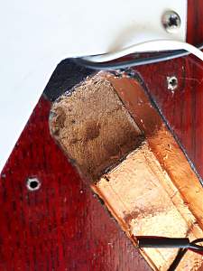

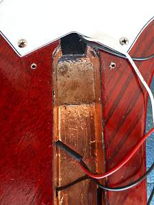

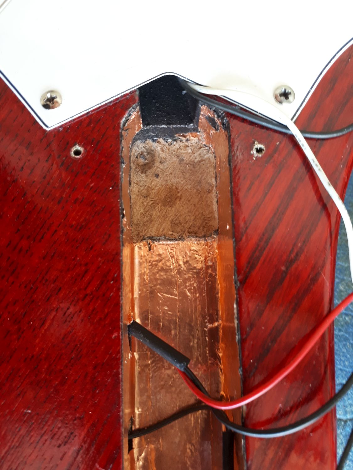

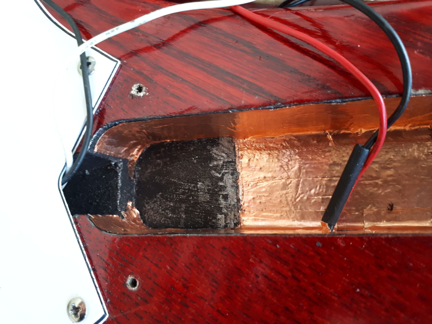

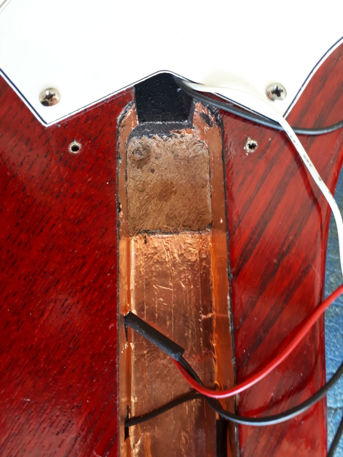

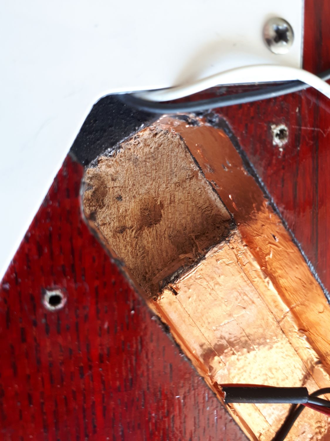

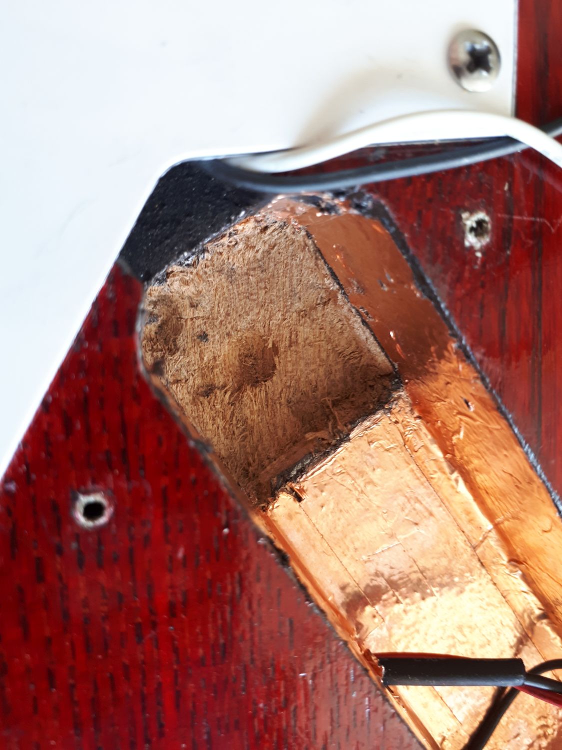

    Time to lower the control cavity floor under the oversized push pull switch...
Name:	2018-02-18 10.55.10.jpg
ID:	24876Click image for larger version.
Name:	2018-02-18 10.55.25.jpg
ID:	24877Click image for larger version.
Name:	2018-02-18 11.05.55.jpg
ID:	24878Click image for larger version.
Name:	2018-02-18 11.06.06.jpg
ID:	24879Click image for larger version.
Name:	Wiring diagram.jpg
    Tested everything outside the body and seemed to work but once I screwed down control plate the Bridge PUP Volume Control no longer works? Probably pinched a wire and will have to dive in again to sort that out some other day.

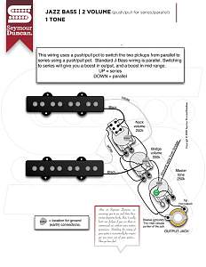

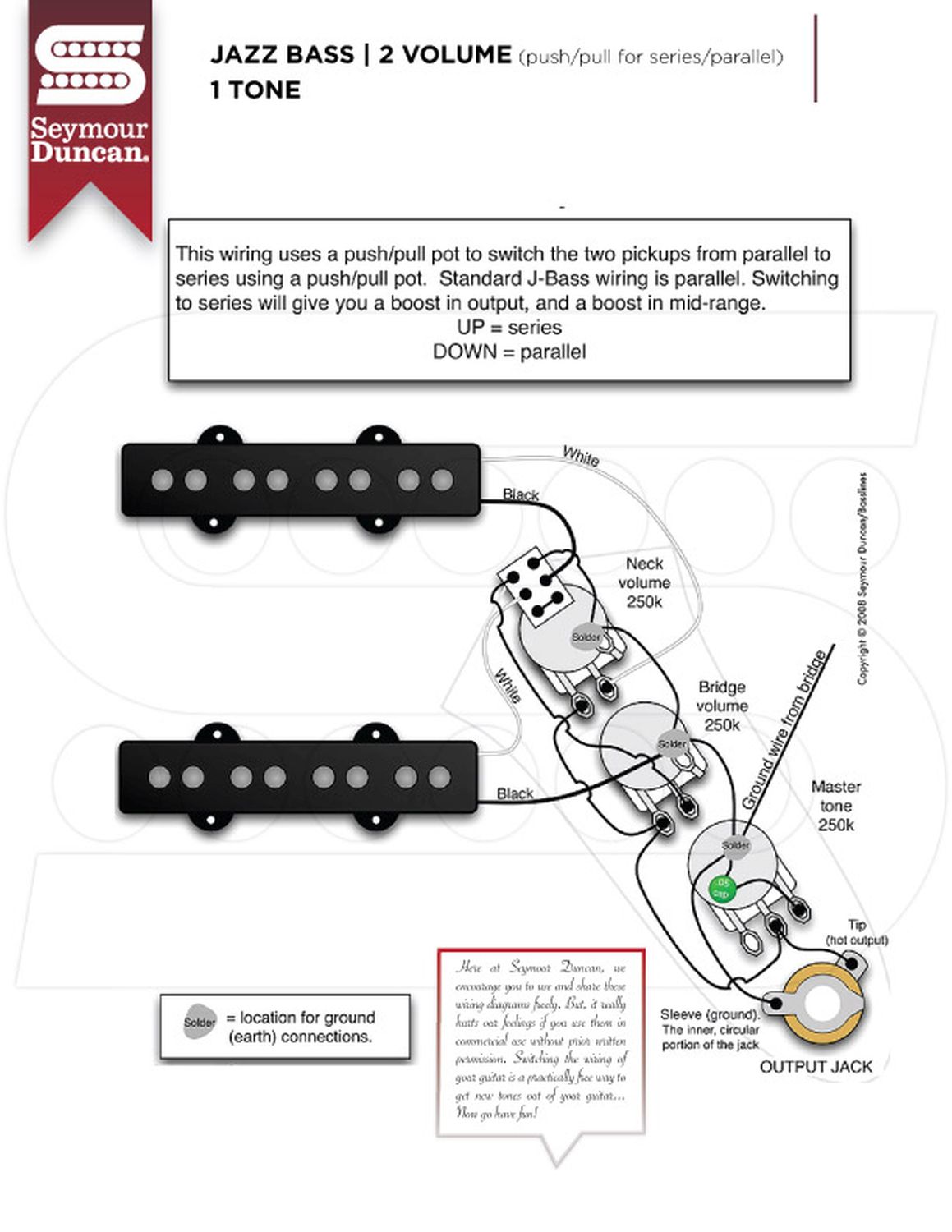

    Posted the wiring diagram for anybody wanting to have a go as it does make a significant difference and produces another very useable phat sound.
    Once the Bridge Volume control has been rectified may get around to doing a sound demo video.
  2. #182
    I'm guessing that either one of the solder lugs on the volume pot is shorting-out to the copper foil shielding, or, the bridge pickup is shorting-out to ground somewhere when you screw down the control plate, you can fix that by putting some electrical tape on the shielding, hope that helps.
  3. #183
    Thanks Doc. Probably a dodgy earth wire somewhere and hopefully easy to find and fix.

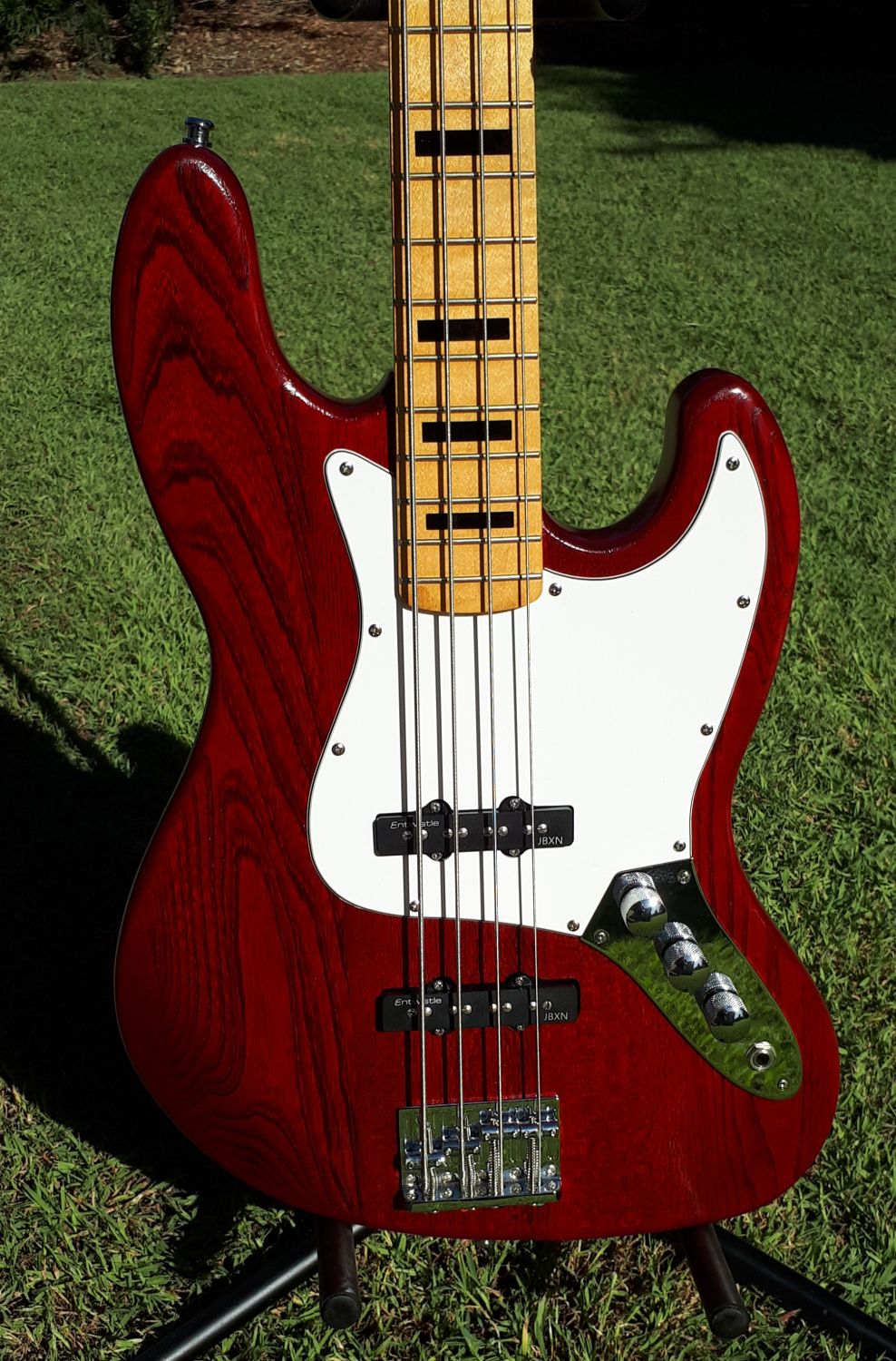

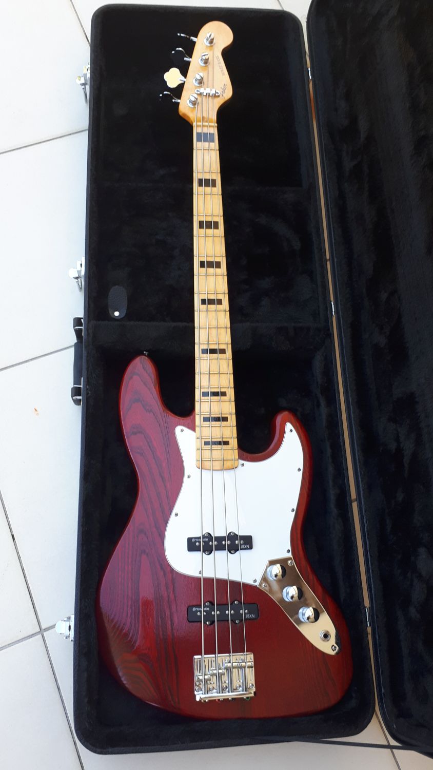

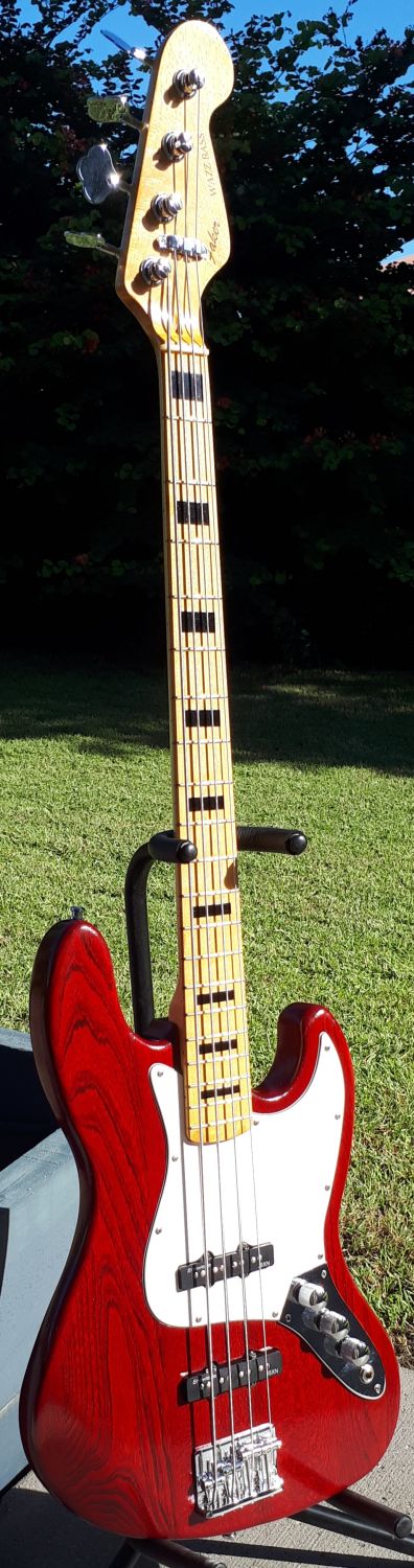

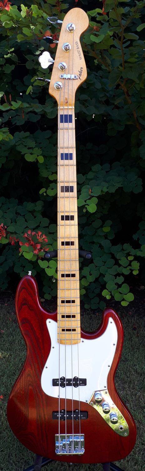

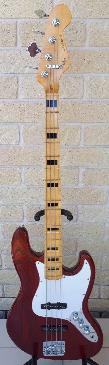

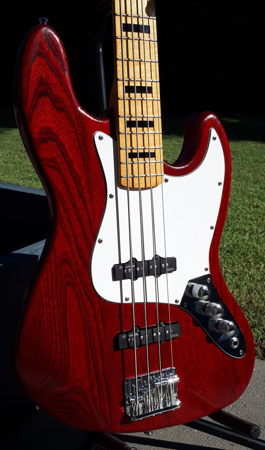

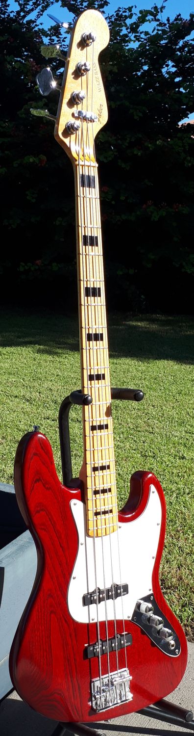

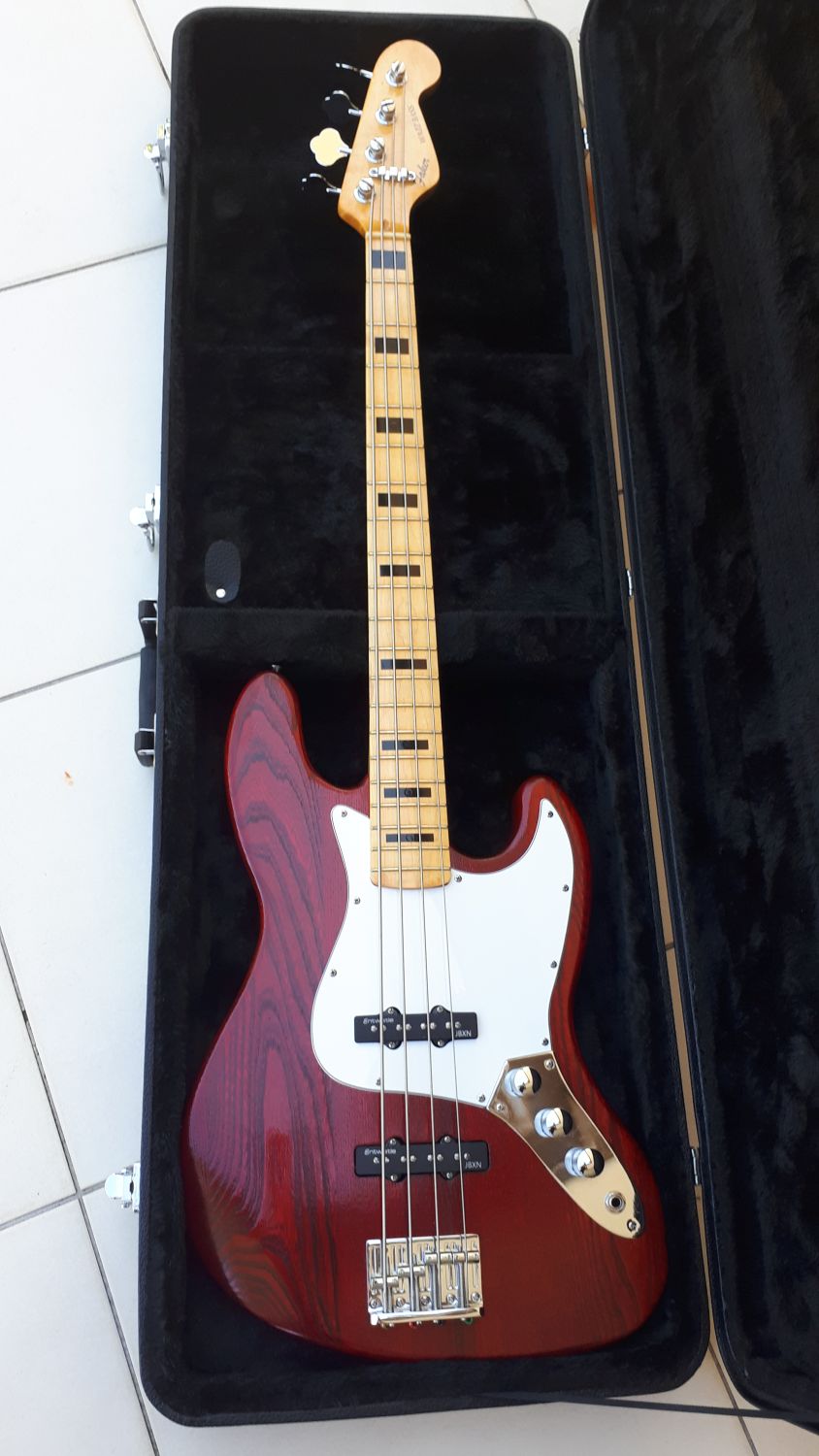

    4 and half years later......here are some shots to show how the natural TO ageing effect has turned out.
    Quite noticeable on the maple neck & fretboard and now and really nice deep & rich colour.....
ID:	39117Click image for larger version.
ID:	39118Click image for larger version.
ID:	39119Click image for larger version.
    Different light and backgrounds throws up a differing depth of colour.

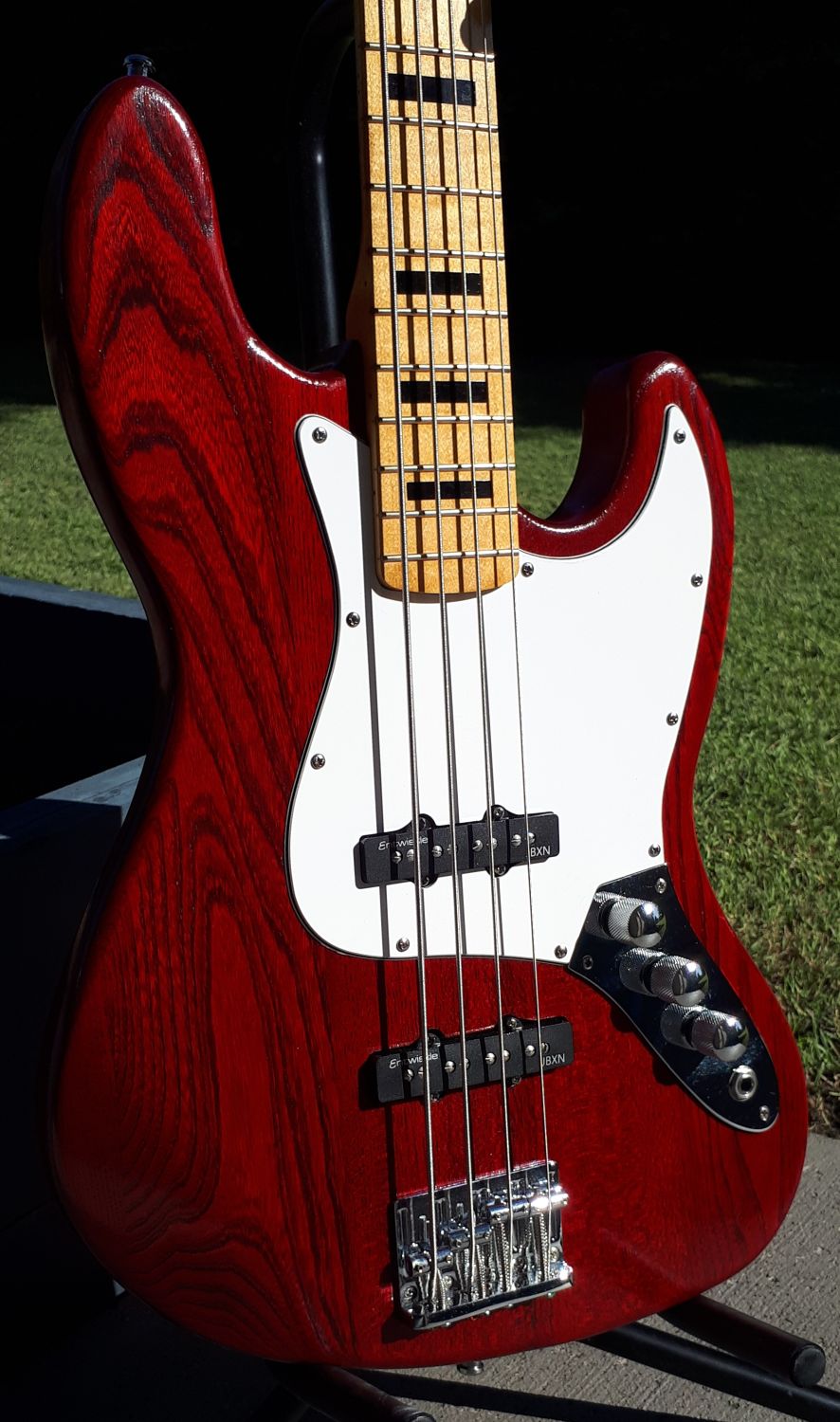

  8. #188
    Couple of close ups...
