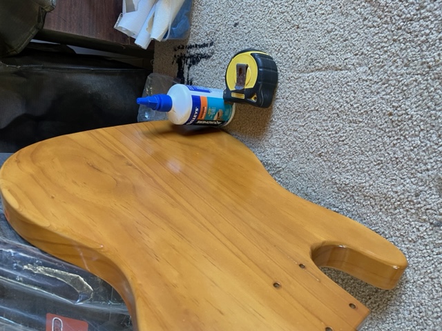

    The neck and body have rested for 2 weeks, so should be well and truly cured.
    I rubbed down the w/b poly satin neck with a very fine Scotchbrite pad.
    The body and the headstock (w/b poly gloss) were wet sanded with 1200g, 1500g, and 2000 g. I then applied Kustom Creations Kustom Grit step 1 (cutting compound) by hand, and step 2 using a Random Orbital Polisher and micro-fibre pad (I will need to get some foam pads for it!). I then applied Maguire’s Scratch X with the Polisher and micro-fibre cloth. Final polish with wool pad on the Polisher. They have polished up much better than any of my other builds.
    The first picture is with no polish, second after cutting compound, third after Scratch X.
ID:	44887   Click image for larger version.
ID:	44888   Click image for larger version.
