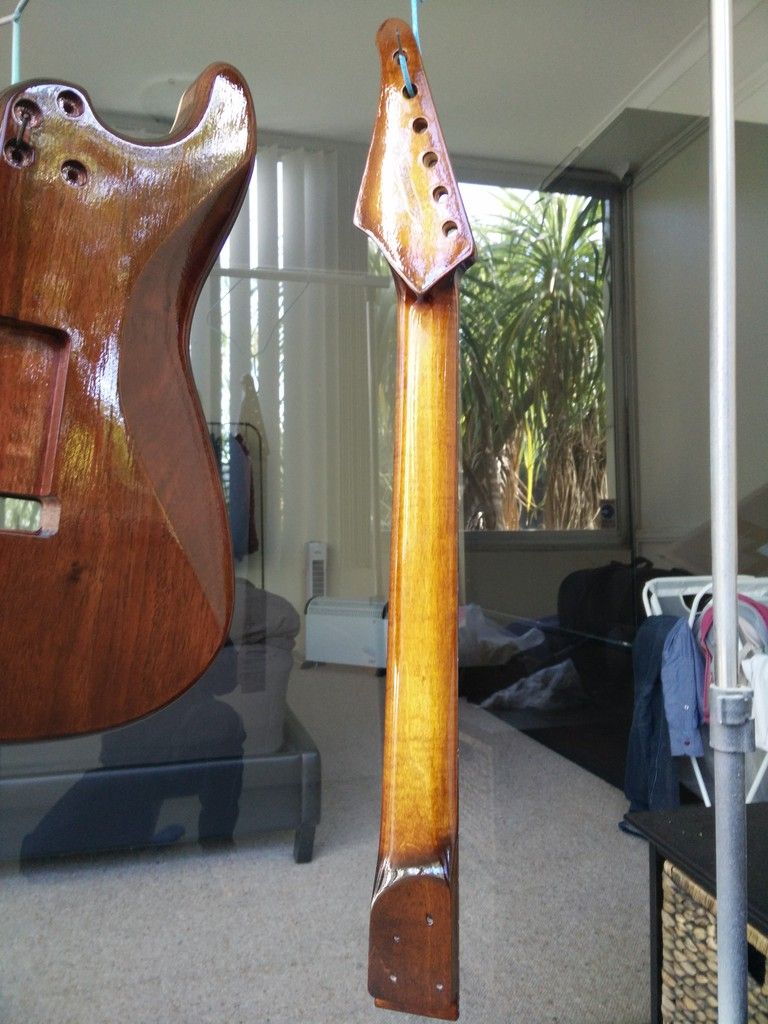

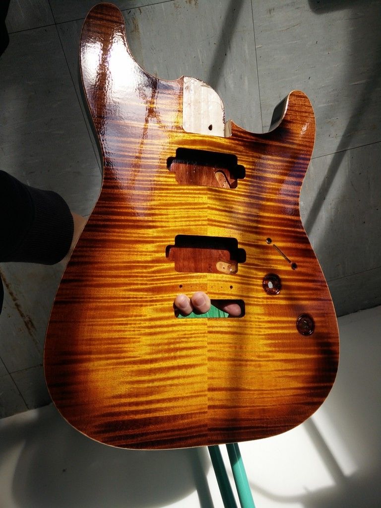

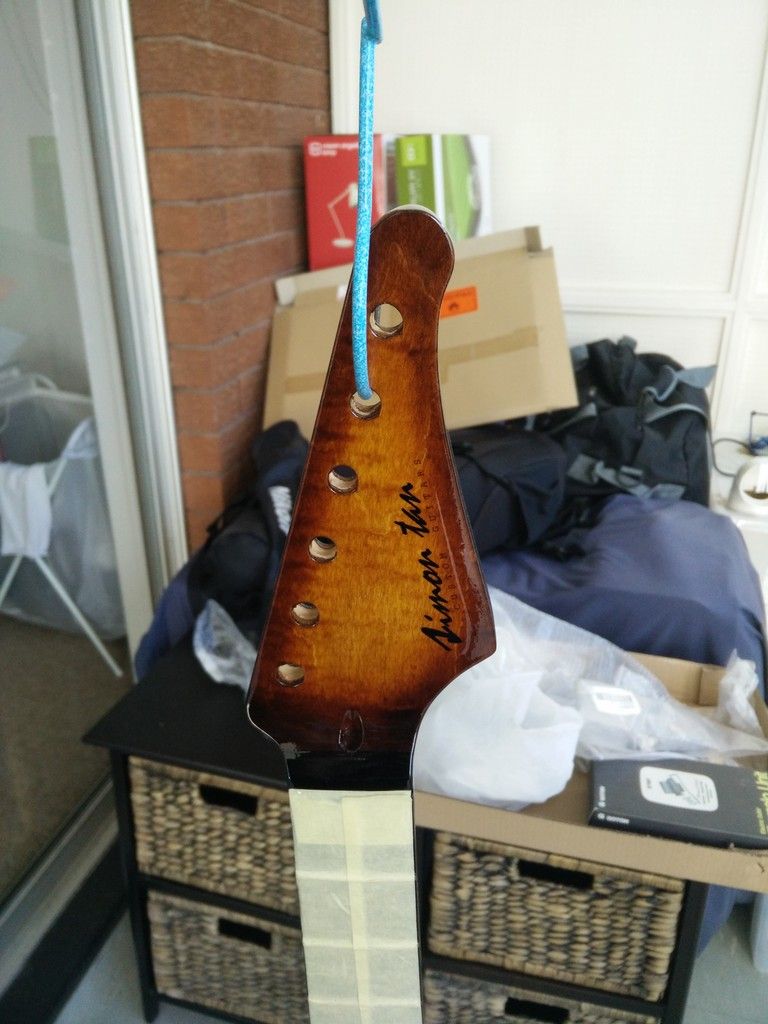

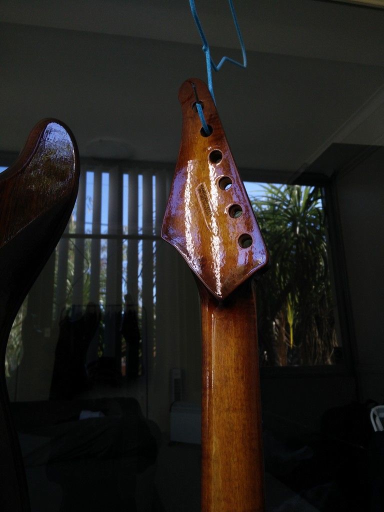

    Ok the weather has been kind to me the past few days, so I managed to complete all the clear coats. I used a total of 3.5x400ml cans of clear and from past experience that should be more than enough. I normally used 3 of the same cans for previous projects, but hopefully this is enough and I won't get sand throughs!
    Now I'll have to wait minimum of 2 weeks, but I'll wait till I finish my next project. By then it should be sufficiently cured.

    Lots of sanding to go, but jeez that thing looks fantastic.
  7. #177
    Yes I hate sanding.
  8. #178

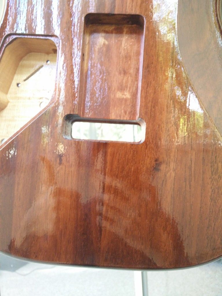

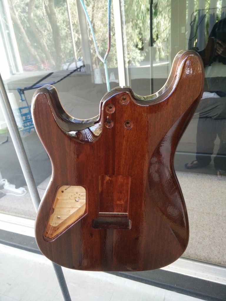

    looking unreal Simon, are you putting a tremelo spring cover on and if so you haven't recessed the cover ?
    good luck with the sanding in 2 weeks !
    The 2nd last photo are you giving the thumbs up in the reflection ? fair enough !

    Woks I thought of doing a recessed but it turns out my bridge trem block is too deep so the springs would hit the plate. It should be alright if I were to make it floating but I'll see later on. Might end up with no cover at all.
    And yes that's a thumbs up!
  10. #180
    fair enough Simon, I'd probably just leave the cover off the tremelo cavity then, looks rock n roll !
