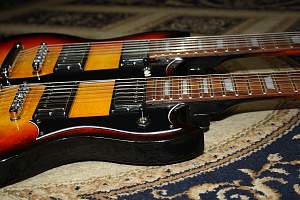

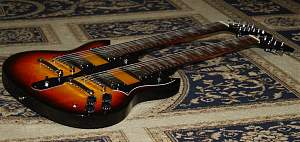

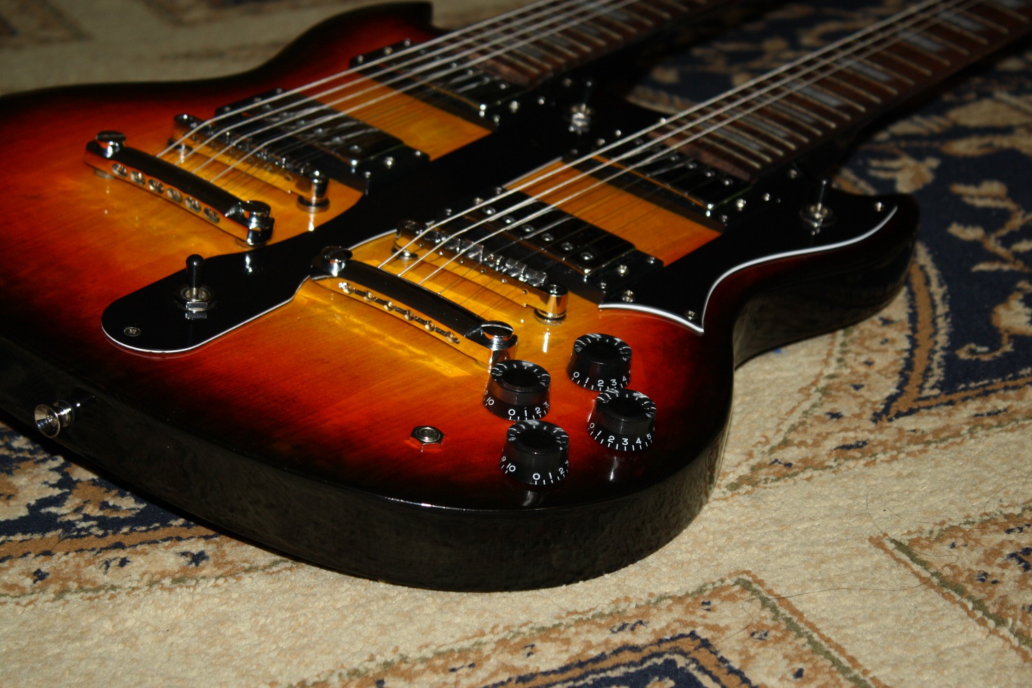

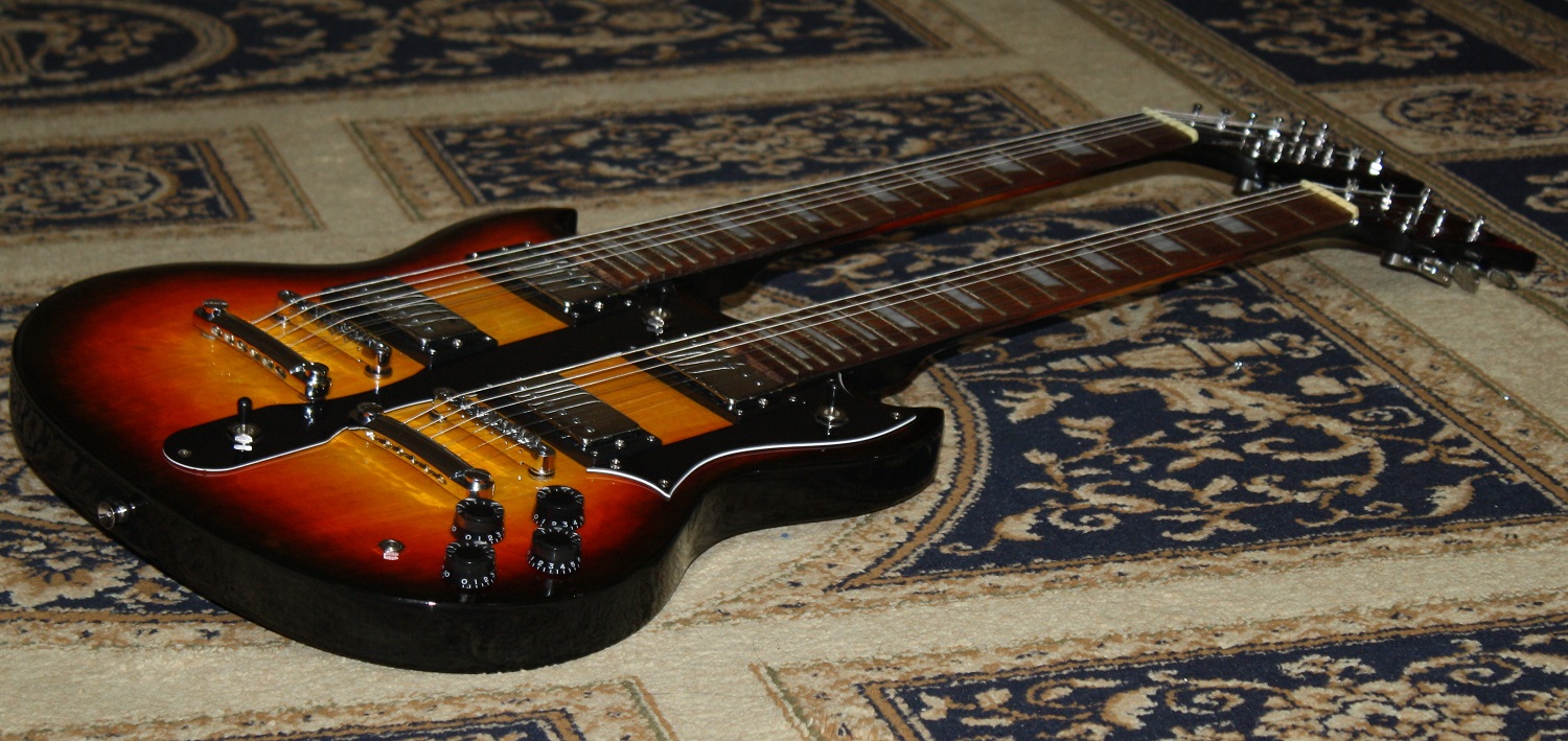

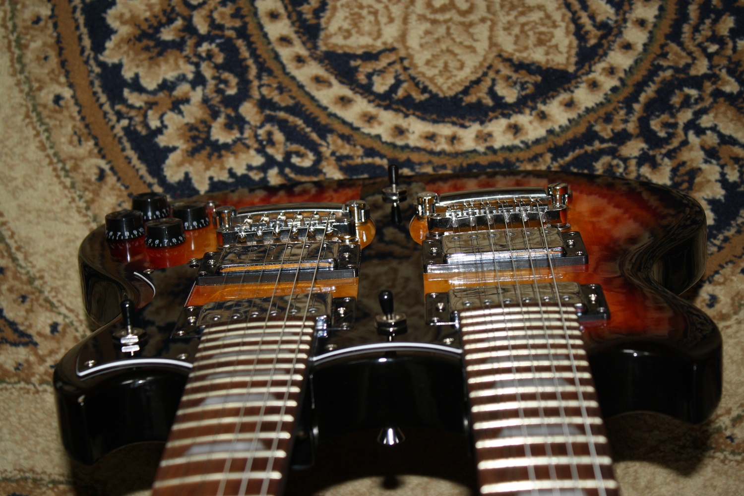

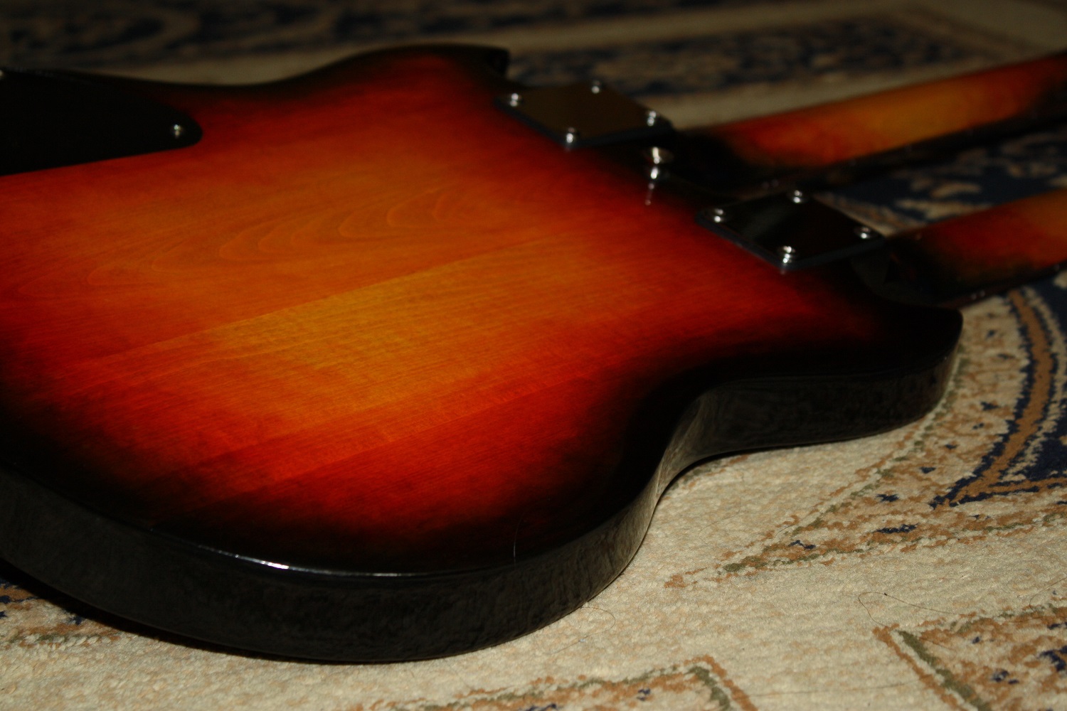

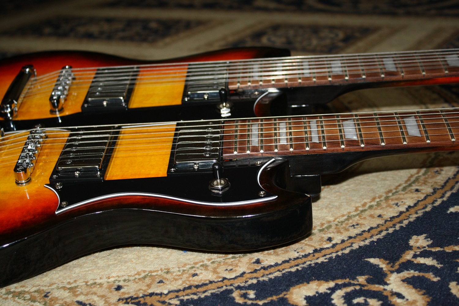

    Finished
    minor tweaking and intonation needed
    Well this is one of my better online purchases I have performed whilst intoxicated. It kept me busy for 9 months and 11 days!
    A couple of things:
    - This kit is completely PBG stock EXCEPT I pulled apart the pickups swapped the ceramic magnet with alnico 5's and wax potted them. - It has all the other Chinese parts and electrics installed in it, including the strings, which are being a bit temperamental.
    - I used Brendan's wiring diagram, which worked perfectly! http://www.pitbullguitars.com/wiring-diagrams/
    - If you are considering this kit, you will need to plug the existing jack hole and drill a new one.
    - If you are considering a Dingotone burst....do it! take note: Blackstump on Basswood body is uniform with the maple neck!
    - it is finished with Tru oil - sorry DB; and
    - it weighs 4.5 kg (or 9.9 lbs)
    I hope I have inspired Wokks to finish his purple monster.

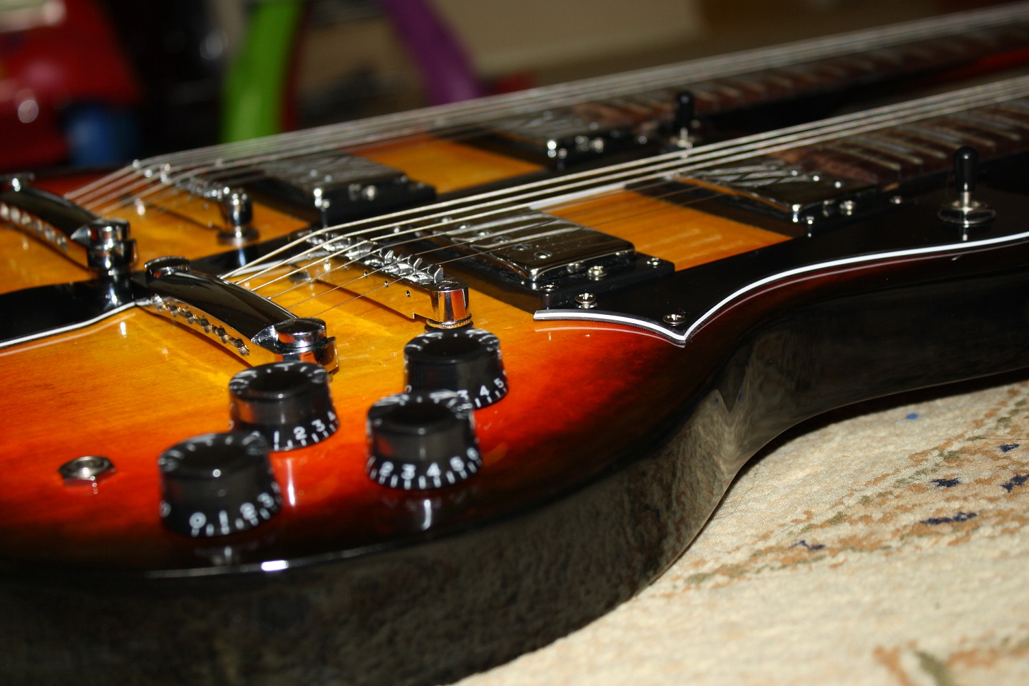

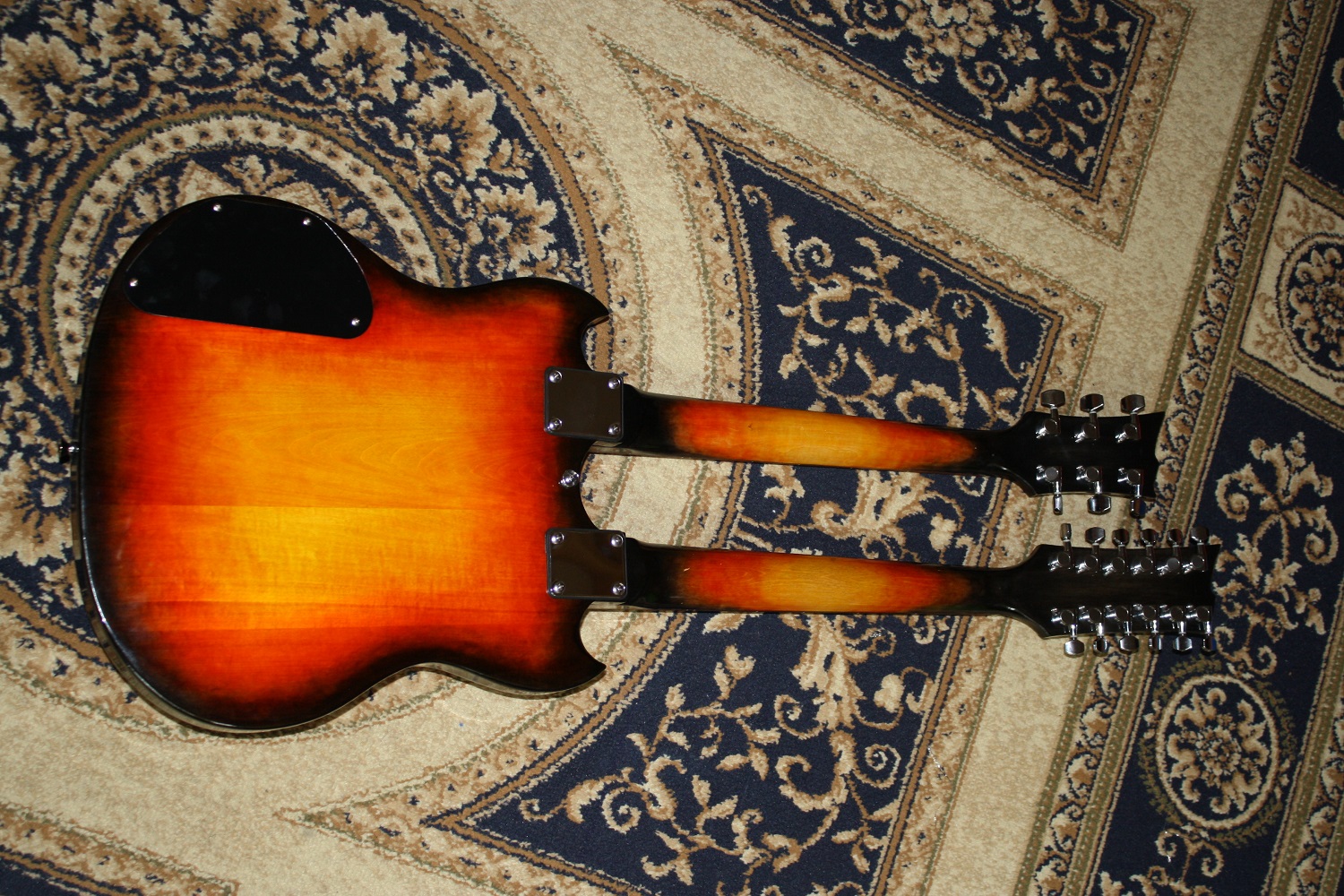

    a few more

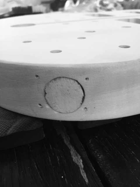

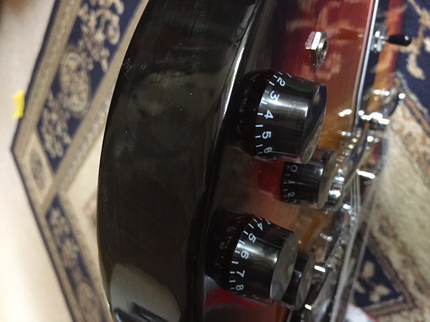

    I should post one more photo as it related to questions some people had about dingotone.
    This is a photo of the jackhole I plugged with a but of pine and some neutral timbermate. after 3 - 4 stain coats and 3 -4 costs of intensifier of Dingotone black stump, I almost cannot see it!
