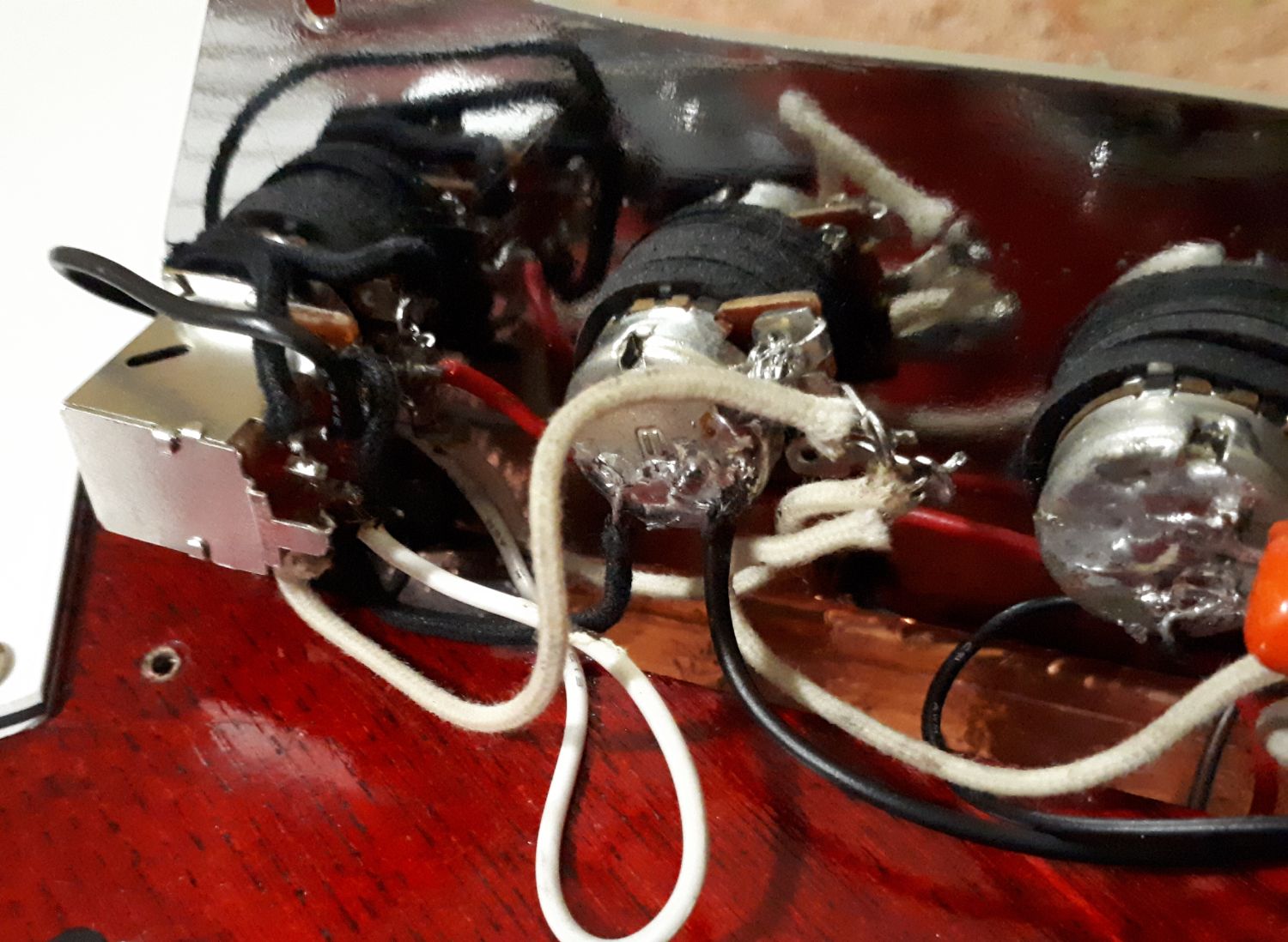

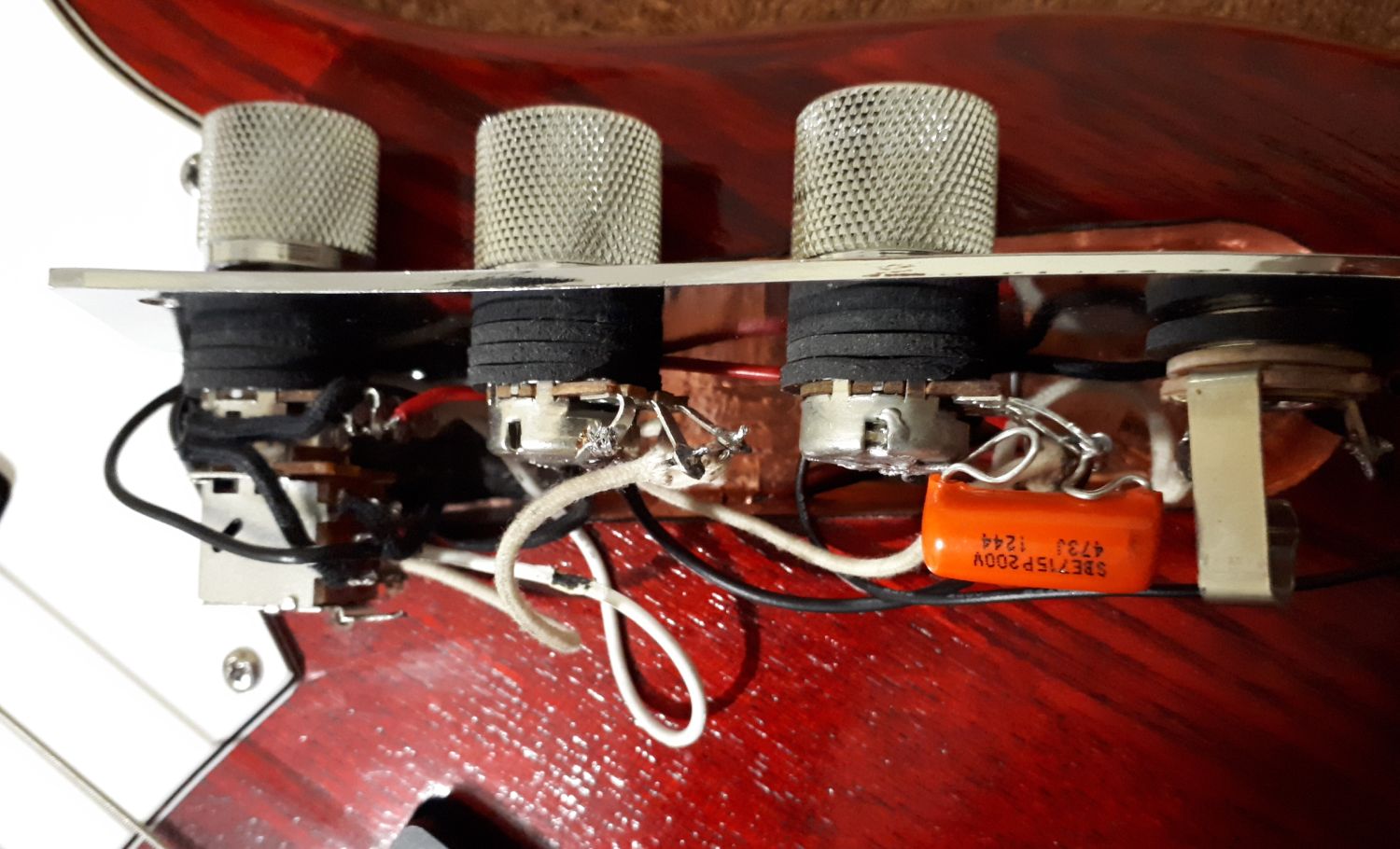

    250k push/pull switch arrived a few days ago and after a swim at the beach this afternoon it was cool enough to get the soldering iron out tonight and that part of the job is now all done....
Name:	2018-02-17 21.35.29.jpg
ID:	24857Click image for larger version.
Name:	2018-02-17 21.35.37.jpg
    Something I should have checked before starting was how deep the push/pull switch was.....
Name:	2018-02-17 21.36.06.jpg
ID:	24859Click image for larger version.
Name:	2018-02-17 21.36.19.jpg

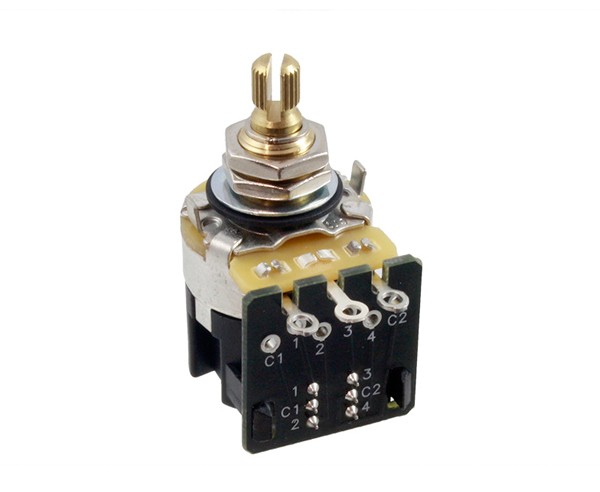

    Looks like I will need to dig out up to 5 mm underneath that pot in the control cavity to make things fit? Yet another job to try and get done tomorrow.
    For anybody else contemplating this mod I would suggest buying the shorter CTS one like this example...
    https://www.realparts.com.au/electro...-pull-pot.html
  8. #178
    A shame it's so long.
    Just worth checking the thickness of the wood at the bottom of the cavity. You've probably got around 10mm, but you don't want to dig out 5mm and find you break on through to the other side.
  9. #179
    You are dead right Simon as there is about 10 mm or so to work with.
