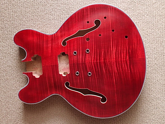

    Took the body back with 600 wet and dry soaked for a while in water with a lil bit of detergent in it then sanded back, wiped down used some naptha then gave it another gob full of poly

    Mentor FredA's Avatar
    Sep 2015
    Surry Hills, NSW
    500
    Looking very very very nice Tony!
    You're almost making me regret going natural on mine!

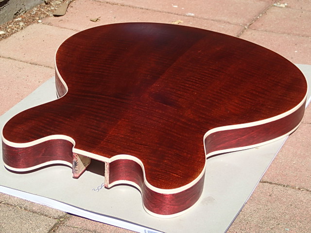

    Had a bit of time to put some finish on the back and sides, lots to go yet.
    A very nice drying day here, this can go and hang up for 24 hours, then the top will get another coat.

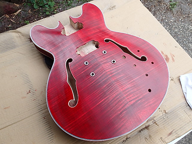

    Another coat on the top, a few more then i will start to buff it out.
    I have decided the pickups that are going in it are out of my Blacktop Telecaster (Duncan Design Made In China around the 12k mark) and the new Lawrence L90's can go in the tele blacktop.
    The tops wringing wet but we are getting there, hopefully after Easter the neck can go on

    looking excellent Tony I love the colour and the flames popping
