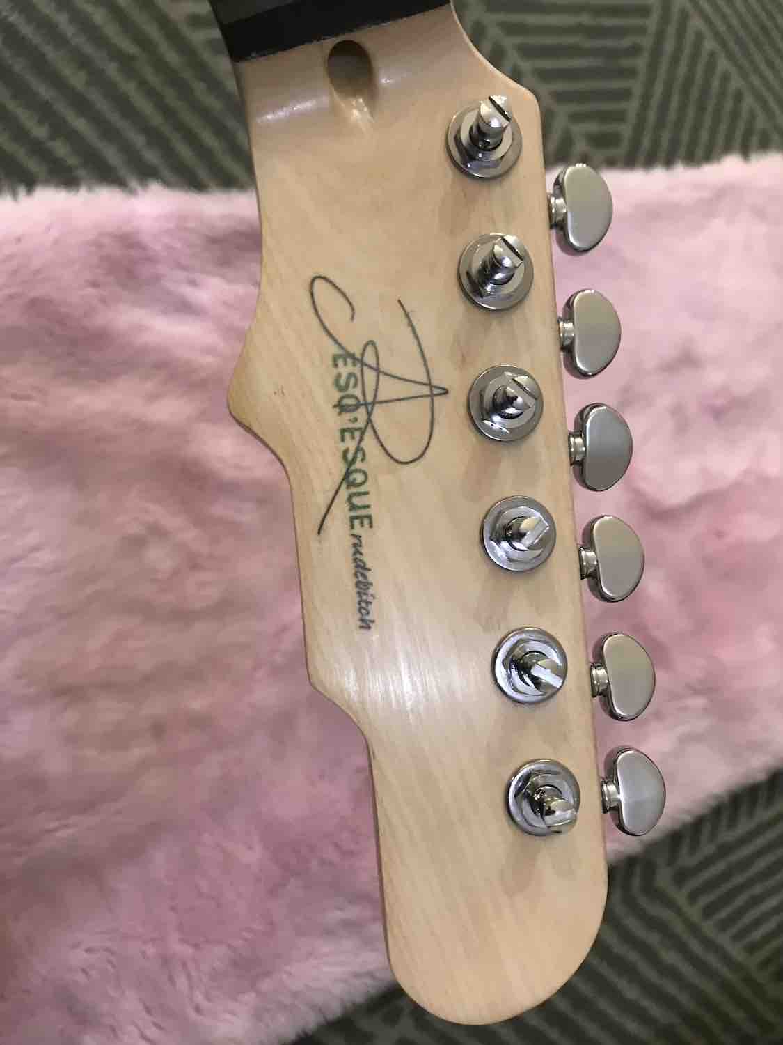

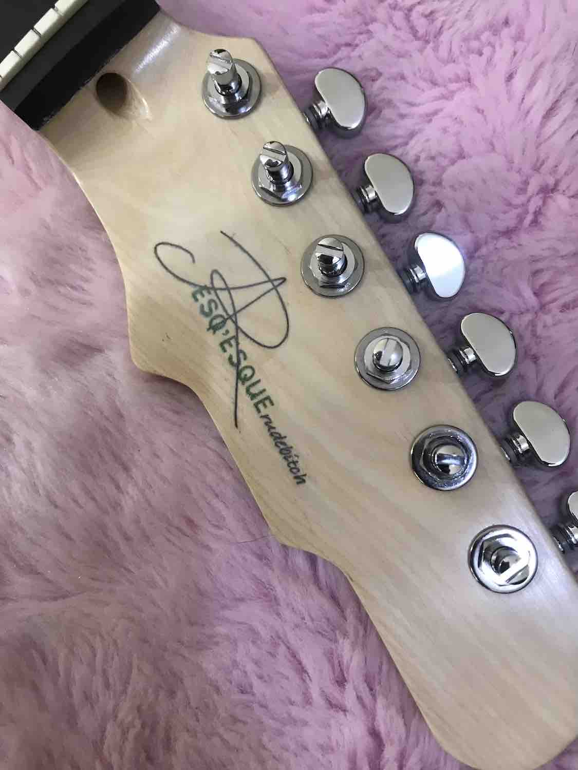

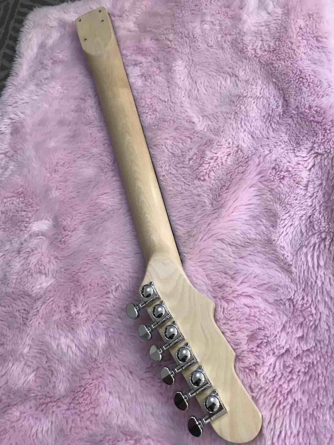

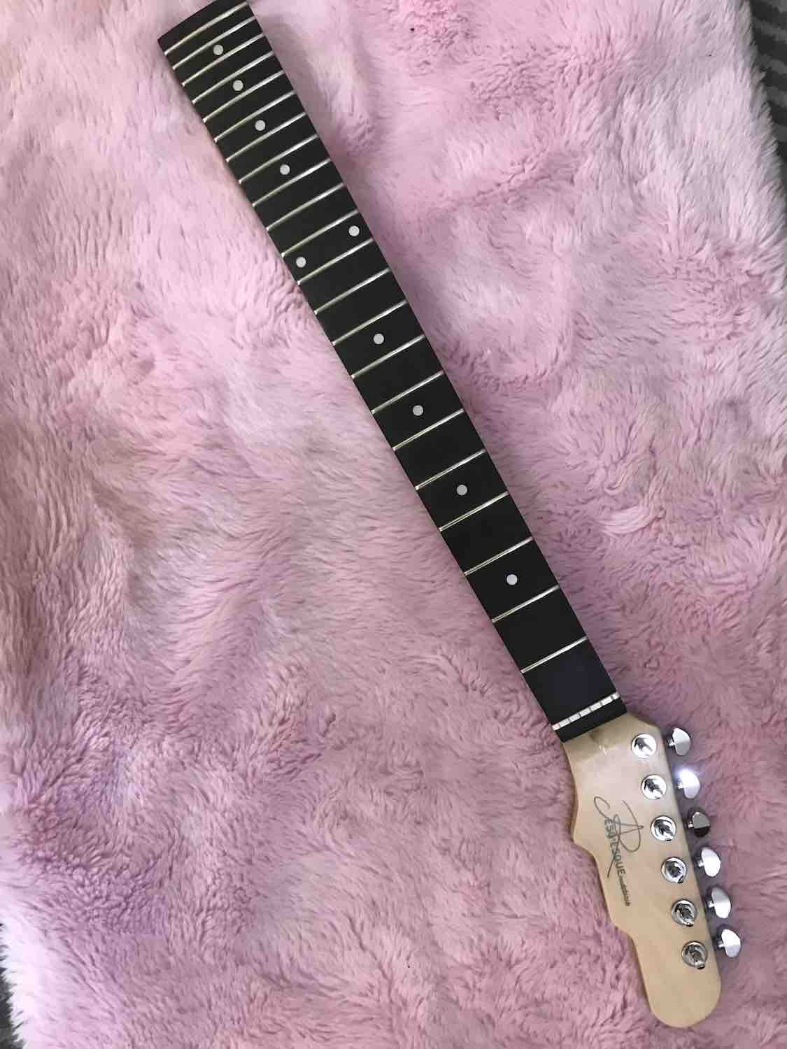

    Well it's been a while - I've had a few things to get done - and some waiting to do (still waiting on the pickup - a cheap Filtertron - type).
    Once I have everything - I can finish routing and throw a white stain and finish on it
    I have now completed the neck - putting a "logo of sorts and a finish on it.
    The finish has a slight amount of a white tint in it - I wanted to keep the "new" maple colour rather than the yellow" that it turns into.
    In hindsight I might have put a black stain on it and sanded it back - but that's an experiment for later?
