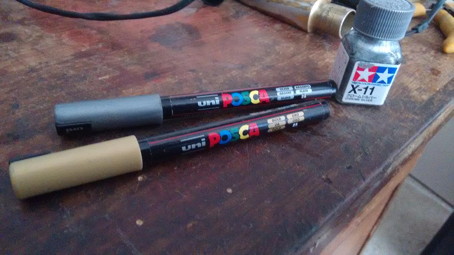

    I got these metallic paint pens from Eckersleys.
    I also used Tamiya metallic paint from a hobby store.Attachment 24800Attachment 24801
    cheers, Mark.
    Thanks mate, ill check em out.

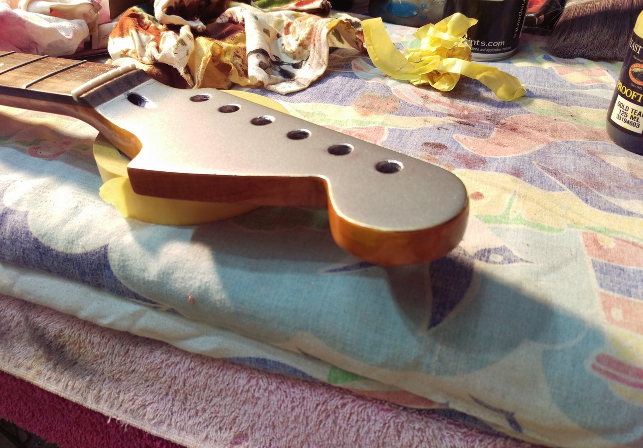

    On to the next stage. Taped the headstock again, making sure to keep the tape edge a fraction of a ml higher so no silver basecoat will show under the red.
    Used a nifty little gadget to spray with, its awesome for either mist or heavy coats. It avoids the casualty of the spray hitting the top front edge of the can, which can lead to splotches to the surface you are spraying because of too much downward pressure on the nozzle.. And presto no more tired fingers...
    The headstock taped up and 3 coats of base.
    After the silver had tacked off i immediately removed the masking tape so the paint wouldnt harden and make the tape too hard to remove. Will wait till its completely dry the retape a fraction of a ml lower and apply the red doing the same until i apply the clear.
    All going well it should work.
    The headstock with tape removed and slightly cleaned up overspray with thinners.
