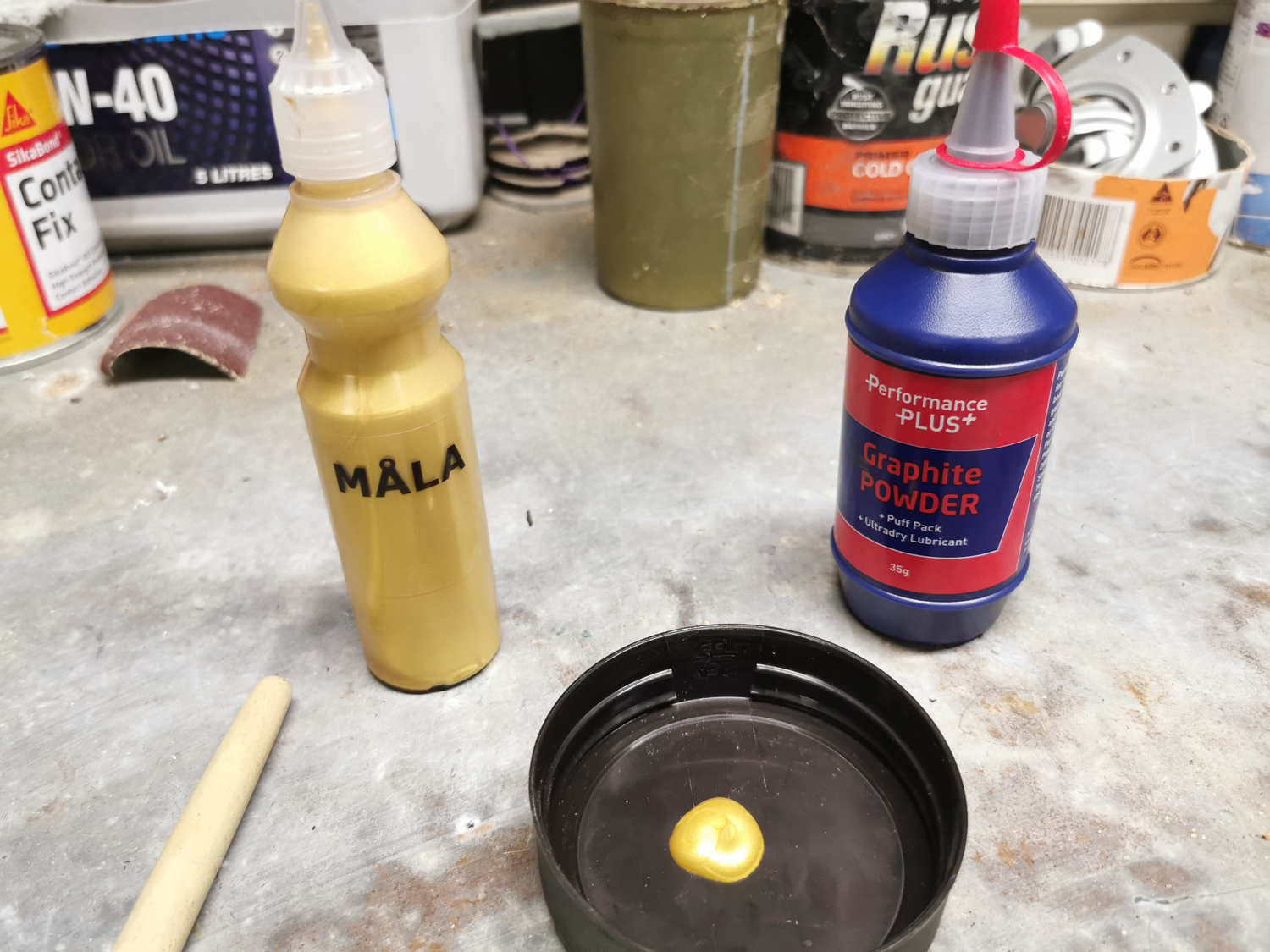

    Let's make some shielding paint!
    Is it going to be as good as purpose made stuff? Nope! Is it going to work? Hopefully! Is it going to be easy to do and at least look good? Maybe!

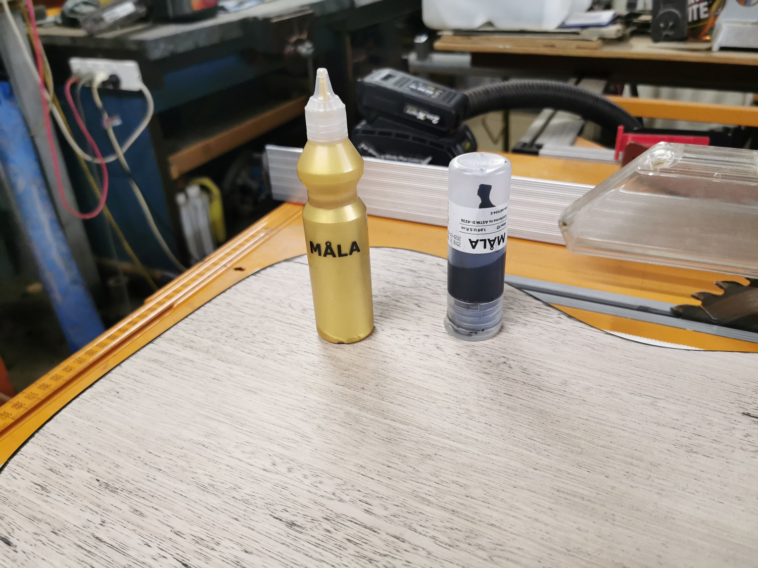

    I bought some graphite powder and raided the kids paint box again. This time going for the super vivid gold metallic paint. Thoughts on this were that it would be easier to ensure I got a good mix because the gold will stand out like the proverbials. The second reason was I thought there was a chance it would end up looking rad.

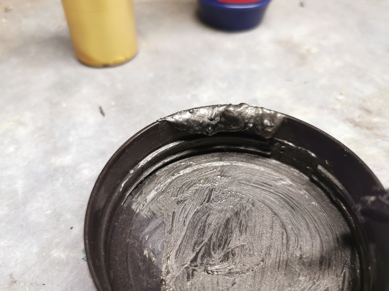

    Mixed in a good amount of graphite and got this stodgy, sticky, metallic silver looking hot mess, with some tantalising metallic flakes visible.

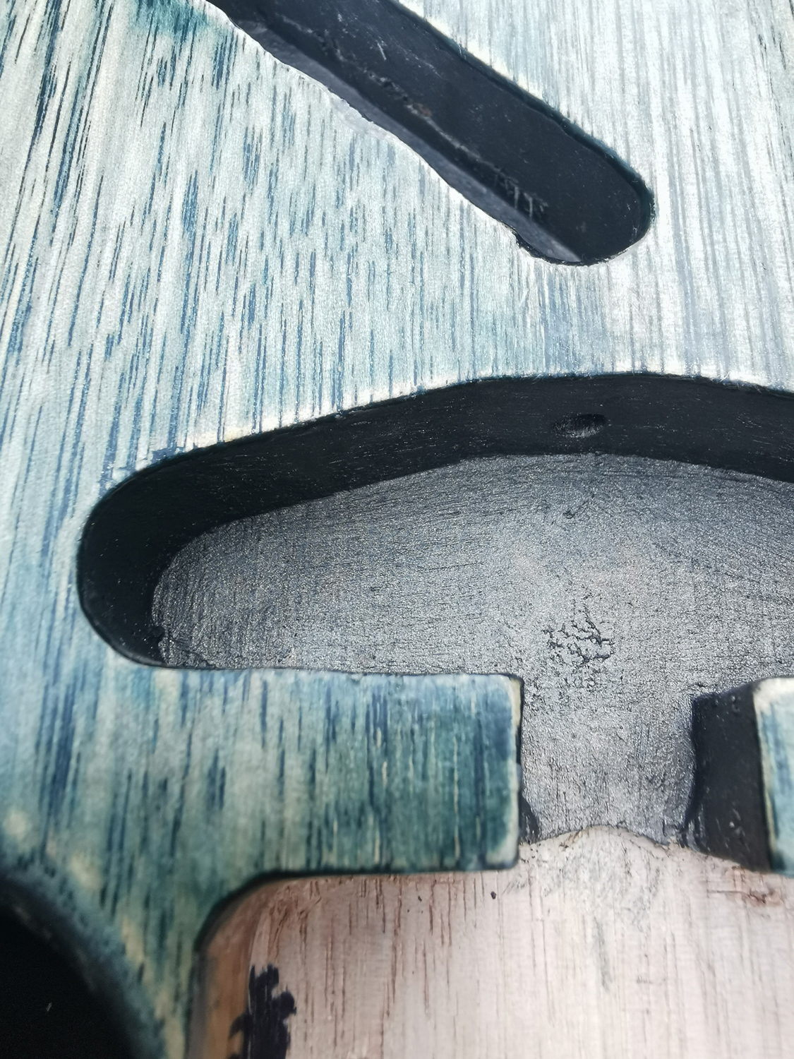

    First coat done, will definitely need another. Looks pretty flat and graphitey.
    And a close up. Will do another coat tomorrow morning.

    EDIT: A word on the shielding paint that most of you probably know already. It sticks to eeeeverything, but cleans up easy enough with denatured alcohol (methylated spirits). I'd keep it the hell away from bare wood you don't want it on though.

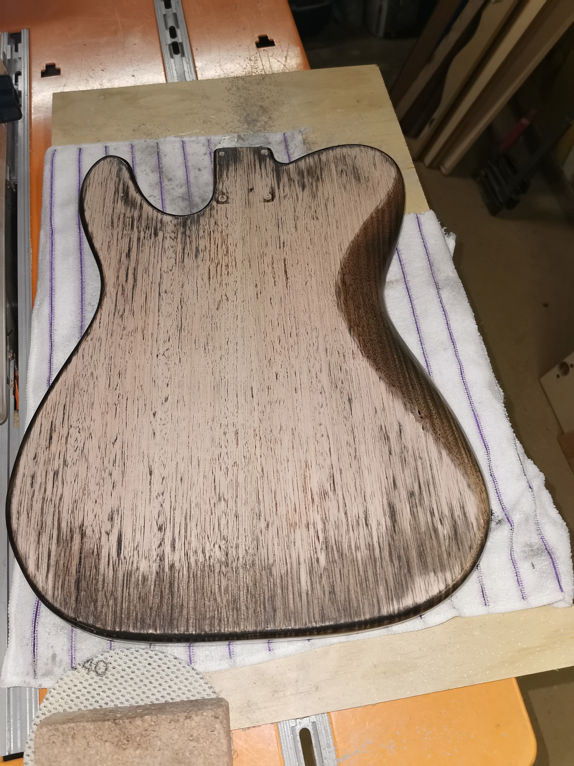

    Also started hand sanding the back... back. Almost to bare wood, will hit it with 220grit orbital mesh tomorrow to finish it up, then re-paint and put the first poly coats on.

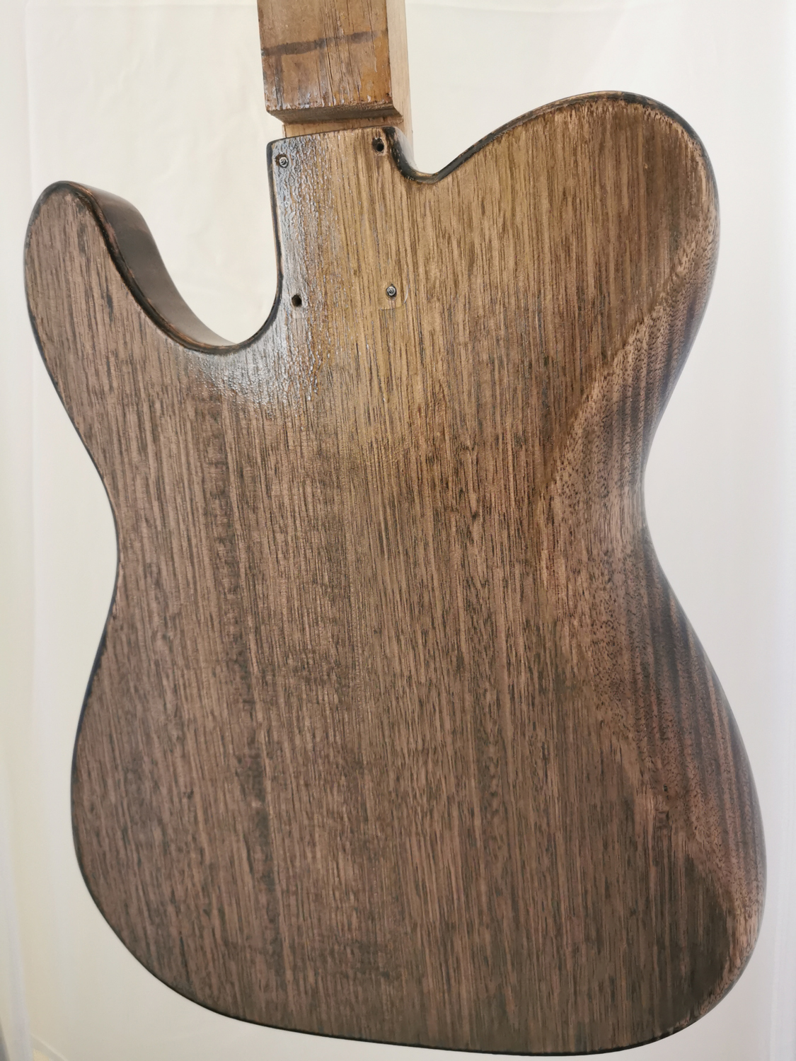

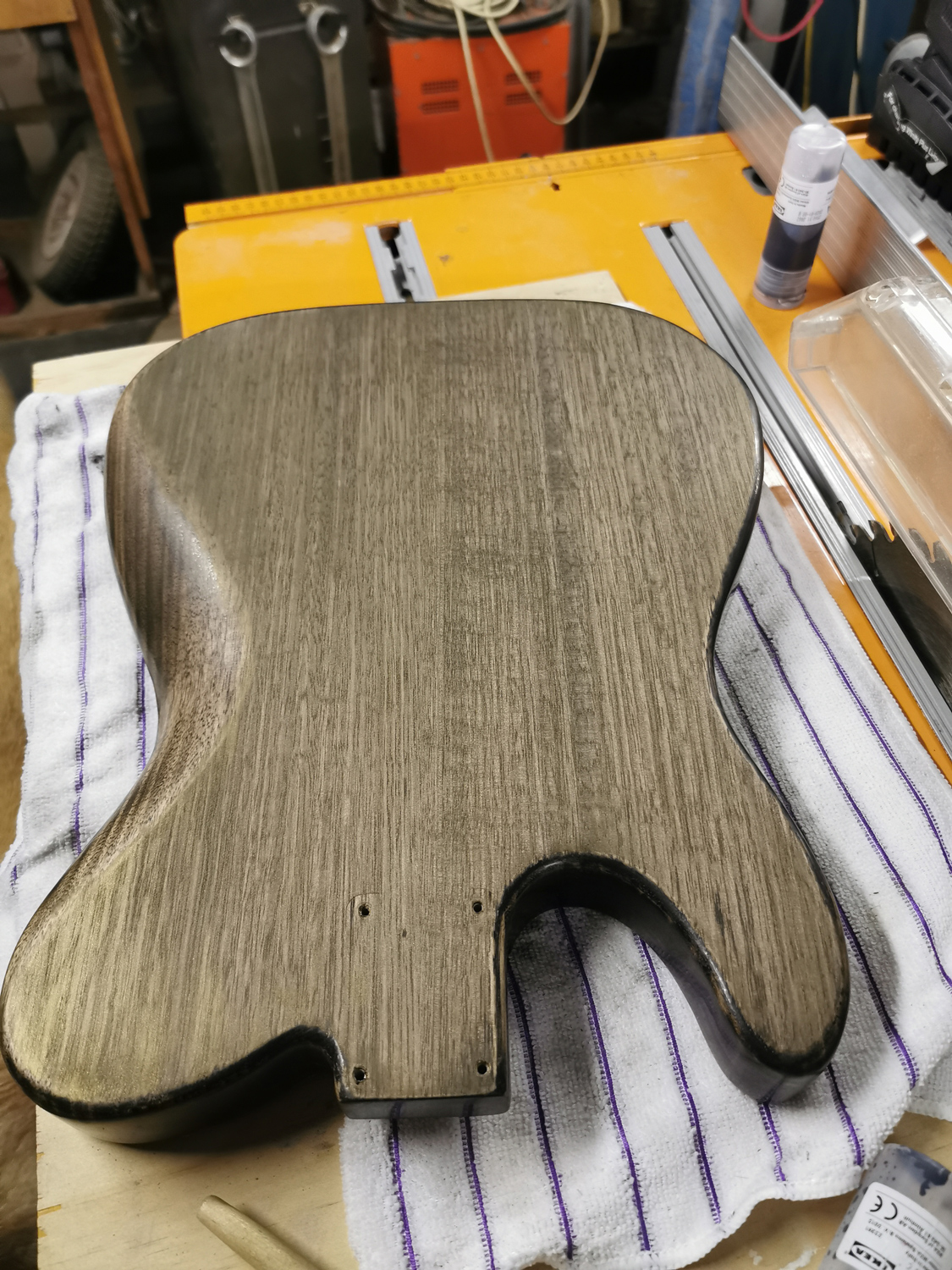

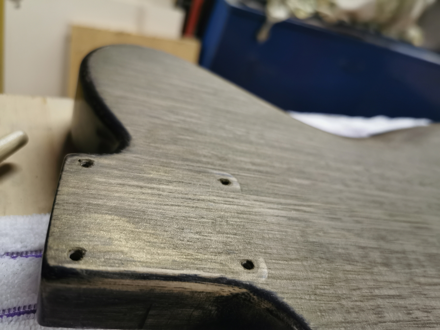

    I repainted the back today. Decided to try something different and combine the metallic gold paint with the black.
    Followed the same process I developed for the front. Cover entirely in black, then once that's dry enough put down the gold with a fresh piece of cloth and rub back furiously. It pushes the black into the grain, and mixes the colour that's left on the surface.
    The gold is subtle, which is what I was hoping for, but when you get it at the right angle it really pops.
    And then three coats of spray poly over 30 minutes, which I'll then leave for 3 days and then do three final coats. Then 3 weeks to wait. I still don't have the hang of it so there's overspray. I should be able to sort it out when I'm wet sanding, but spraying "light" just feels like it's doing nothing so I add more and invariable get a run or two. I need to trust the process more.
