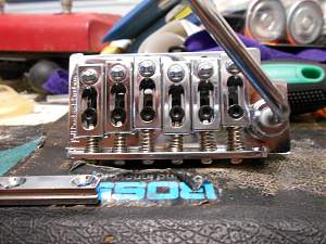

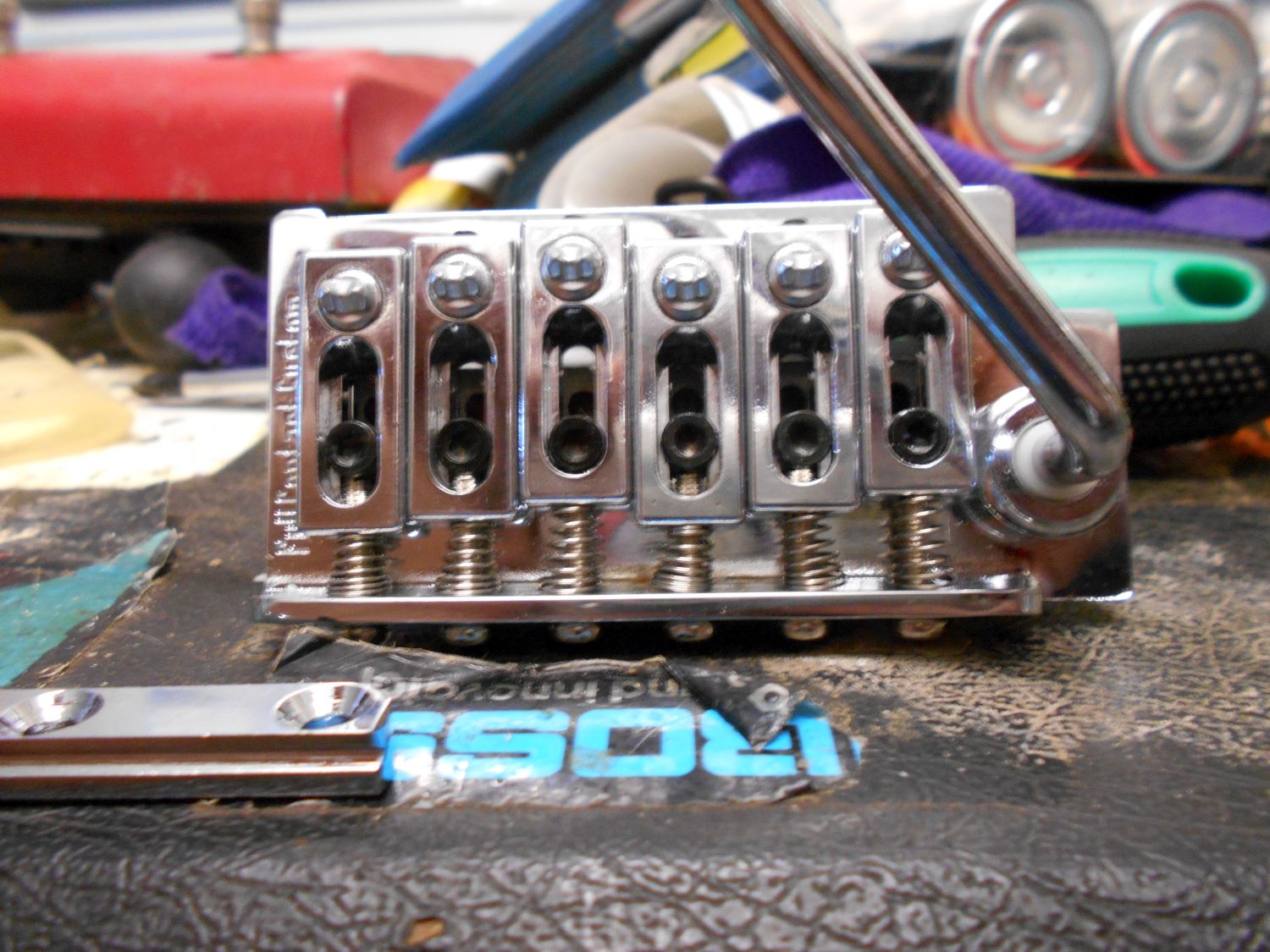

    And here's a closeup of the new bridge, the thin piece of metal in front of the bridge and to the left is what the front edge of the bridge pivots against, it's a bit like the pivot points of a Floyd Rose, or a Wilkinson Strat Bridge, it is fixed to the body of the guitar via four screws:

    When I got the new bridge home from the shop I bought it from (it cost me only Au$99.00), I gave it a quick test-fit in the Gold Strat and it looks like it is going to be practically a drop-in fit with a minor mod to the scratchplate, it has a pretty big sustain block on it but I found that there is just enough clearance between the trem spring cover and the sustain block to allow the bridge to sit flat on the body with the trem springs installed, the new bridge comes with all the mounting hardware, screws, spring-claw, springs, trem arm (which just push-fits into a socket on the bridge), and all the needed Allen keys to adjust the saddles and trem arm tension grub-screw, it seems to be a quality piece of hardware, will be interesting to see how it performs, but I'll have to wait till tomorrow to do the installation because I need to put the battery for my cordless drill on charge, the old bridge mounting screws need to be drilled out and doweled so that the new mounting screw holes don't end up weakening and let the bridge move forward under string tension, hence the need for my cordless drill.
    I need to position the new bridge a bit further towards the bridge pickup in order for the guitar to intonate properly, shouldn't be too difficult a job to get right but I'm determined to do a good job of it, I will measure three times before I finally drill just to be sure.
