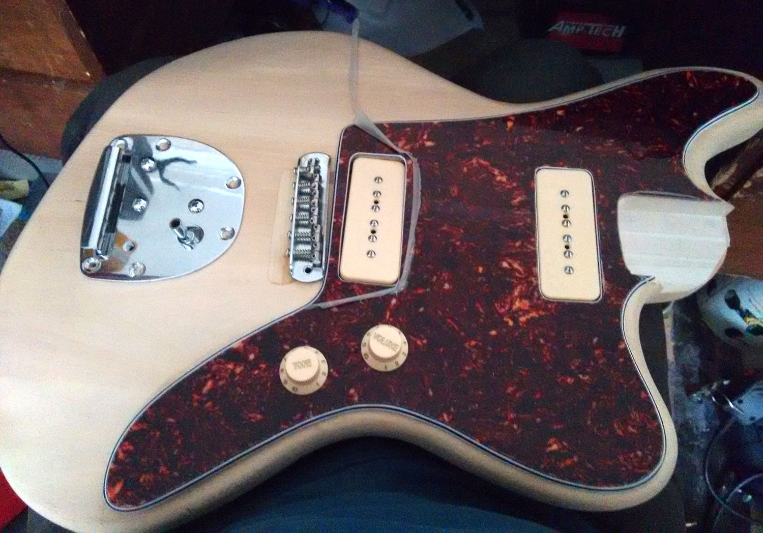

    I opted to change the switch to a Gibson style toggle, but seeing as I have yet to drill the hole...
    Also considered using the metal switch plate but decided on the 'Jazzmaster' pickguard configuration.
