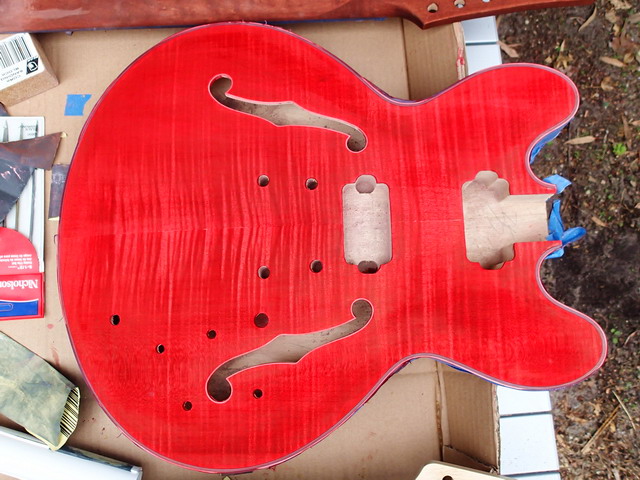

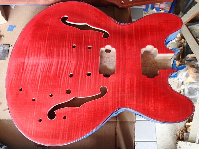

    Back to the dye today, sanded it back a fair bit then some more grain filler than sanded off and i got what i was after, added a splash of dye then waited until it dried, darkened it up and went again. Once ihit it with some poly it should look nice.
    Tomorrow i will run a very slightly damp cloth over it to take some excess, then hit it once more a little darker cherry again and that it no more, i will fit some hardware and finish the neck, i was going to spray some black enamel on the heel, its the only way around this problem, but i will wait until tomorrow and hopefully we dont have this 80% humidity.
    First coat still damp

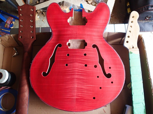

    Second slurp a bit darker, will have a look tomorrow see if its as deep as i want it.
    nice colour Tony, should look great with some cherry stain

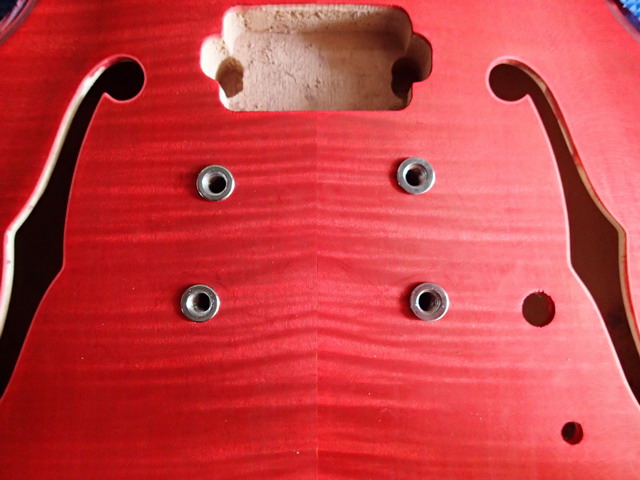

    Looks like its darkening up as it absorbs and dries, i was going to do a burst but i really cant be bothered now (hate to stuff it and start again), this now looks like the tops done.
    so that is darker just from curing Tony ?
    no need for a burst it looks fine as it is.

    Yeh Wok just from curing, when i put a satin poly on it should look shmick

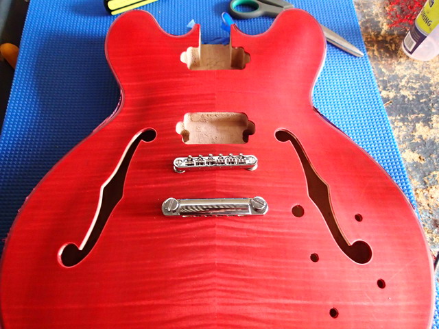

    Lets see how some hardware looks
    Reminds me to run and earth wire from the post
    Looks great Tony. Perfect colour!
