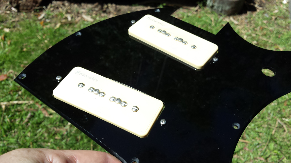

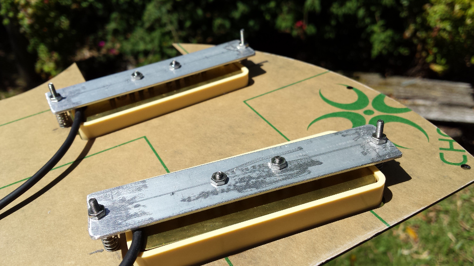

    A little more work today on the ash mosrite. I have decided to create adjustable pickguard mounts for the P90s. A bit late in the game for such changes but hey it's been that kind of build. I got some 20mm x 3mm aluminium bar and made some mounting plates, with holes drilled in the position of the existing P90 mounting screws. A couple of more holes and the P90s now mount like humbuckers to the underside of the scratchplate.
    The only problem now is that the routes will need to be extended about 8mm to the left to accommodate the new mounting plates. A bit of a bugger given the nice gloss finish I have created . I think some cardboard taped down over the finish should protect it enough from the router. Only one way to find out!

    Tense moments coming up, Gav, with the extra routing! The cardboard should do the trick protecting the finish though.

    Well the routing is done and finished. It's rough (I freehanded the whole thing with the trim router) but the pups fit and the scratchplate tells no tales. The cardboard worked well under the trim router.
