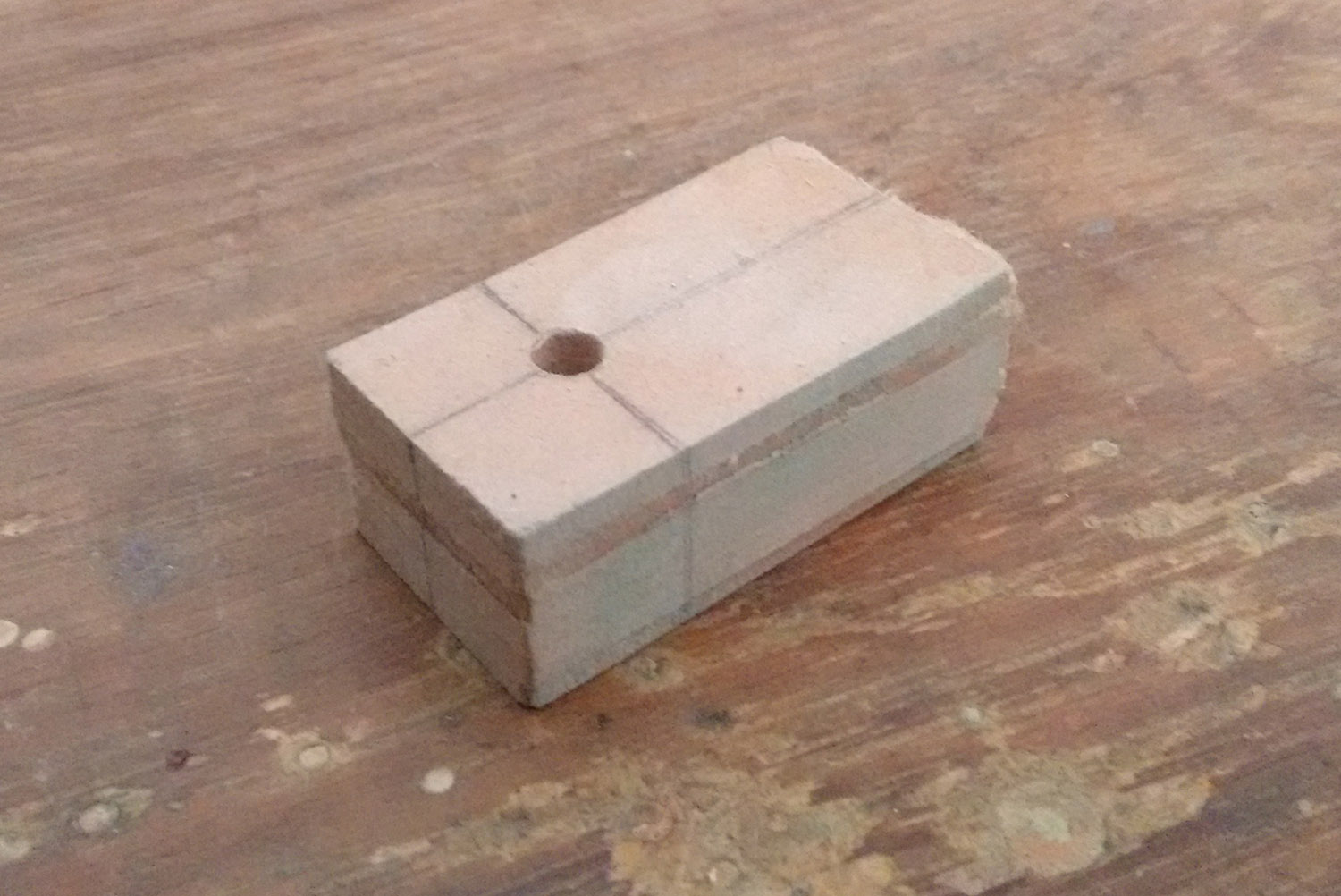

    Looks good Mark - particularly the string spacing without a drill press. There's no way I'd get them that even or straight.
    I may have just missed this somewhere, but what do you think made the Cabot's Exterior peel?

    Thanks John and Fretworn.
    I used this guide that I cobbled up after a youtube 'how to' video.
    I'll have to look it up when I get some time and paste it here.
    edit: here it is https://www.youtube.com/watch?v=5SZA03DVITA

    The Cabot's was just incompatible with the duplicolor. It just wouldn't bond with it.
    I had a similar issue with Ironlak/Feast and Watson wipe-on-poly.
    cheers, Mark.

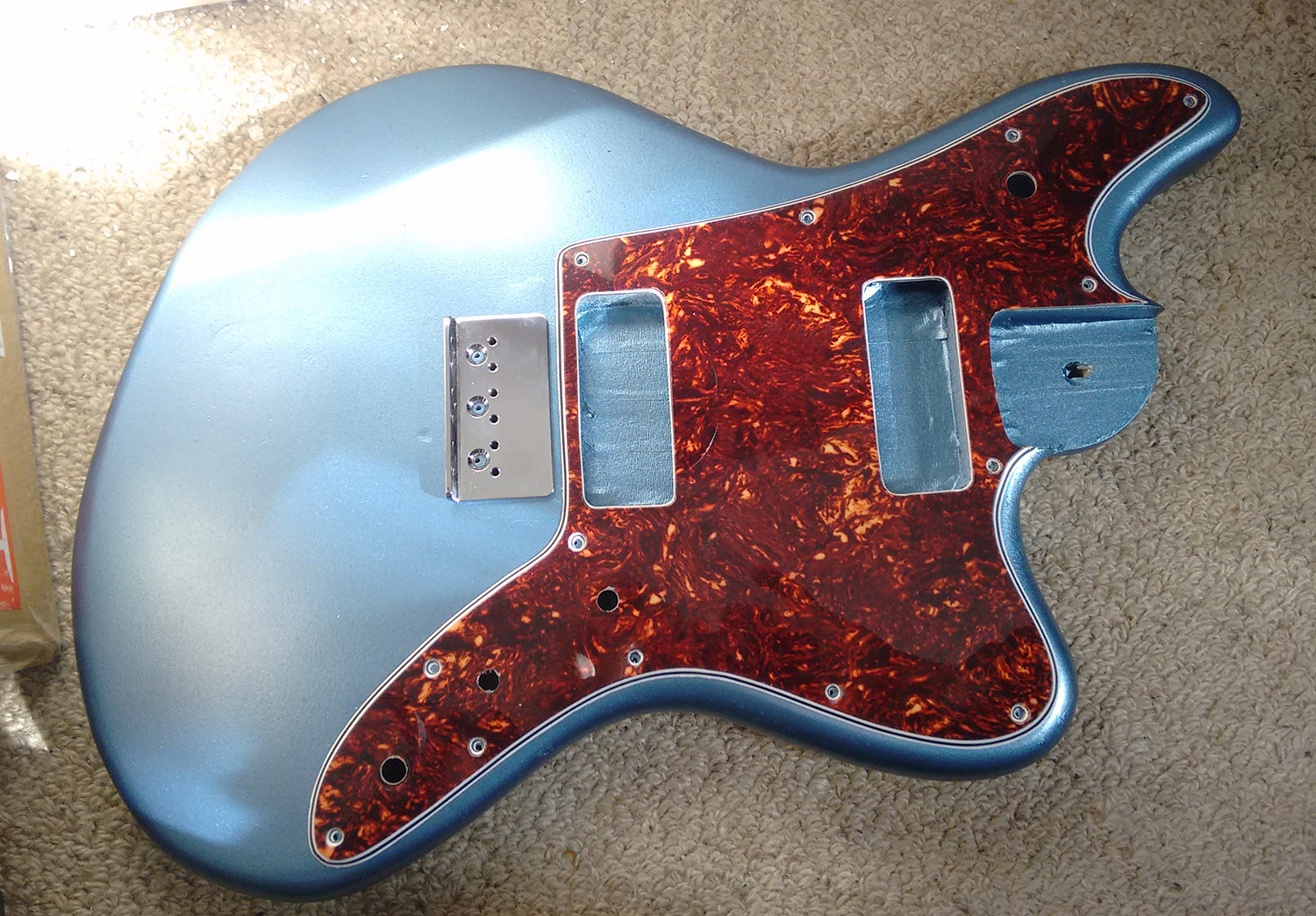

    Altered colour scheme.
    cheers, Mark

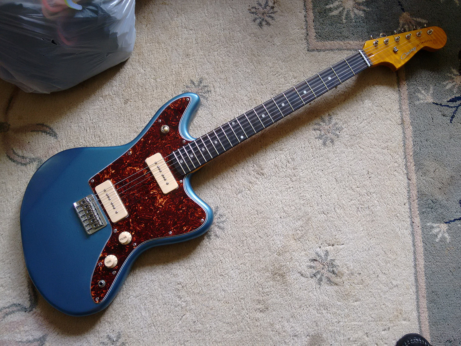

    Time as passed so quick.
    Still not 100% happy with it so when time permits I'll probably have more alterations.
    cheers, Mark.

    Oeee love the look of that, there is just something about those JM's...
    What alterations are you thinking about?
  7. #127
    Quote Originally Posted by RocknRolf View Post
    Hi RocknRolf I'm still not happy with the finish over the various acts of surgery...
    The re-filled tremolo rout and the filled in Jazzmaster style tremolo rout.
    Eventually going to require a better quality bridge i.e.
    https://www.stewmac.com/Hardware_and...er_Bridge.html
    Down-side with that though is 'top-load' strings only...and I went to all that trouble doing string-through holes.
    cheers, Mark.
  8. #128
    Do you really need roller saddles when there's no trem? The reason they are 'roller' is so that the string spacing can be adjusted to your taste. Which may be useful if it's a non-standard width neck, but it all looks fine with the kit bridge, which should be one of the standard string spacings.
    The downside with trying to find a hardtail string-through bridge is finding one where the screw and string holes are the same as on your current bridge. Whilst the fixing screw holes can be plugged and redrilled, if there's too big a difference between the string holes and the mounting holes (the string holes will determine the bridge position), the bridge could end up in the wrong place for good intonation adjustment.
    Babicz hardtail bridge is string-through. https://www.pitbullguitars.com/shop/...rdtail-chrome/
    Dimensions here: http://www.fullcontacthardware.com/f...dtail-original
  9. #129
    Hi Simon.
    It's the string spacing that I was concerned about.
    You probably can't see in the photo, but I've jammed some veneer between low A and low E.
    It is actually a Fender knock-off from ebay and I am thinking of 'upgrading'.
    As I said though, it's having done the string-through that's put the brake on it.
    (and that I don't have the cabbage either).
    The overall body finish is also not up to my expectation.
    If I did it yet again, there would probably involve a colour change.
    cheers, Mark.
