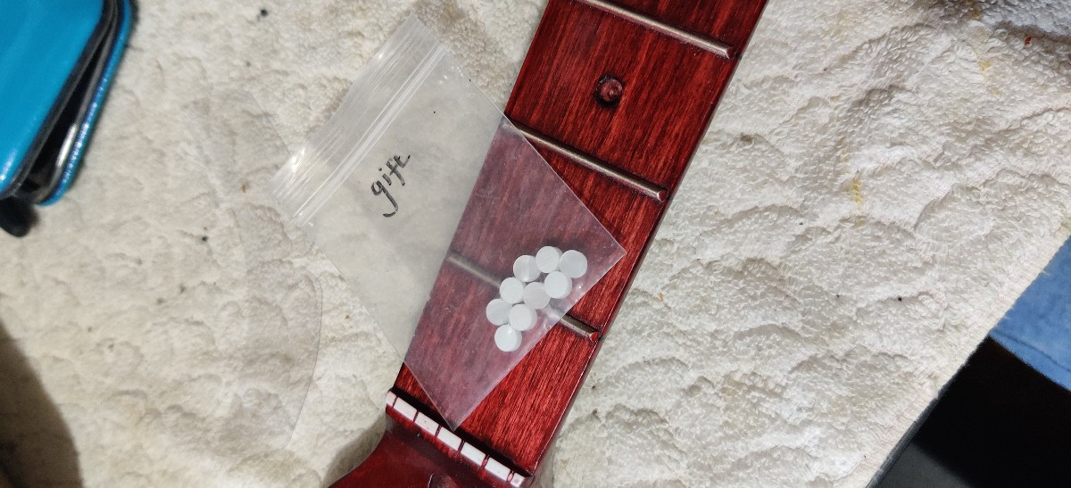

    So in lockdown for 7 days, good time to do some guitar stuff.
    Got all enthused about fitting fret dots but...........
    Yea exactly, somewhere along the way i lost one so went online to an Aussie site and ordered more.

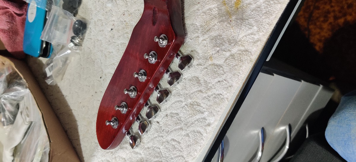

    Fitted standard chrome tuners to see what they looked like, a lot better than the rabbit ear ones i made, live and learn.

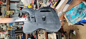

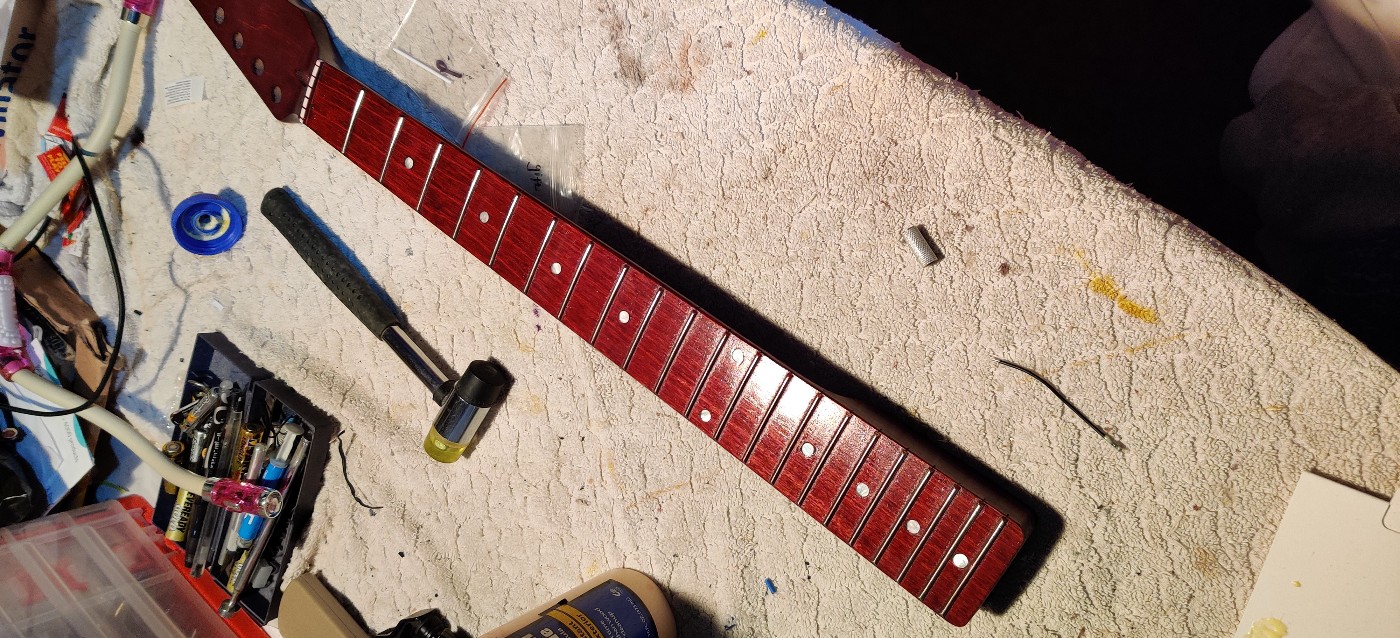

    So this is gonna be another slow build. Progress so far........body has been prepared and primed, 6 coats. The metallic black has been applied, 5 coats and its now had 4 coats of 1k clear. Ive left it for 4 weeks and its now ready for additional coats.
    The neck mop fret markers are finished. Might still add few more coats of wipe on poly, and thats it for now.

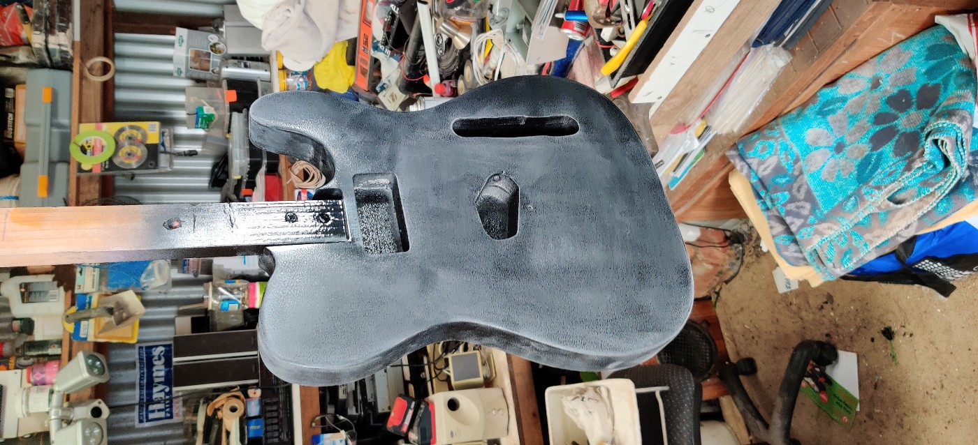

    Finally back

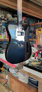

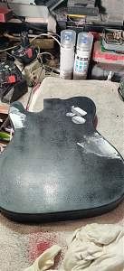

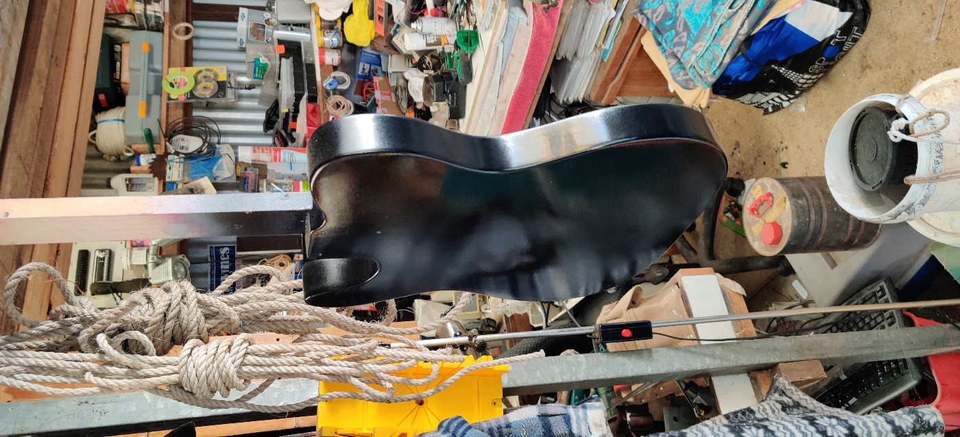

    So after some time had elapsed i decided to finish the final coats on my tele body but alas it wasnt to be. i thought it would be a great idea to unscrew the tried and tested stick that i had screwed to my tele body and had used for my last 3 builds and attack one that could be fitted into a contraption that i had built to rotate it for final spraying.
    You guessed it, the screws pulled out and damaged the body. back to the drawing board.

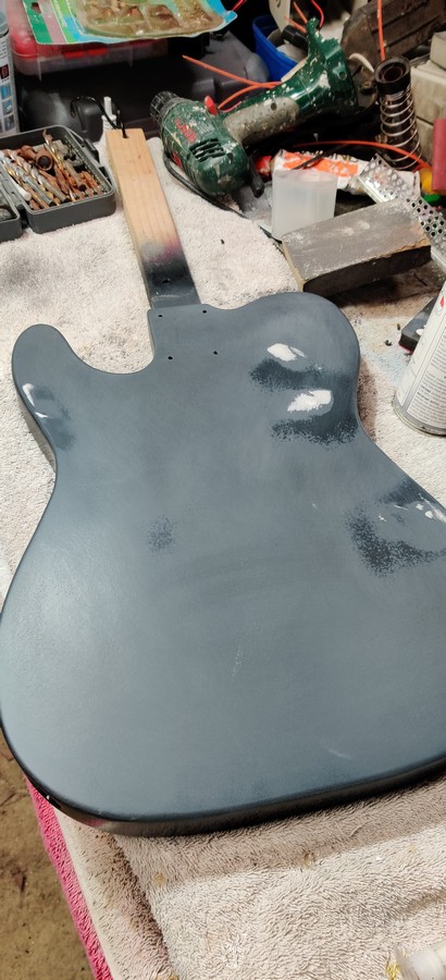

    Next step

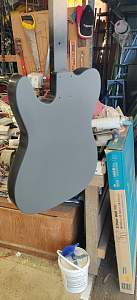

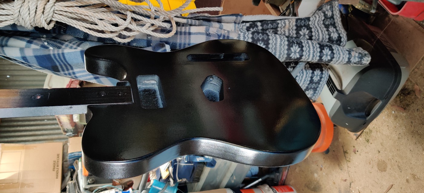

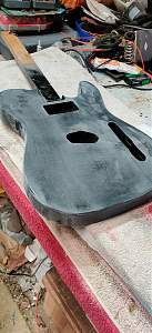

    So after lots of filling,sanding and priming im back to where i was.

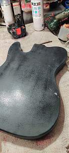

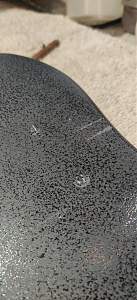

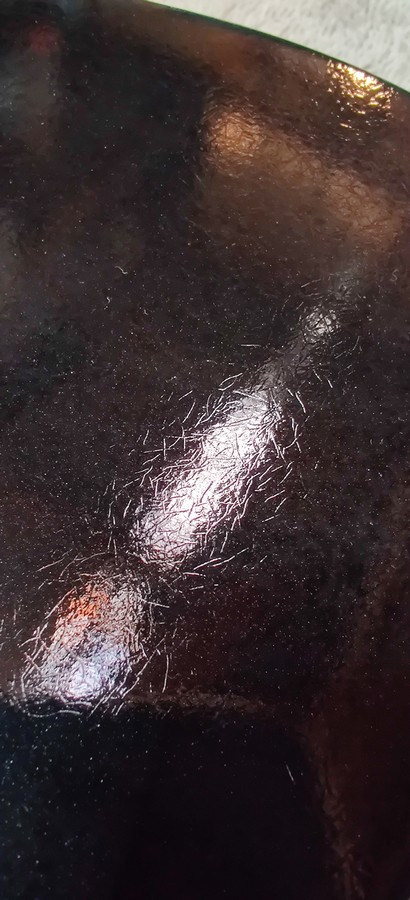

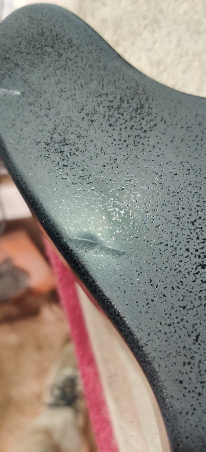

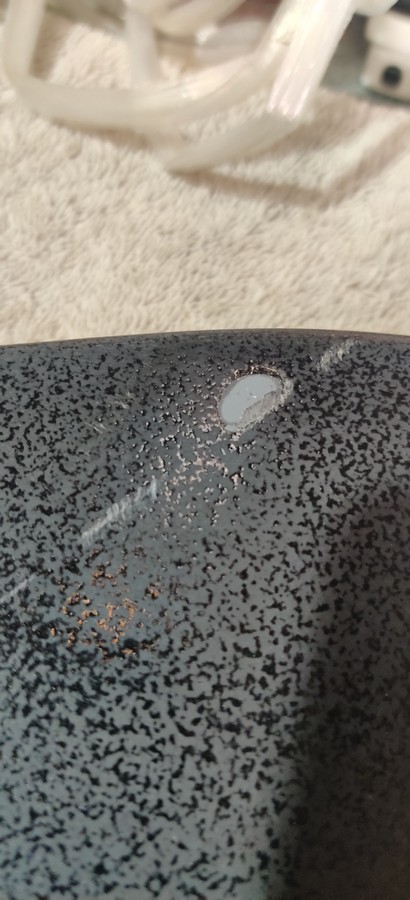

    So next i started to build up coats again. When i thought i had nearly finished i checked the finish one morning and it had all crazed!
    Back to the drawing board. This time instead of repriming i sanded then applied clear , sanded again the applied more clear untill i had nicely filled up all the craze.

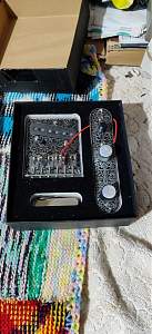

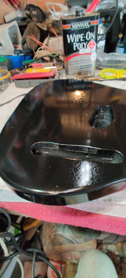

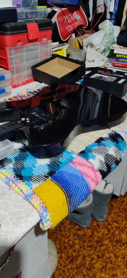

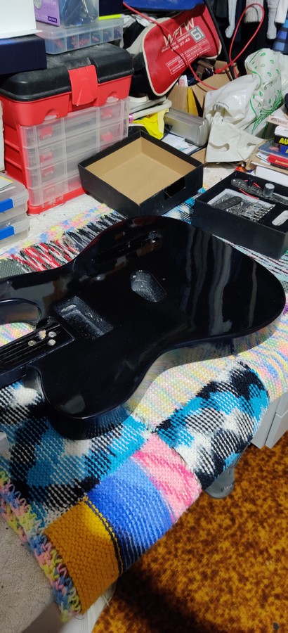

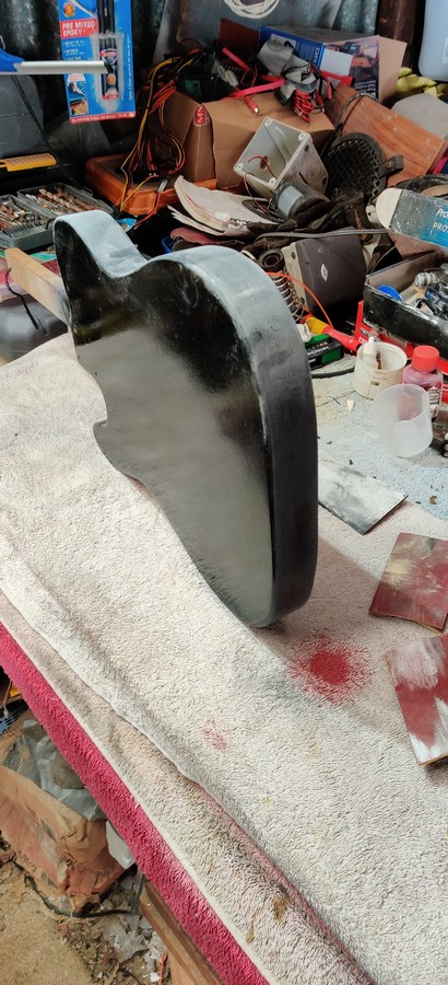

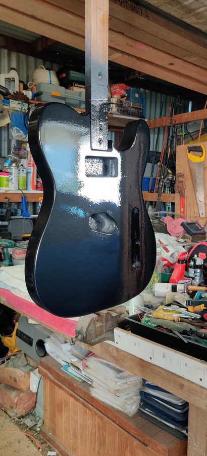

    Finally i gave the finsh a cut with 4800 compound then another cut with 9000 paste and then a final buff with car wax/polish.
    Now ready for the wiring and hardware. YAY!
