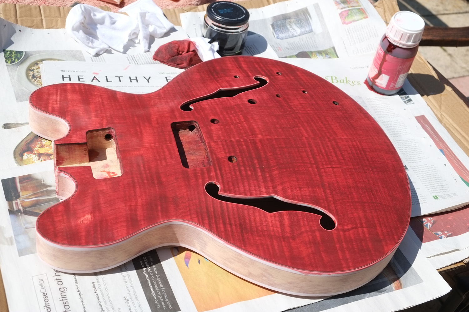

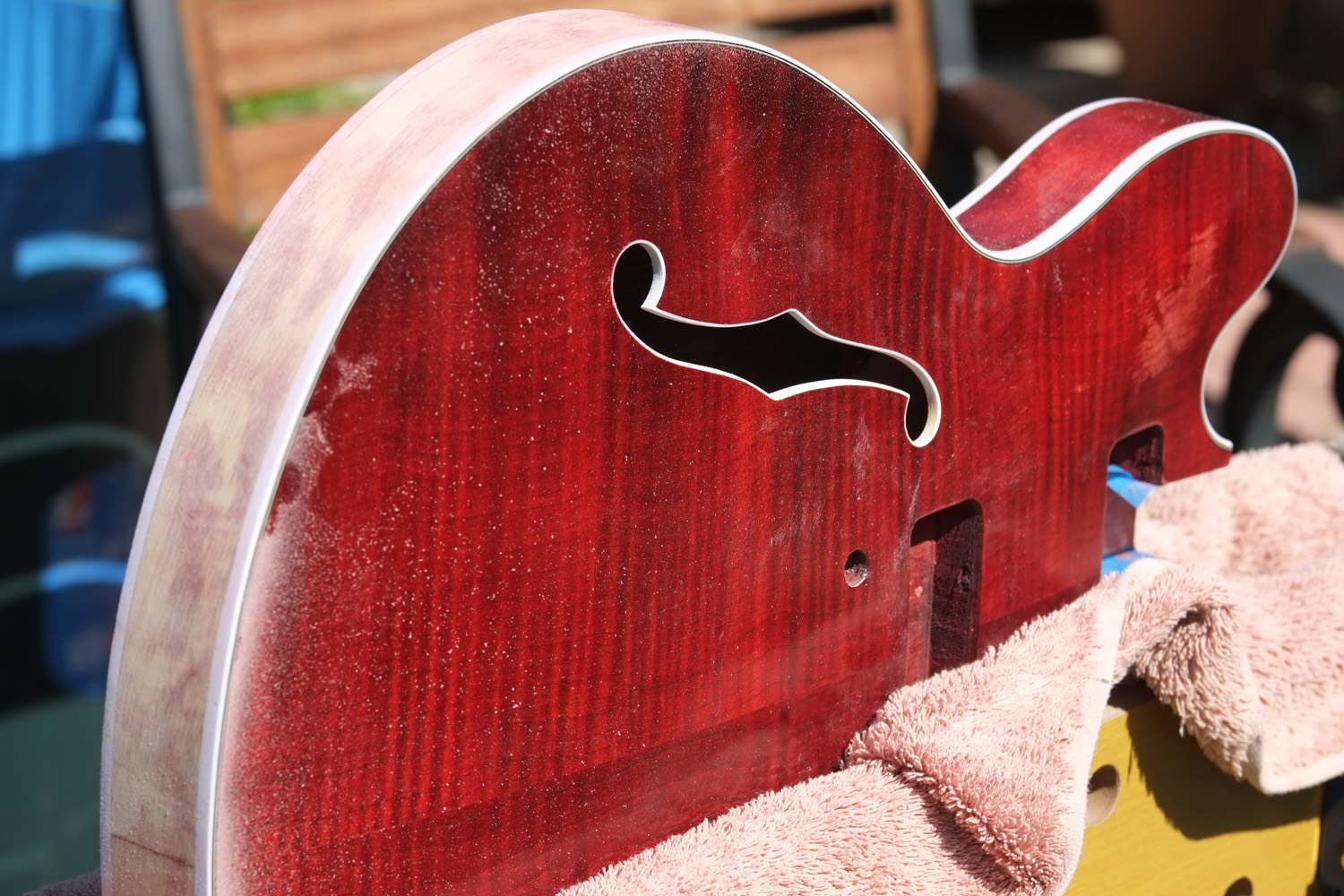

    The reason I have been fairly quiet recently is that I have been taking a rest from the guitar building side of things after a most annoying setback. I should have had the ES-1/330 complete by now, but when I went to do a 1200 grit wet sand sand before polishing the body, this happened on the bulge of the top horn on the front:
    Attachment 26308
    I'd hardly touched it. I'm sorry, but my experiment with Tru-Oil is over and I'll never use it again. It's not like there were only a couple of coats; there must have been 30 on all the surfaces and I'd waited about 10 days since the last coat went on. There's no way that I could patch that up and have it look presentable. So it's sand everything back time and see if the body will re-stain. If not, it's solid colour time. The weather's warmed up, so it will be back to the nitro.

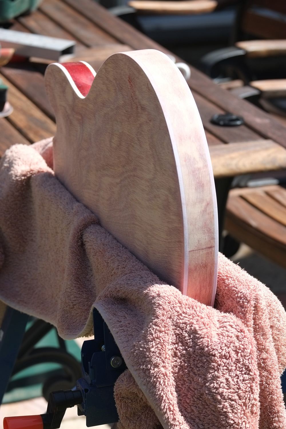

    So today I started on the back:
    Attachment 26309
    The really annoying thing is that the finish on the back is very hard, and it's taken over 3 hours to get the back stripped back, even using power sanders. A heat gun was of no assistance. Never mind, here it is almost finished:
    Attachment 26310
    I completed the back (camera battery is currently recharging so no fully sanded pic at the moment) but I've now run out of decent sandpaper (ordered more), so I've stopped for today. The next few days are forecast for sun, so guess what I'll be doing over the weekend! Just hope I can sand the front back without going through the veneer.

    Back and most of the sides done here:
Name:	Back and sides sanded 1.jpg
Name:	Back and sides sanded 2.jpg

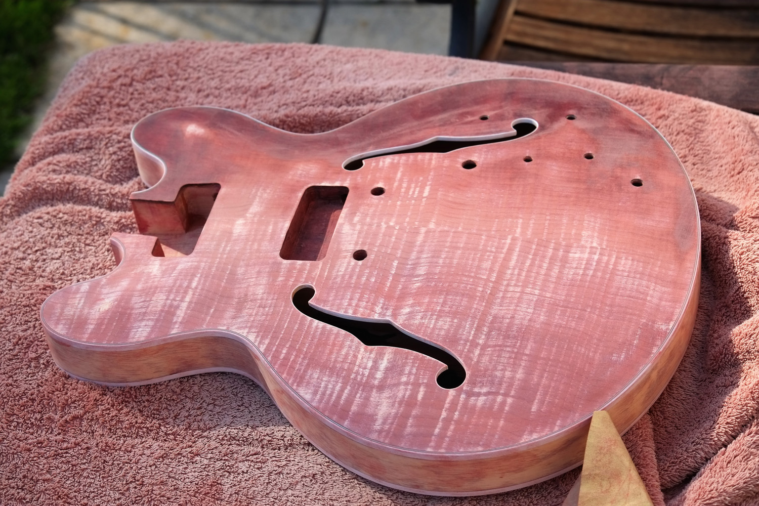

  9. #129

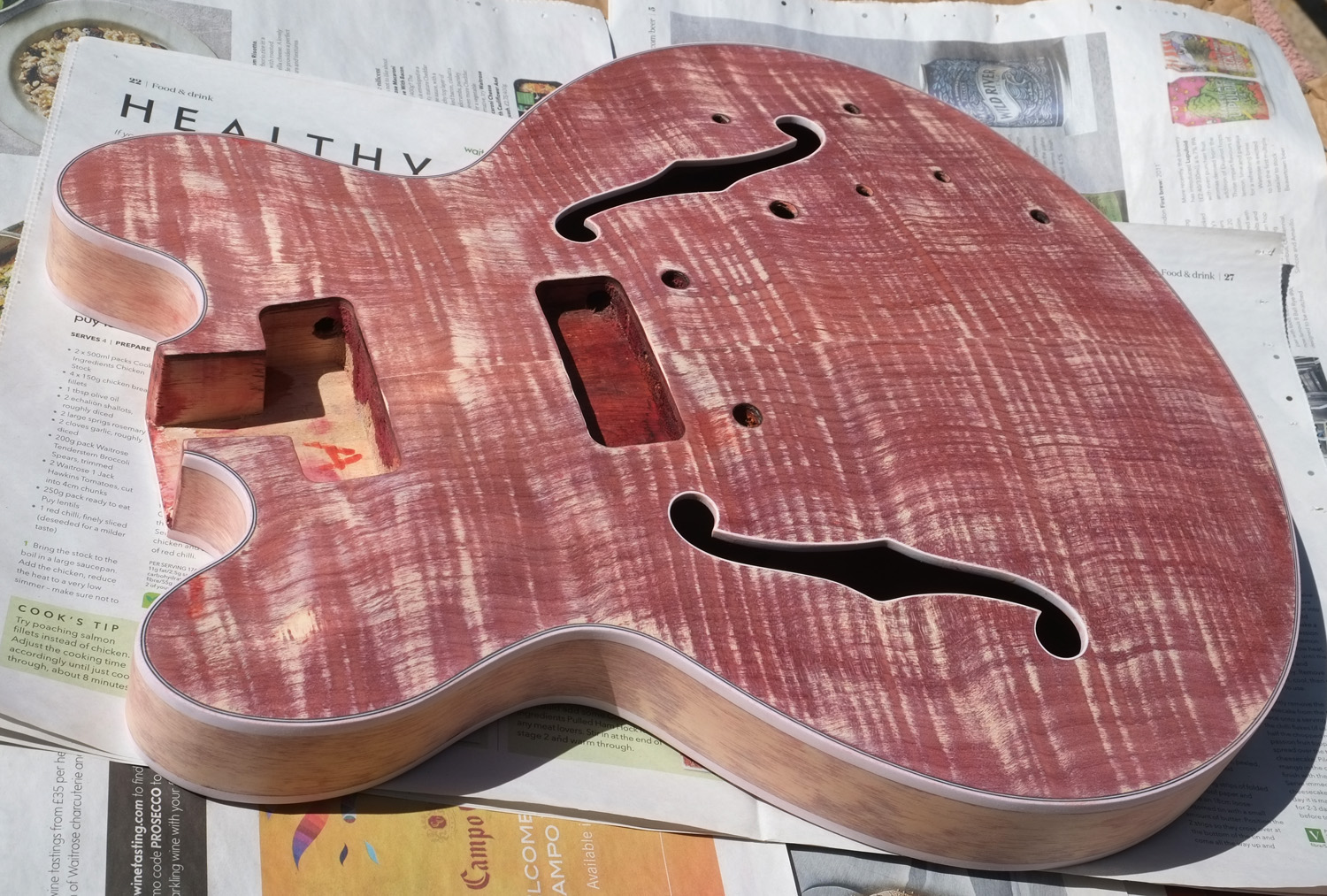

    Well, I finished sanding the top:
Name:	Top sanded.jpg

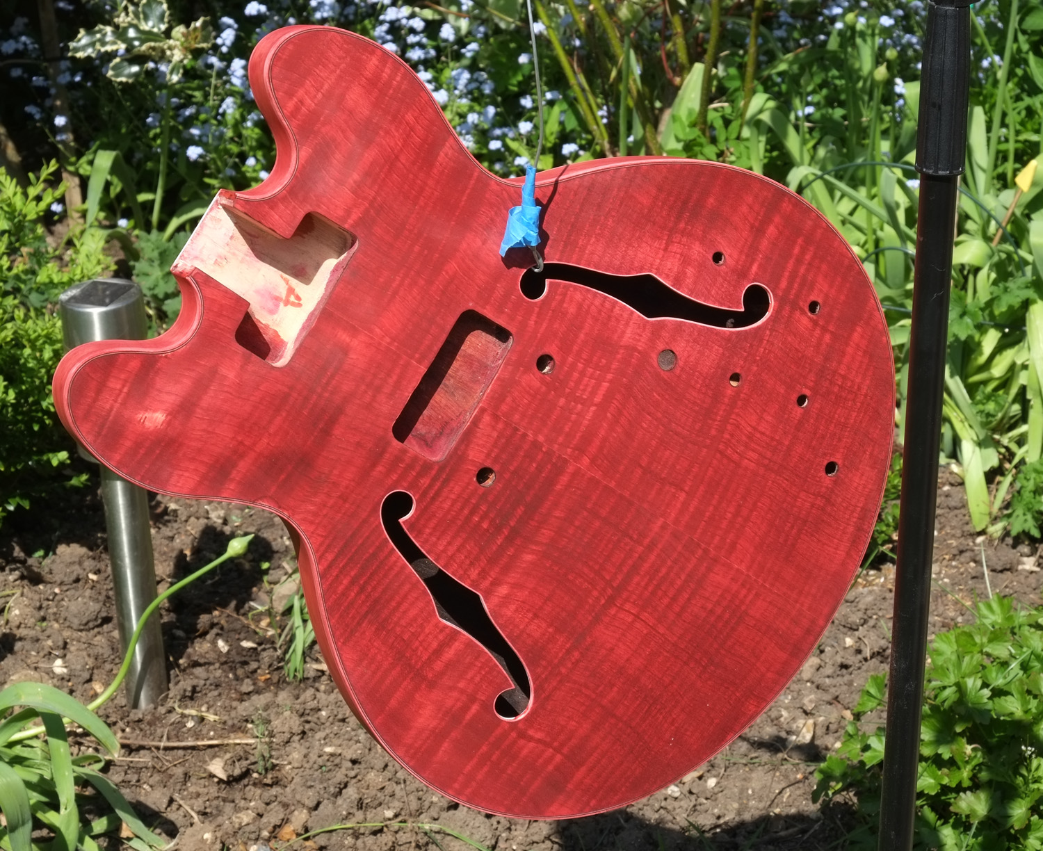

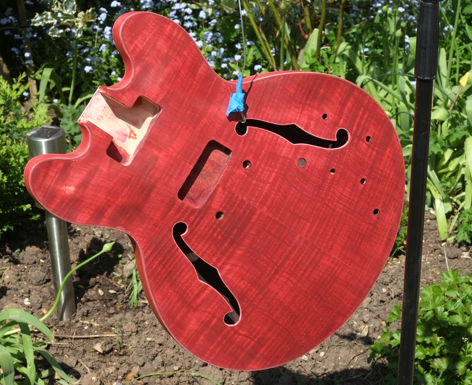

    So it was time for the staining. Shots taken after the initial applications.
    Top:
Name:	Top Stained.jpg
    Back:

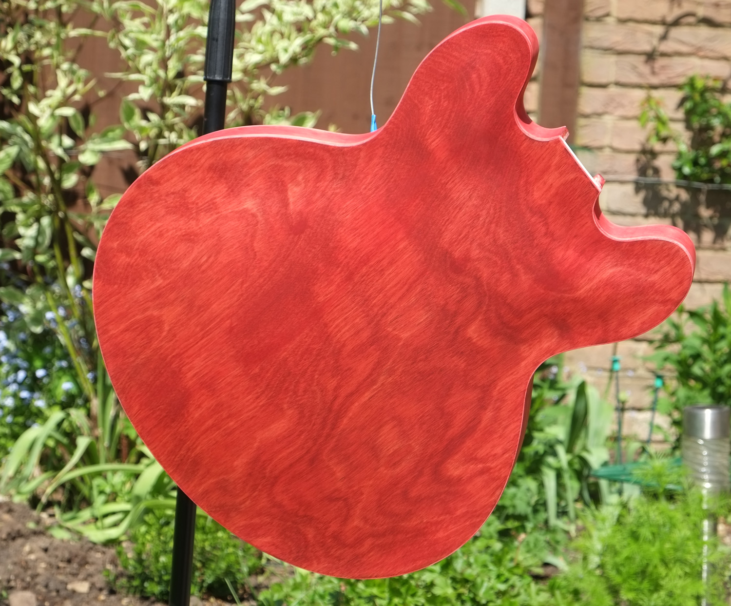

Name:	Back stainged hanging.jpg
    Spirit-based stain seems more forgiving than water-based. It doesn't leave a tide mark at the edges and it dries more quickly, so there's less likelihood of runs.
    The sharp-eyed amongst you will have spotted the elephant in the room; the small area on the top horn where I've sanded through the veneer. So now I've got to try and patch it up somehow. It might be out with the acrylic paints and paint that area. But I'll need to match the colour to how the rest of the guitar looks with clear coat on (which will be a brighter red).
