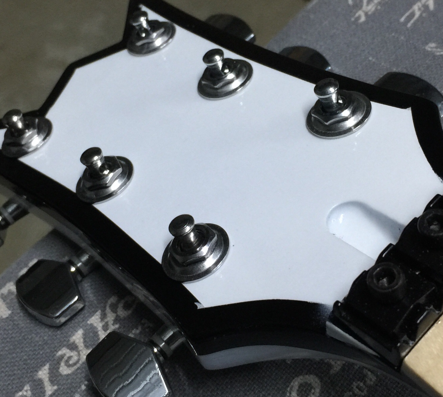

    Whilst waiting for some pickups to arrive I have decided to do this.
    Looks wonderful in my opinion. One of the screws for the locking nut was stripped when I recieved it so I'm currently sourcing a new screw for it. Shouldn't be too hard.

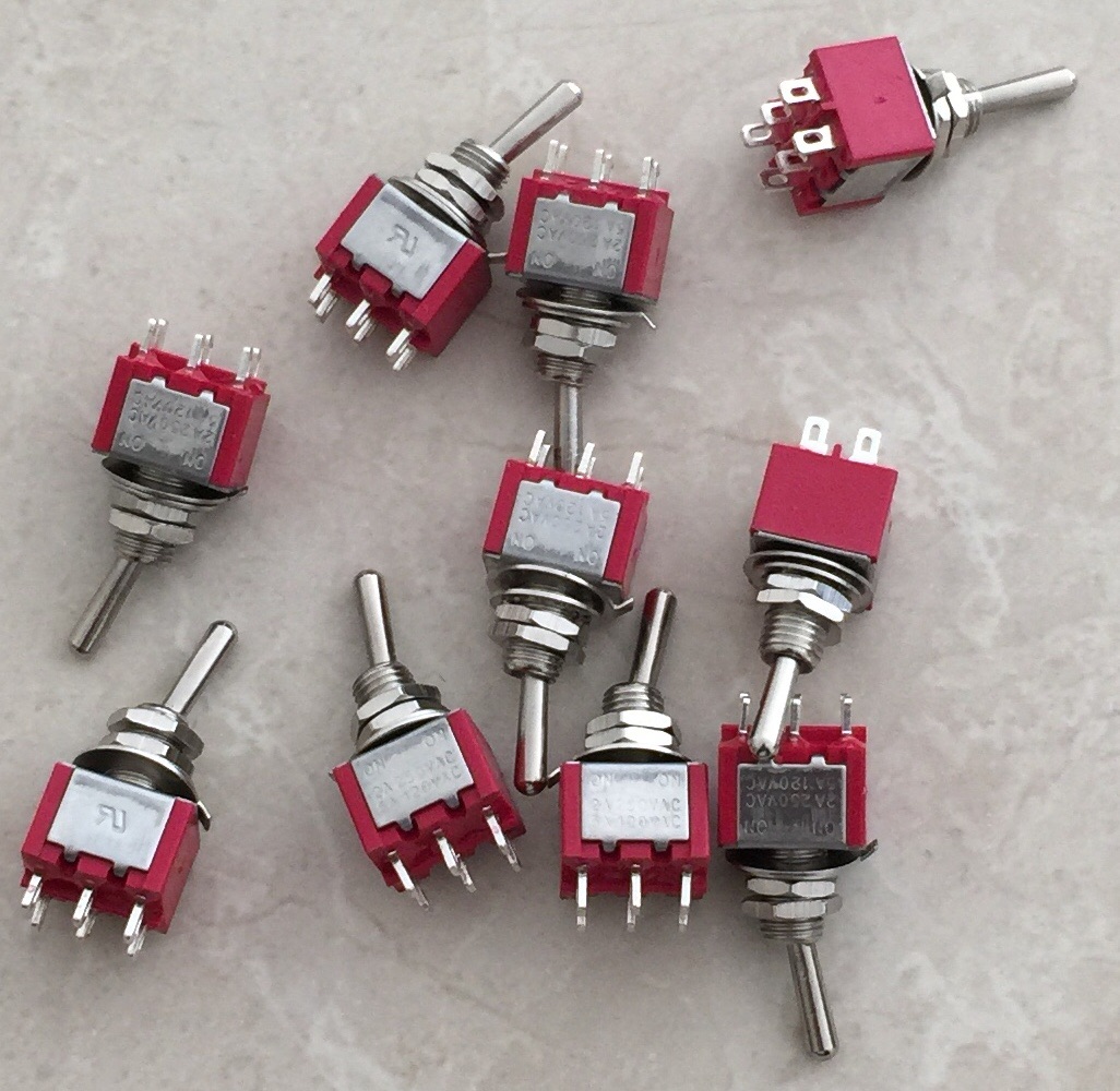

    So today I recieved these in the mail
    I ordered 1 and they sent 10, bonus! So if anybody needs one of these bad boys let me know and I'll send one your way haha.
    Of course the first thig I did was to check it fit through the guitars pot holes, and luckily it did, only just, but it fits!
    Now im just waiting on some new pickups to arrive from Adam, and the beast shall be on her home stretch

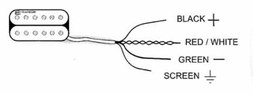

    Here's a good place to start: Entwistle Humbucker wiring. But, we can work things out once you get them.
  9. #129
    Entwistle colour coding:

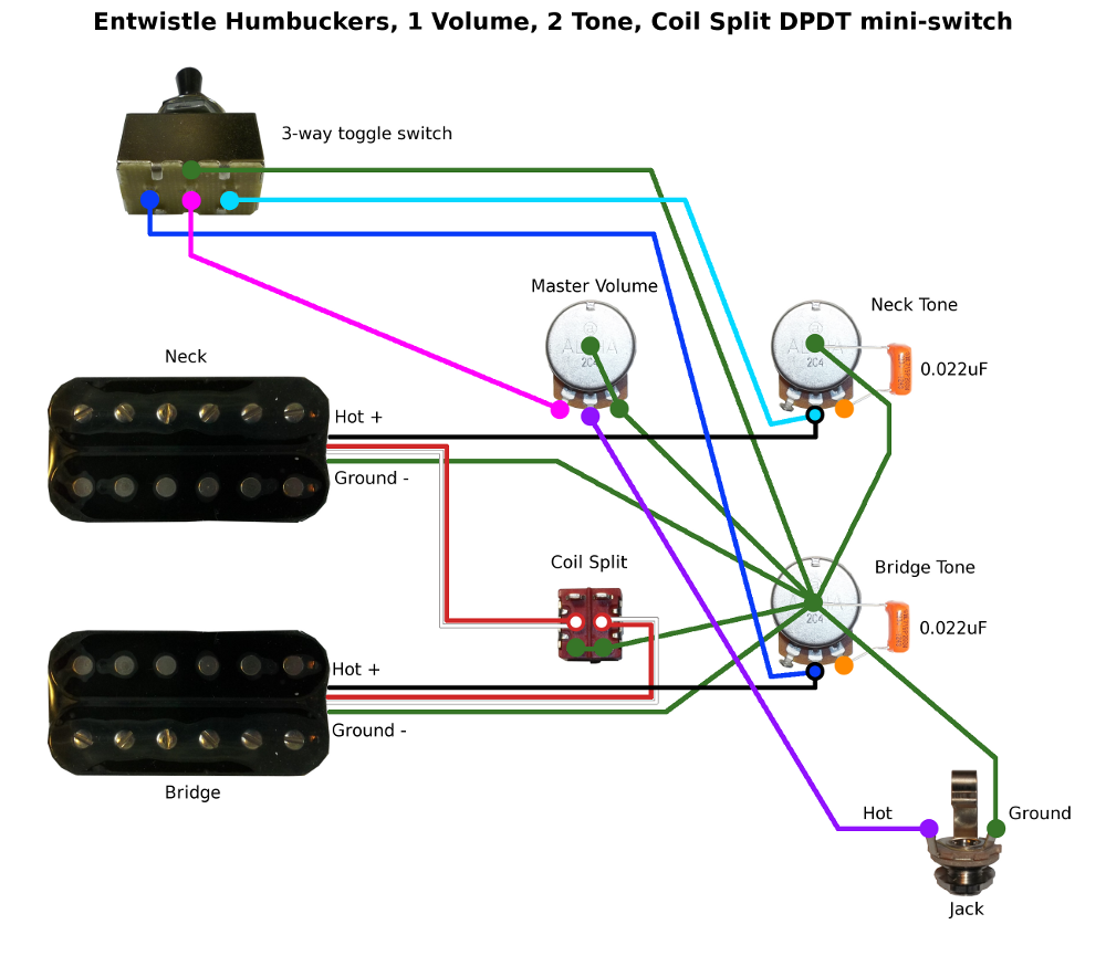

    1 Volume, 2 Tone with coil-split:
    Don't forget the bridge ground wire (connect to back of the pot with the other grounds).

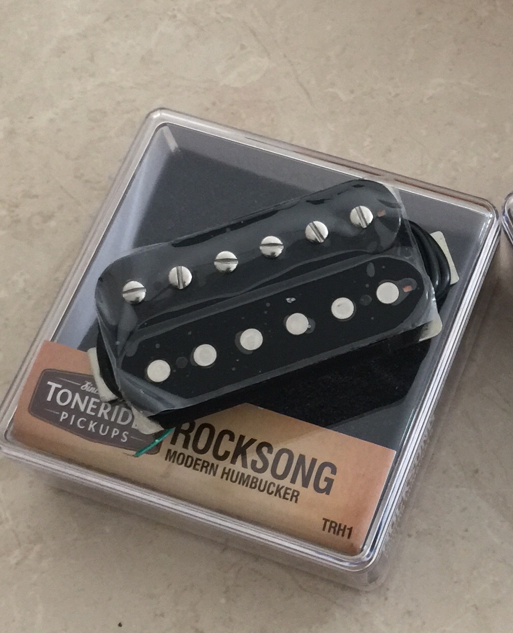

    So these bad boys turned up today woohoo!!
    Now from what the diagram that came with them says, the red is the slug coil start, black is slug coil finish, green is screw coil start and white is screw coil finish. The 2 finish wires (black and white) have heat shrink around the ends, do I need to remove them? Where do I go with this? Will these wires mean that wierdys diagram is the same even though it's based off an entwhistle pickups?
    There is also a bare wire which I would assume is ground?
    Also what wore do I use whilst wiring, can I just use the stuff that came in my kit or is there a better wire to use?
