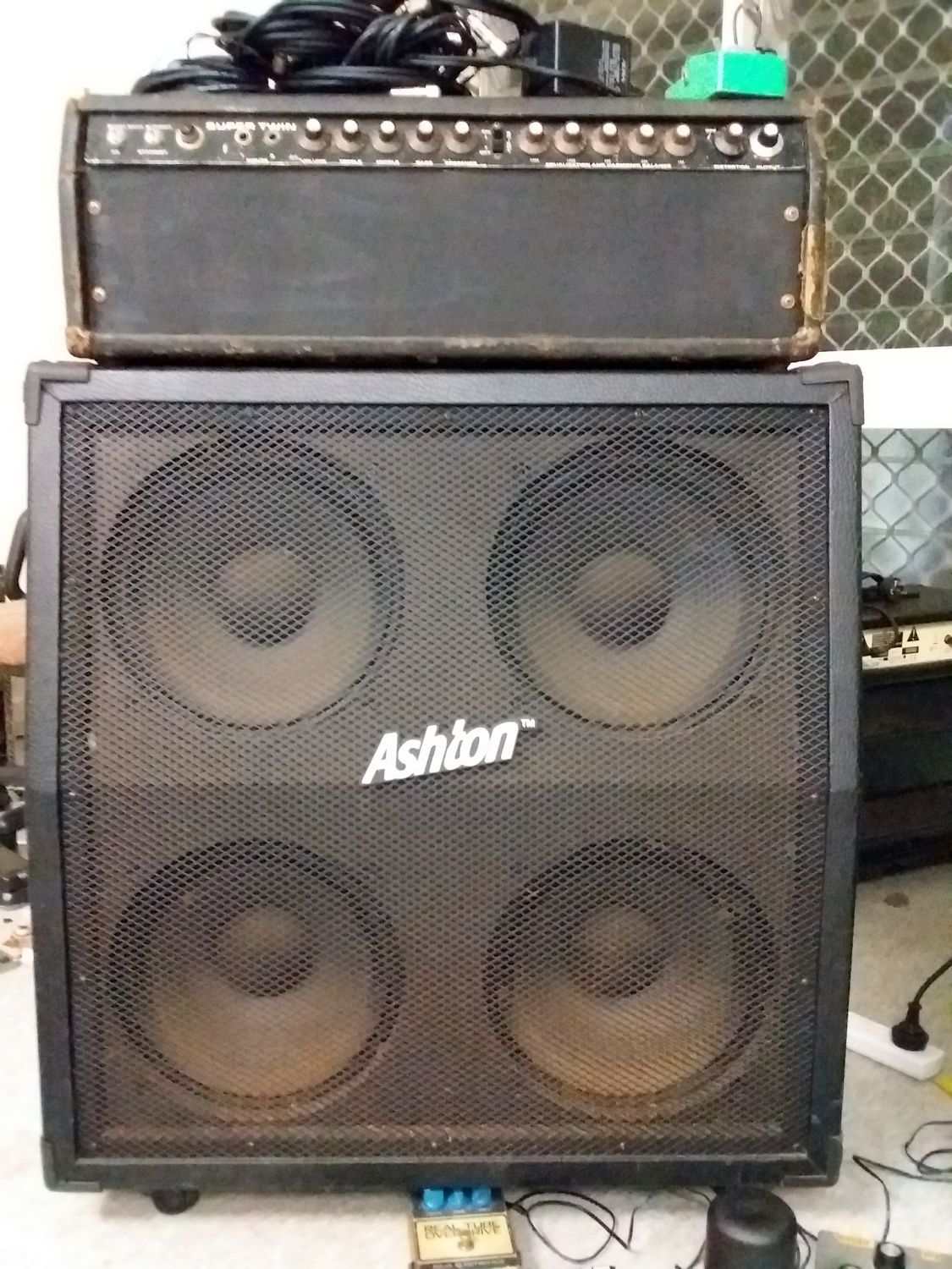

    Here's a pic of the Fender Super Twin amp, sitting on top of the Ashton quad box in my loungeroom, the amp has it's new front panel fitted to it's wooden cabinet:
Name:	Super Twin Stack_resized.jpg
    The front panel of the amp's wooden cabinet is just a piece of 12mm X 180mm X 627mm planking I bought from my local Bunnings store, I also bought a can of matt black spray paint and sprayed the piece of wood with it, seems to work pretty well, later on i'm going to cover the front panel with some nice Paisley cloth, should look cool once it's finished, the amp is pretty much useable as is though, but one thing I would like to do later on is re-tolex the wooden cab after stripping-off all the old tolex, and re-gluing the corners, I'm also going to fit new chrome corner protectors and etc to the cabinet.
