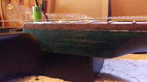

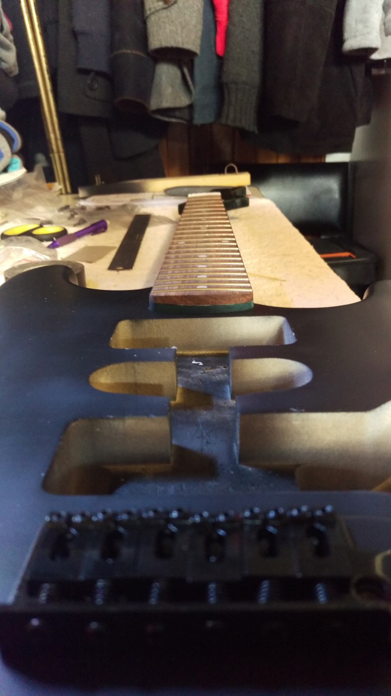

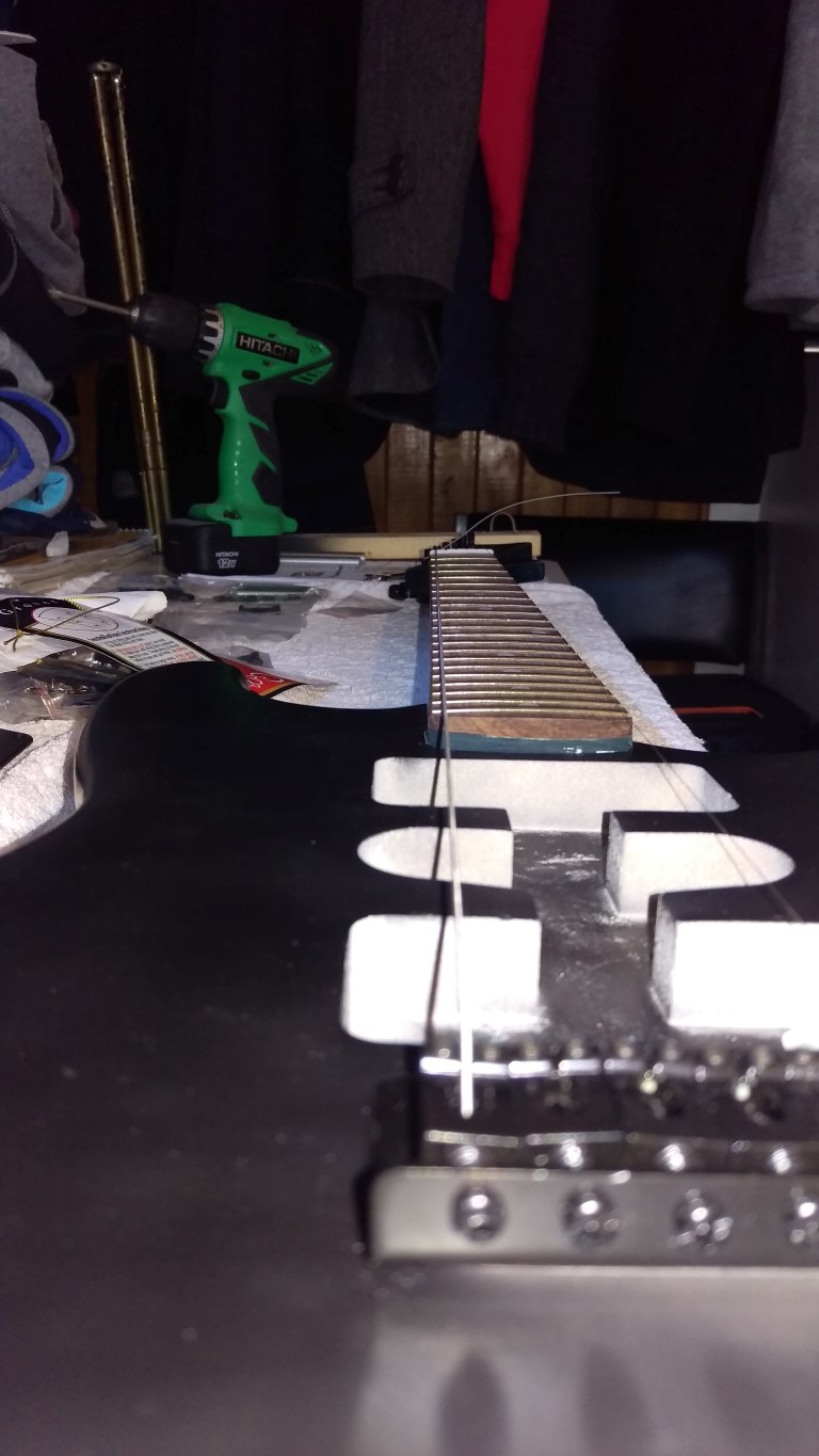

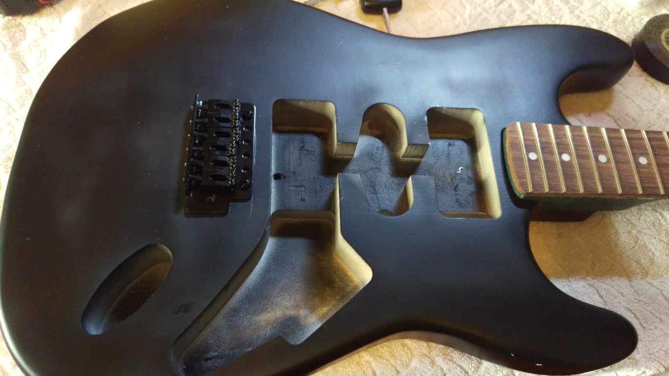

    Ok, neck is bolted on and its straight, i dont know how...lol fitted bridge saddle and screwed down with 2 screws after taking measurements from my mim strat, and fitted tuners. Strung up with the 2 E strings and checked fret clearance. At 21st fret was 3 ml off crown, should be able to lower with neck adjustment.

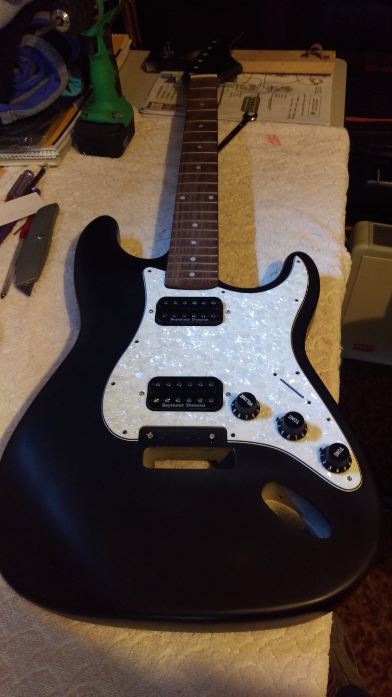

    Mock build in black looks choice !!

    Ok will do. I like the black very much.....mmmmmm i wonder.... maybe clear with a hint of blue flash in it...
    BTW... How does the neck look to you...i need a professional opinion plz mate.....
  6. #116
    neck looks ok Nitro from the photos but bit hard to see. As long as you can drop the saddles a bit to lower the action and the E string offsets are about equal or a tad more fret on the thick low E you should be fine mate !
